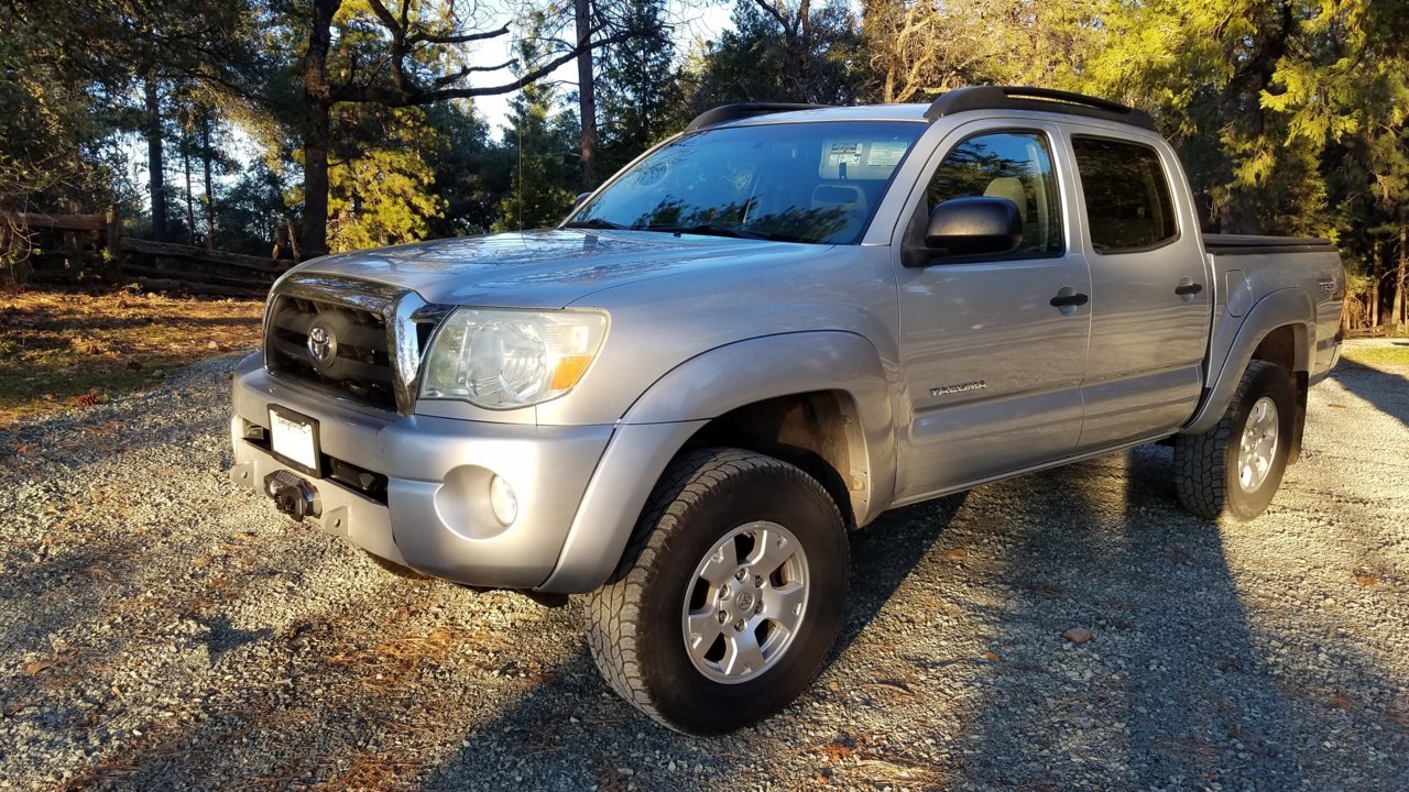

    Thanks for the reply crashngiggles. Yes, the 6112s are made for 2nd gens, and yes, I have a nearly stock DCSB. 3/8" to 1/2" in about 6 weeks? That's what I was looking for, and will be very happy if it ends up there.
    Yeah, the increase after adding the new rear shocks puzzle both my mechanic and me. Winch went on right after installing the 5160s. The new struts were installed a couple weeks after that. It could be that the winch cantilevered the rear up a bit, but the more I think about it, it's very likely that I wrote down the wrong numbers when I made the original measurement.

    I decided to add the unbalanced weight, like the winch and bumper, first so I could measure the effect on the truck's suspension. Then chose the settings to lift everything. Only thing to do now is possibly a little increase the rear lift, add rock sliders and increase the tire size to 265x75-16. This is about as far as I want to go with this upgrade.
    I went with a lighter winch setup. With 130sh lbs added to the front, my mechanic and others thought that the 650 lbs springs would stiffen the front up too much. They recommended staying with the 600 lbs springs unless adding a full steel bumper and winch.
    Regardless, you should be happy with the new setup.
    This is where I am now
