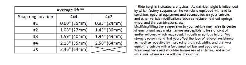

    Is this chart specific to 3rd gen tacomas only ?

    ‘15 trd sport 6MT dcsb, mostly stock?

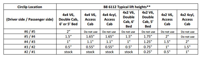

    That looks like 3rd gen....
    Here is the 2nd gen from Headstrong offroad.

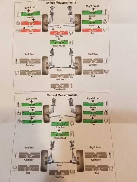

    13
    Here is my alignment on my 2013 4 door tacoma off road with the 6112 at setting #3 and 1.5" add a leaf in the rear without overloads. The installs went pretty smooth. I did it over the weekend by myself doing the front 1 day & the rear the next day. ( I wasn't in a rush ) The ride is a lot better over stock shocks. I used the stock UCA's that came on the truck.

    Bil 6112/5160's etc.
    Looking good! Mine were pretty similar:

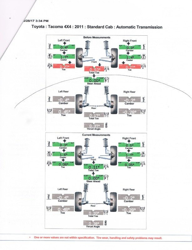

    2019 F150 FX4 S Crew 3.5 TT
    Yours looks real good. Mine is closer to Tacoma 2013's I'd like to see a little more caster but I assumed I couldn't get any better with stock UCA's? It drives okay nice and straight but a little more stability would be good but its fine. I'll ask next time. Thanks * BTW 3rd clip with 1/4" spacer dr side + aal's = about 2" lift all around

    I forgot to add i put a 1/4" spacer on the left side for the taco lean. Looks like we all got similar numbers on stock uca's
