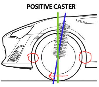

    1. I did not say clearance.....I said bigger tires need more caster so they won't rub. It pushes the angle of the tire further forward so it doesn't rub against the cab mount while turning. If you see in this picture below.....the front gap is smaller than the rear gap because of the positive caster.
    2. I did not say that the lift will wear out your BJ's quicker, I said that the BJ on the OEM UCA is not made to handle the pounding of consistent offroad or the aggressive angles of articulation which can (not will)cause them to prematurely fail. I have a couple of buddies up here that have stock UCAS on their truck with their lift. As I said in a previous post....it is not 100% necessary but recommended.
    3. Yes, you are correct that the larger and heavier the tire, the more stress it will put on the BJ.
    4. Once again, my reasoning for my answer was situational. 90% of the time, when a person puts a lift on their truck, they inevitably get larger and heavier tires (which like you pointed out puts more stress on the BJ). This then leads them to be more daring to take their vehicle off road more then they would have without the lift and tires which where I pointed out puts more stress on the BJ's because it is not usual road driving.
