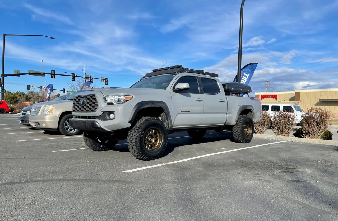

    Ive had suspension sitting in the garage since thanksgiving. I bought wheels on valentines day and finally got the truck put together on Saturday.
