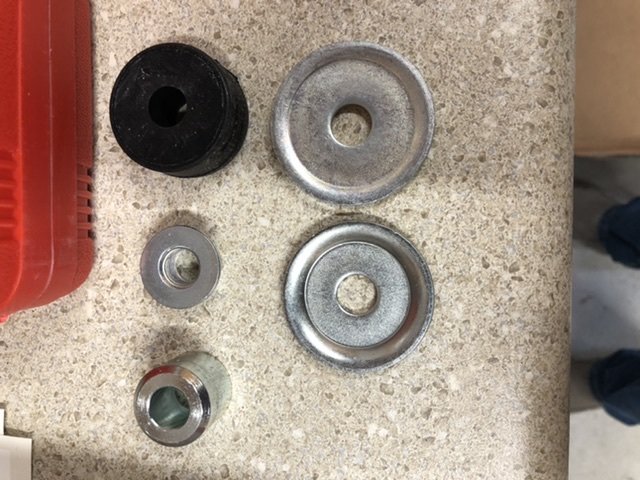

    Does anyone know of these two washers is the top washer and which is the bottom? One on the left is slightly smaller and more cupped. Ridiculous that the directions are so poor.

    The other question, since the lock nut at the top has a torque value, is this torqued with the spring compressed or no?

    The top nut torque value doesn’t matter. Just tighten it until the shaft starts to spin. Cupped side towards bushing and larger one on top.
