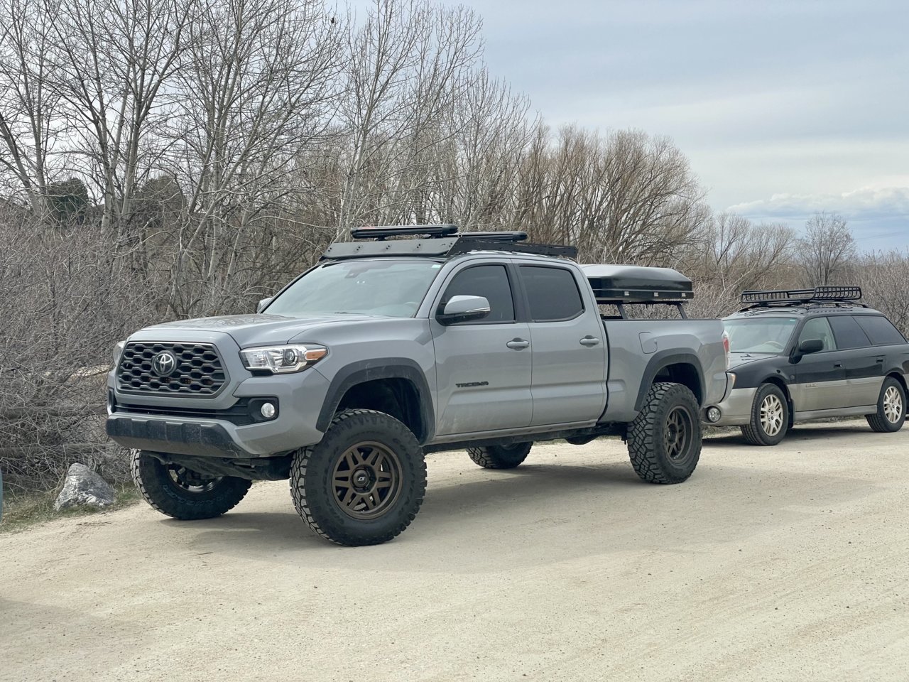

    Yes, thats been the challenging part lol. Need to find a snowy/dirt road with some room to get the truck moving. Drives perfect from 0-25mph, then from 40+
    My carrier drop will be here today so I'll toss it in tonight and report back. If thats not it, ill order up a bushing and probably toss it in this weekend and report back again

    so if the noise goes away in 4wd would you put a diff drop in? or put a diff bushing in?

    Diff bushing. Diff drops don’t do anything other than make the mounting the frame weaker.

    It is in fact the needle bearing folks. bummer.

    If anyone cares, it was in fact the needle bearing that caused the vibration. Swapped it for the ECGS bushing this morning and got it up to speed and the noise is gone!

    Is it required? No. Will you have any issues? 50/50. Just do it while you're in there and the truck is apart. It will save you time and money in the long run. It's a $60 part.
    I regret not doing it when I lifted it. My truck went back in the shop 10 days after the lift install for the bushing swap.
    The biggest bit of noise is that I got an ear full from my GF about how I ruined a perfectly good, brand new truck cause of this bearing vibration.
