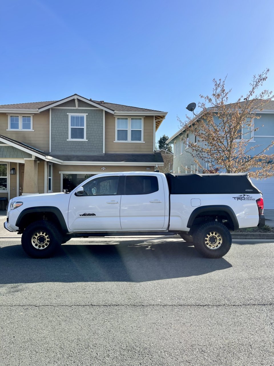

    6112’s #650 6/5 setting / ICON RXT option #2 / shim. full steel skids , sliders . Great set up very happy with everyday driving and when loaded no sag :thumbsup: Love the rake it’s a truck

    Hard to see the 6112s in this pic.
    Guess I'm not much of a photographer or could it be the 37 inch tires :headbang:

    How much rack do you have?
    Looks great.
    Just measure mine yesterday.
    From top of tire to bottom of inner fender, full tank empty truck I'm
    5" front
    6.75" rear
