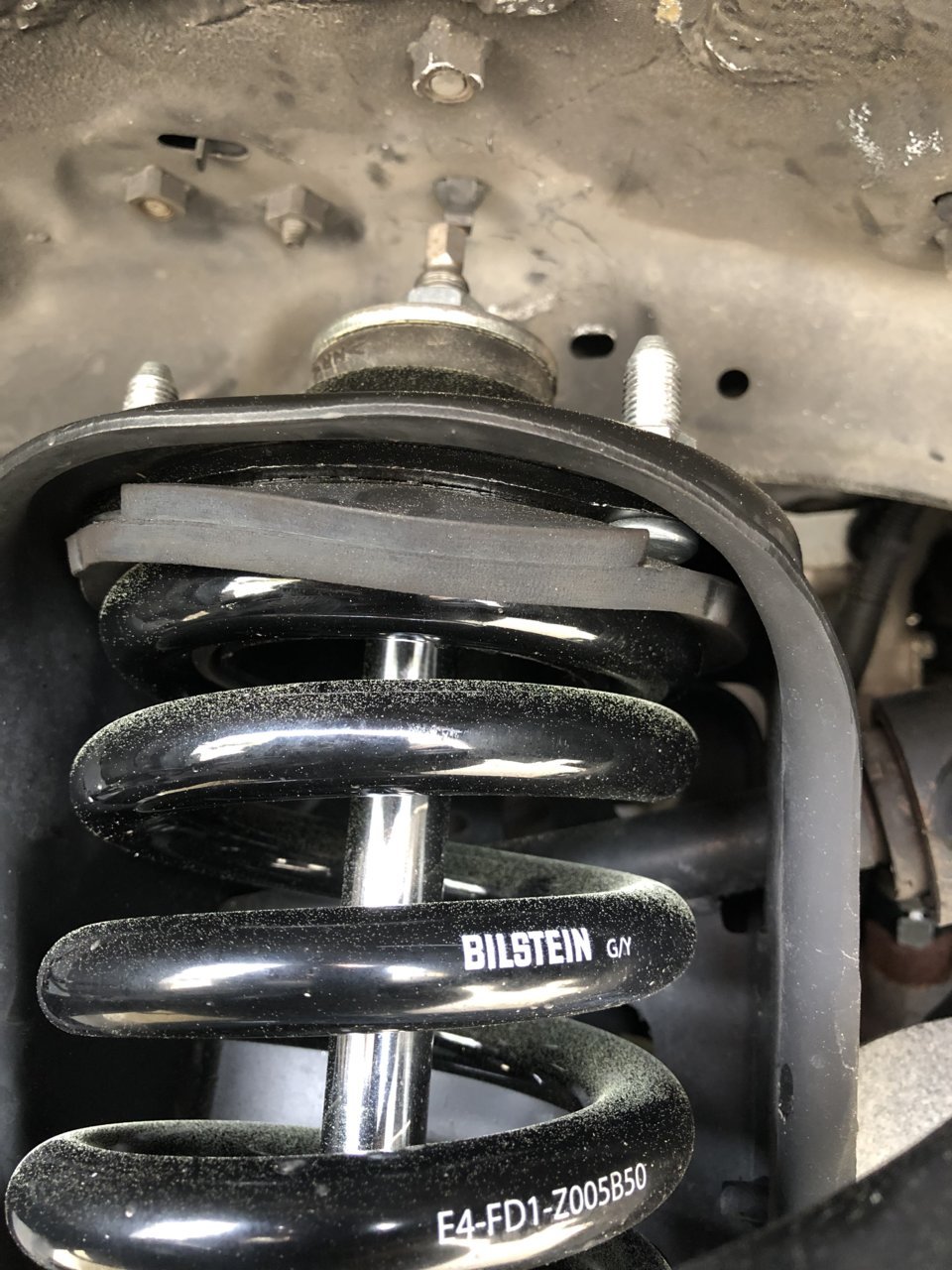

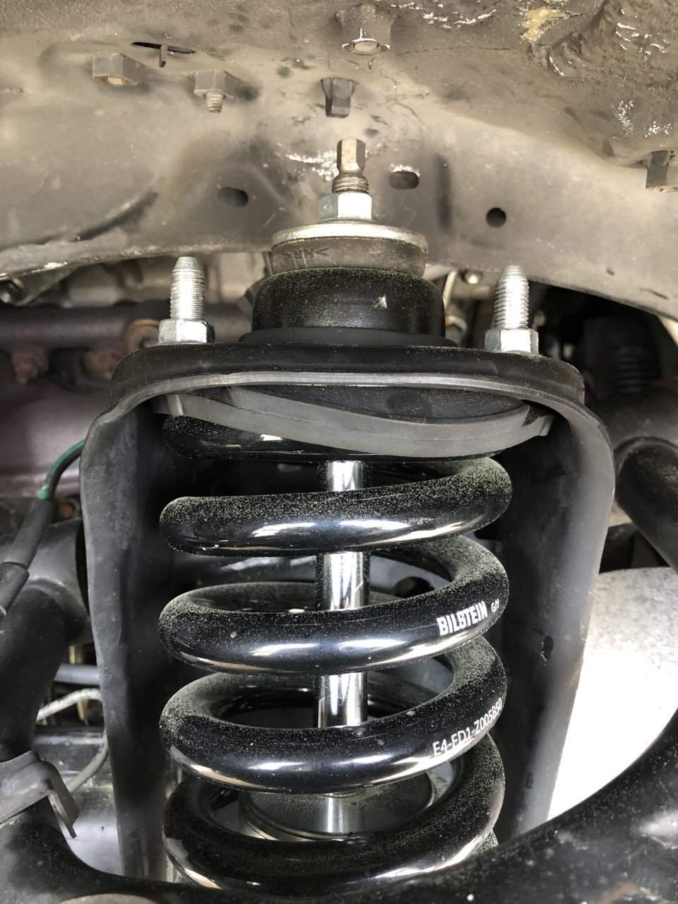

    So I measured this morning, and all the corners are within .5” left to right. Matter of fact it’s the rear that’s slightly uneven, front is dead on. I wonder if trailering the boat yesterday (2 hour round trip) caused the suspension to settle.
    However I noticed that the gasket between the coil and top hat on the driver’s side is suddenly coming out quite significantly from under the top hat. The other side doesn’t look anything like this at all. Any thoughts on whether I may need to address this?
    7E95720C-961A-4BB0-9ECA-0FAC4B710D05.jpg 7C74D66F-9918-4E72-A80D-CB609FEA5BDA.jpg
