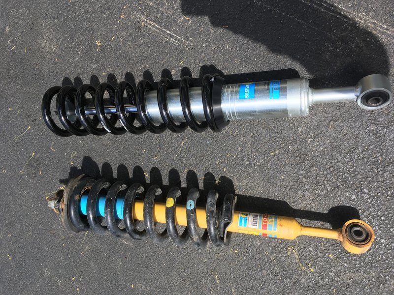

    Install going in this weekend. Been back and forth on the front clip location with Dakars in the rear. I think I'm going with the clip 3 location first and see how it measures out

    Are you keeping the leaf pack together?

    Semi Stockish
    yeah i'm leaving the pack fully assembled

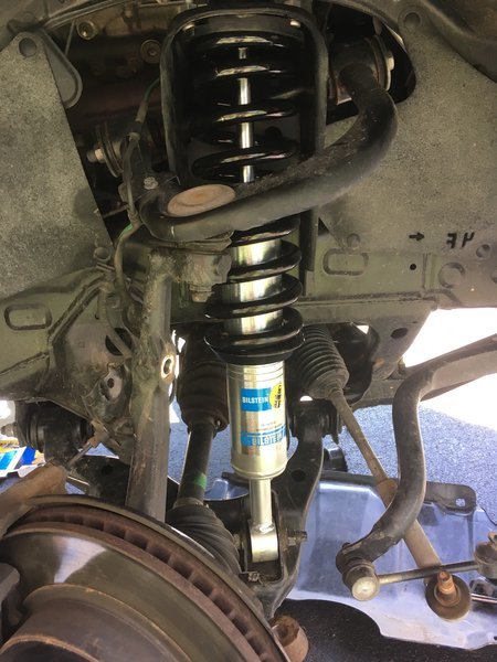

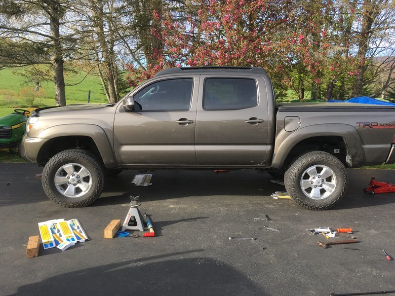

    Install and alignment went well. So far extremely impressed with how it rides.
    Ended up at the 4th notch with the Dakars in the rear and sitting with a nice rake

    Just a little more beefy than the stockers...LOL
    I hope with my 650# springs (set on 4th notch) I don't get much higher than that without my bumper, winch and skids.

    Lol yeah just a hair beefer and it actually rides a hell of lot better. I think you should be alright with the 650 springs. If you can find longer ones to be better off since you won't have to preload so much
