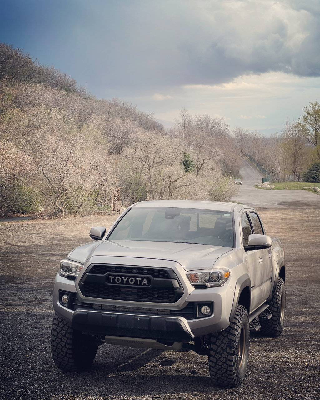

    2019 Silver Tacoma TRD Off-road
    5/4 setting with 1/2” spacer on both sides. I netted 3 inches of lift up front (measured from hub to fender). SPC UCAs. The ride is great. Standard 600 lb springs. 285/75R16 BFG KM3. SCS F5 Wheels 16X 8 with 0 offset.

    xKryToN
    xKryToN Well-Known Member
    Mar 26, 2021
    #360624
    65
    2019 TRD OFF ROAD
    Bilstein 6112/5160 ICON 1.6 AAL Tacoma TRD Pro Wheels 285 75 16 KO2
    looking really good
    CSA[QUOTED] likes this.
