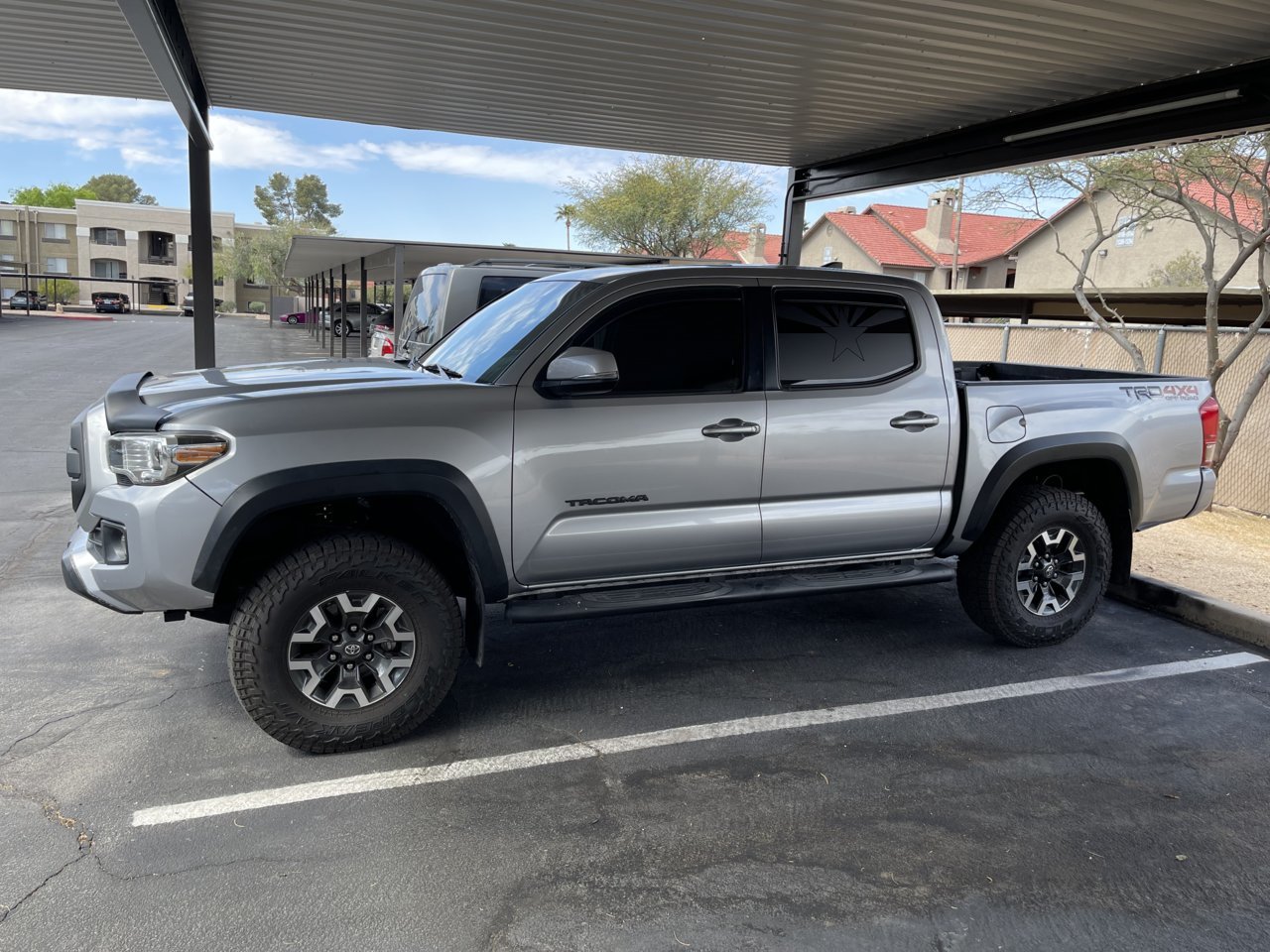

    Alright guys so I’m curious if anyone is set up similar.
    A couple weeks ago I installed 6112’s (Bilstein stock 600lb coils) on 5/4 perch and rear 5160’s without any blocks or leaf springs.
    From center hub to fender I’m at 22 inches all around,
    With the 5/4 setting I’m supposed to gain 1.5 inches but I only gained one. Does that seem right to anyone?
    ODSC1 and 71tattooguy like this.

    What was your before measurements? Before my lift I measured a few Rigs at the dealer. Have a buddy that works there. A lot of them measured under 21 hub to fender and 34 7/8” ground to fender. A lot of members say 21” every truck will be different IMO.

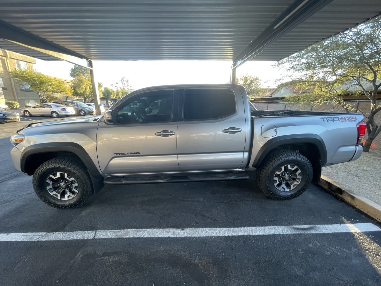

    Unfortunately I forgot to measure it before smh but did notice a lot say 21” I guess I just don’t notice a difference from before lol even though I know it’s supposed to only be 1.5 inches of difference. Here was before with just new tires a week after I got her

    IMO I think your good.

    Thanks! I am gonna lift it more eventually I guess I'm just over thinking that half inch lol

    I did the same thing.Don’t sweat it. Let the 6112’s do there thing stick to there specs.

    I like the way it looks man! Nice job, I think it’s noticeable from my perspective
