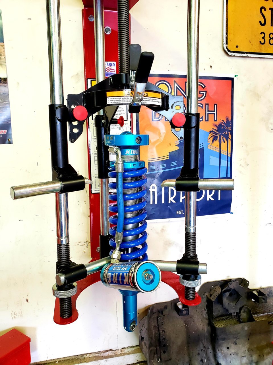

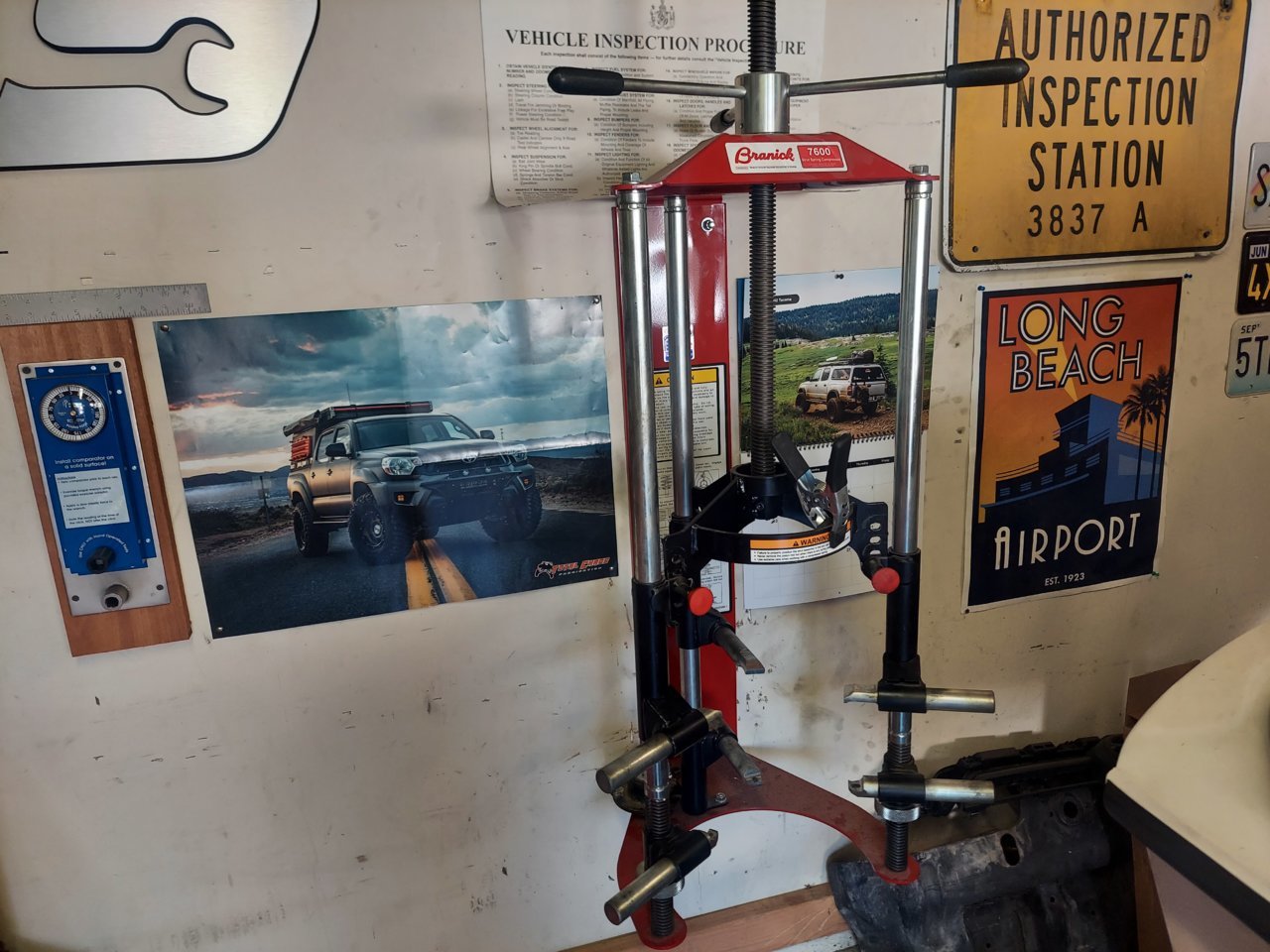

    $250 is steep. I'm in the Long Beach area. I own a wall mounted spring compressor. If you bring the shocks off the truck, can adjust them for $60 /pair.

    What wall mounted compressor do you use?

    LOL! Same one I got!
