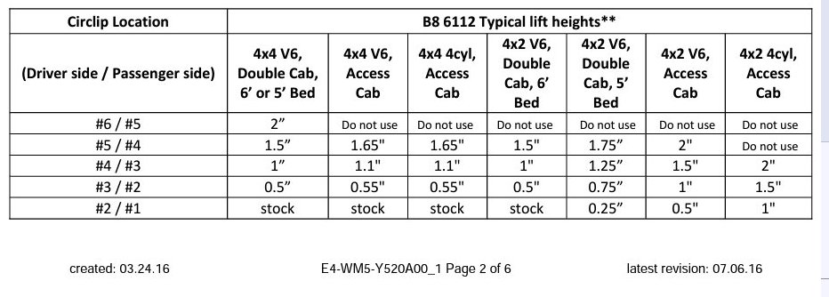

    hey guys, I got my 6112/5160/med. dakar/JBA UCAs installed october 2018. Lately I've been driving way more, and looking to bring things down a bit for a more stockish/mild setup for better mpg and daily driver comfort. Also will be downsizing my tires (currently on 33's). I'm planning on returning the UCAs and leafs to stock (and selling the JBAs and Dakars). If I want to get the same lift as a trd pro (pre- '22 since the 22's are lifted a half inch more).... what notch settings would the 6112s be at? I'm Currently at 6/5 and I'm not sure which "gen" I have. I think it was the newer one when I bought them in 2018.
    That brings me to my next question. This suspension has about 60-70k road/highway miles (no offroad, really) and the truck has been a "dad mobile" and somewhat babied. I would assume they are definitely settled by now. So would this change the notch settings I choose? And is it worth it to even do this instead of getting new suspension? I'm looking to save a little money instead of buying all new shocks and I'm just not sure what kind of mileage people are getting for these things and what lifespan I have. Any help greatly appreciated!

    I'm sure they are settled. Your setting today give you 2". I think it would help others help if you posted your measurements on all 4 wheel from hub to bottom of fender flare.
    Below are the notch settings and different heights. Sounds like 4/3, or 3/2 is what you are more looking for. I think the bigger challenge you have is what is your current rake with the dakar leafs and what do you want when those are removed AND you adjust the notch settings.
    Curious are you getting ready to sell and want it more stock, or is it all about daily driver efficiency? What sort of MPG are you getting now? How much do your 33's weigh? Those are probably the biggest culprit to your MPGs but I could be wrong. Why not take those off first and go back to stock size and see what the result is. Baby steps before making 4 or 5 changes at once?

    thanks, so to answer your questions... I want it better for DD and also plan to sell in a year or 2... OR run it into the ground. Depends on the market. Regarding rake, Isn't the trd pro (pre-2022) rake the same if I put back on my stock leafs and had 1" upfront? If so, I'd be good with that considering toyota is. I can take those measurements today.

    My understanding is stock has a 1" rake. 1" up front would make you level (assuming no weight beyond stock).

    Question on predicting how much lift you will got on the 6112 with the 600# springs they come with. I have some added weight about 450 pounds all around (rock sliders, Prinsu rack, ARE Shell).
    Took measurements from stock suspension front:
    1. I've lost ~0.25" to 0.5" in front from the stock 21" hub to fender flare (currently at 20.75" on passenger, 20.5" on driver)
    If I set the 6112s at the 6/5 perch for 2", would I expect to be at 22.5" on passenger since it is perch 5 and 22.5" on driver since it is perch 6? Net from stock would be 1.5" because of the added weight?
    Alternatively, if I went down one notch and used the 650# springs, would I expect to net the same?

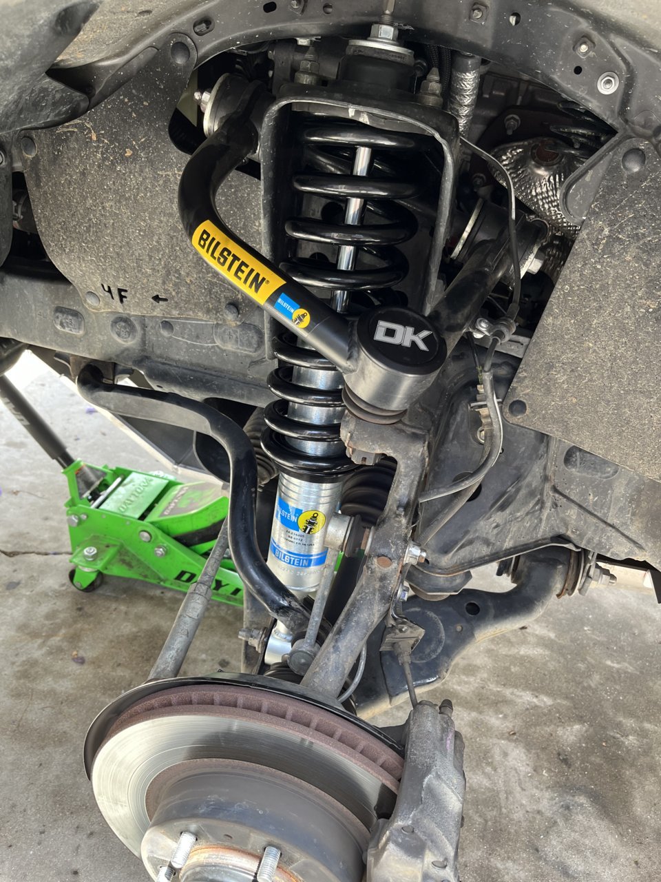

    HotShot Offroad everything is here except the 6112s getting delivered today and the UCAs which we discussed. Can't wait the rear end on my Tacoma sags more than my rear end! I was going to hold off on getting the 32" tires until the fall but I think I'm going straight from the suspension upgrade to new the 32s installed and get the alignment done on the same day.
