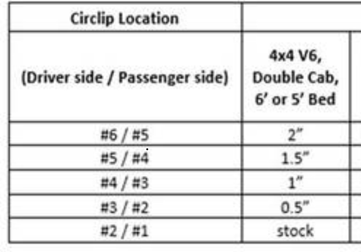

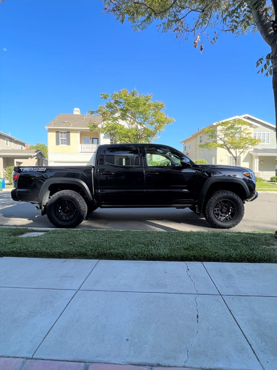

    I got mine installed today. I asked for level and came out with this. Truth be told I came into the shop on an empty tank and got home with a full tank. They put me on 6/5 (older version). Im 23" center hub to fender up front and 22" hub to fender in back.
    Should I go with 5/4 or 4/3 to level it out? Ugh, this looks funny to me. = (

    how come people stagger the clips? Are they using charts from aftermarket companies?
    I have a 2nd gen and used the most recent instructions directly from Bilsteins website and it didn’t say to stagger them

    The 2nd Gen instructions do not recommend a stagger, the 3rd Gen instructions do.

    If your running the 265's 4/3 for sure.

    If you are at 23” on 6/5 and you want it level then go down 2 clips to 4/3 to lower it 1”

    You can double check by measuring ground to fender front and rear. If they are different by the same amount as your hub to fender measurements then you have your answer. IIRC stock measurements hub to fender are 22” rear and 21” front.

    Thank you so very much. My rear is 22" and my fronts are 23". I want it 22/22. So your advice at 4/3 is spot on. Thank you!!! I wish I could easily do this at home. Sucks not having spinner adjustments.

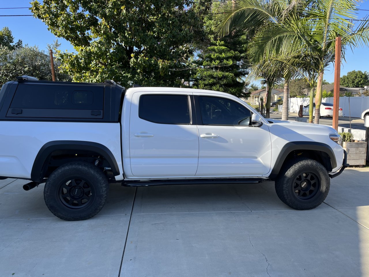

    I am at 5/4 in for me it's perfect. I have considered removing the sway bar but for pavement I'm not sure that's a good idea. I did relocate it though to allow clearance from the UCA to the shock body. I do recommend that.

    Here's a pic but it's on an incline in my driveway so the front end is lower than it actually is on level. I do have a slight rake due to the fact that I tow a small trailer. Hope that helps. If you need another and I'm out and about I can get you a flat ground one.
    I an running Deaver 402 w/. 5160 in the rear.
