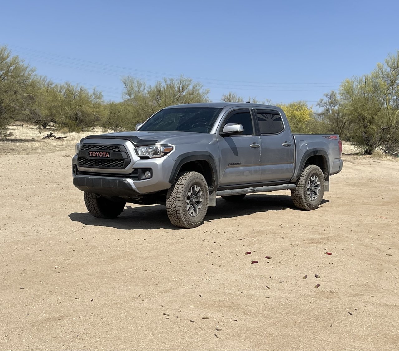

    Oh, missed that he is on stage 1, but I would expect he is still getting more than 1" of lift. In any case if @bigworm is looking to lower the front by 1" he needs to drop down 2 clips to 4/3

    It would seem that I got exactly a 2" lift from mine. And a few members here have said the blistein clip numbers are pretty accurate. So if we are in fact 20.5ish stock, then yes yours appears to be accurate too.
    Is your front end look a smig higher than the rear? At first I thought yours looked dead on level. But the more I look at that pic, the more I seem to think you might be taller up front. Its so hard to tell in pictures.

    It's leveled. I haven't remeasured since I've had them but should still be 22inches all around IF anything would be lower front. Here's another pic that's more recent

    Thank you very much! That looks level to me! That settles it. I will try 5/4 then. THANK YOU!

    Thats the part that is throwing me off. For me to be 22" all around, I need to drop 1". So it would be 4/3. But @AzChino520 truck looks level to me with the same suspension at 5/4

    Most people struggle with what to do BEFORE you install them because you aren't 100% of what the end result will be. Assuming you trust your measurements, you already know. You are 1" higher in front. Go 2 notches lower for 0.5" per notch for a total of 1".
    Stock factory is 1" of rake. So getting 1" in front makes total sense. You got 2", now you need to lower it 1". Your shop should have done 4/3 from the start.
