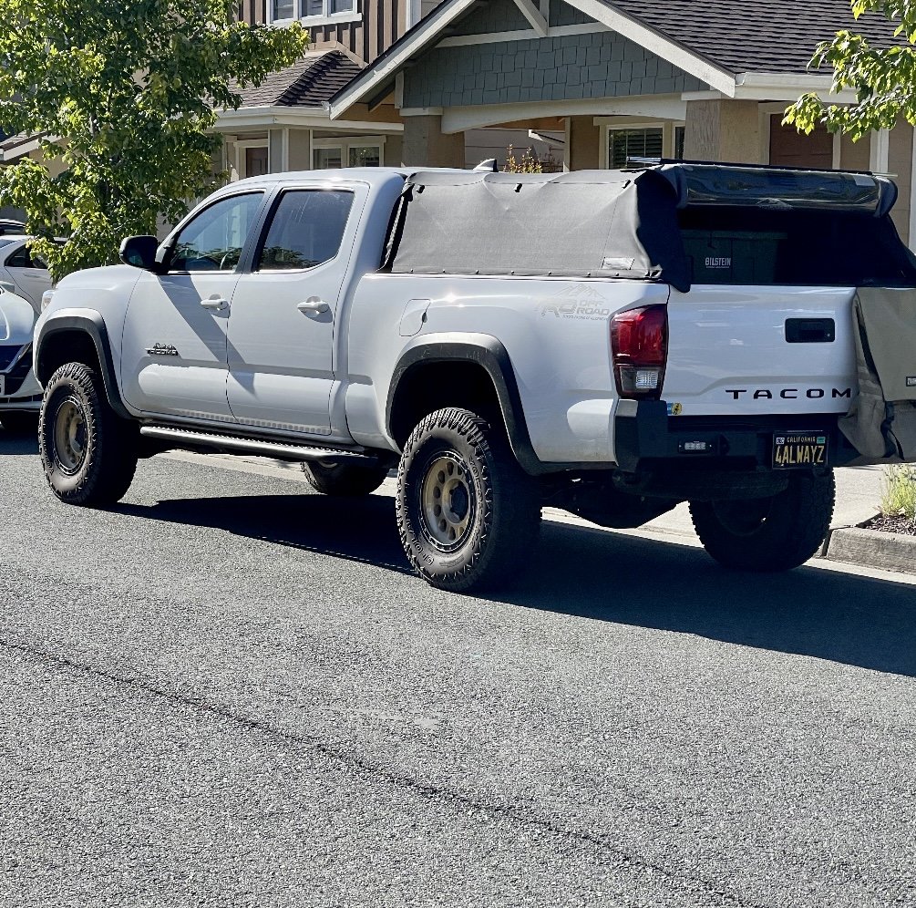

    #650 lb coils 6/5 setting with ICON Rxt option #2 fully loaded with camp gear. Still have rake about 3/4” -1”. Unloaded have close to 2” of rake. Trucks should have rake never understood the level look

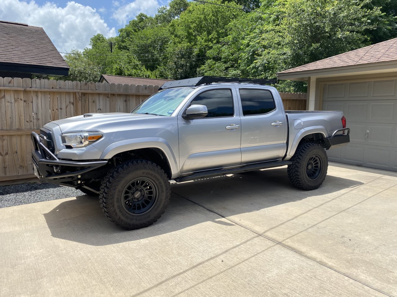

    6/5 setting (650lb springs), 5160 in the back, Dakar medium leafs, steel front and rear bumpers, Smittybilt synthetic x20, 295/70/17 Yoko MT

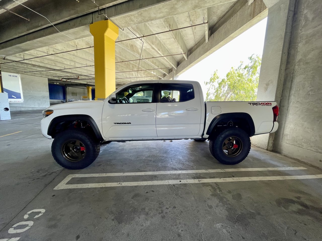

    just finished mine
    6112/5160
    6/5 clip and 1” block

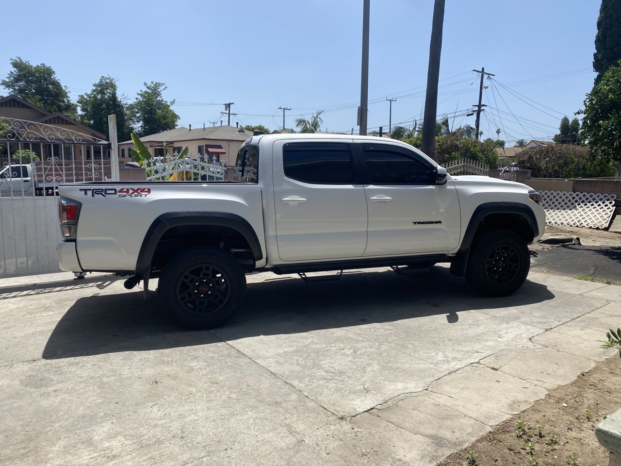

    I just installed mine straight from the box they are the 3" but I think the front might be too lifted in my opinion can I go from the 5th notch to the 4th? Attached is the picture of how it sits right now. The rear has a 2 inch block.

    What’s your hub to fender measurement?They will settle. Give a better pic also

    Thank you for the replay I'm new with Tacoma's been building mustang all my life recently decided to switch it up. As for the hub to fender its 24 3/4. I installed them yesterday would it be a good idea to wait for the alignment?

    A few questions what coils you have in front. I’m sure 600lb coils. They will settle a bit. My hub to fender 23.5” 650 coils but I have full steel skids , steel sliders. Yes you should get it aligned IMO. What tire size 265/75/16 or stock?
