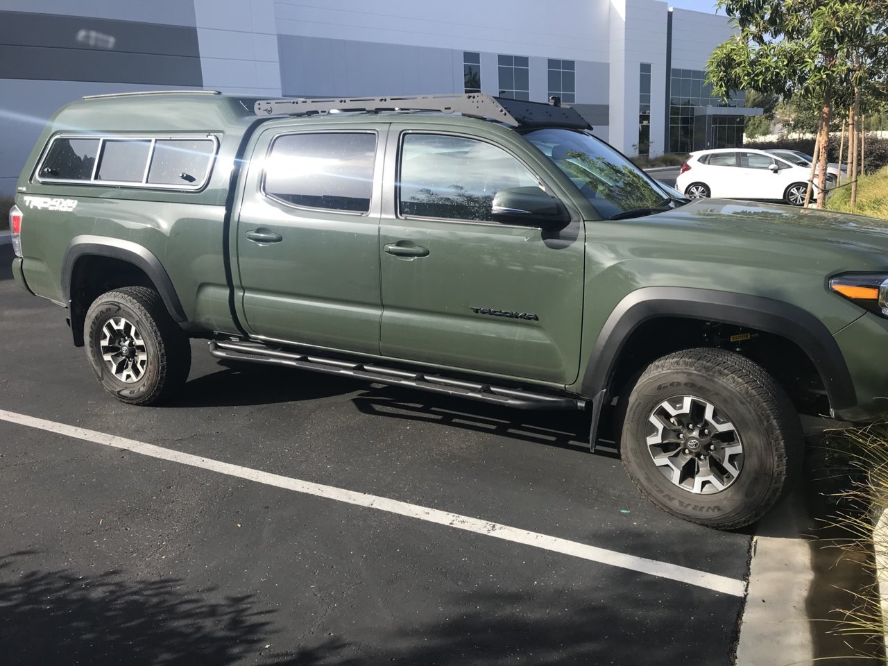

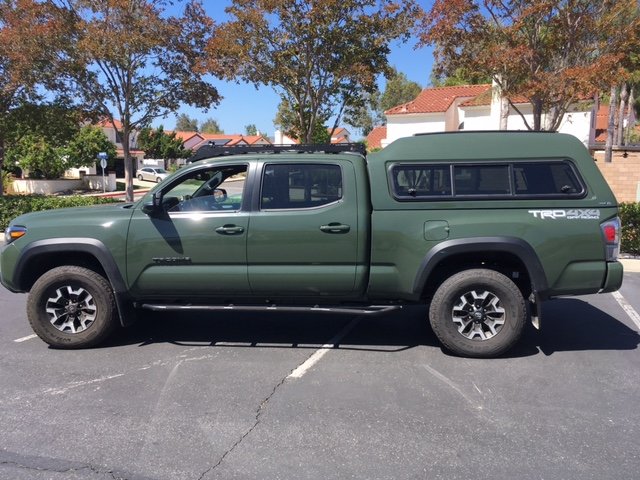

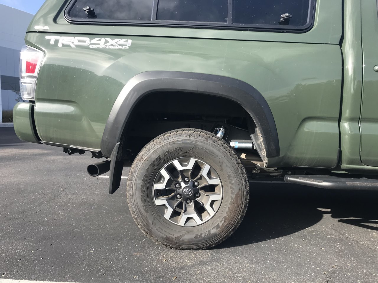

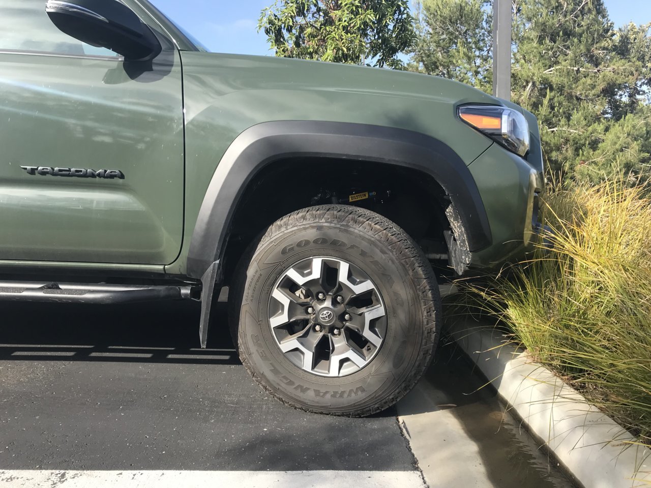

    I had mine installed yesterday with the new 11 clip settings. Sort of bizarre results but I am going to let everything settle before I make any adjustments. Details below.
    • TRD Offroad DLCB 4x4
    • Added Weight in rear = ARE Shell, Bed Mat, Bed Stiffeners
    • Added other weight: Prinsu Cab rack, Steel sliders
    • 6112 on 10/8 (1.7") circlips settings with 600# springs
    • RXT Option 2 leaf pack on rear with 5160s
    Center hub to wheel well measurements:
    • Front Before = 20.5 on driver, 20.75 on passenger
    • Front After = 22" on both sides
    • Rear Before = 21"
    • Rear After = 24”
    • Rake Before = 0.5"
    • Rake after = 2"
    Net change from stock:
    • Front +1" (was expecting ~1.5" to 1.7")
    • Rear +2" (was expecting ~1.75")
    • rake +1"
    Net change from pre-install:
    • Front 1.5"
    • Rear 3"
    • Rake +2.5"
    I am a bit stupified. Got more then expected on rear, got less on front. Pics below. I had half a mind to pull the 6112s and go to 650# spring or up to 11/9 setting but have decided to let everything settle for 6-12 months and see where it lands, then re-evaluate.
    If anyone has any ideas why I netted only 1" from stock on front, please chime in. I have some added weight but not that much. I called B on phone beforehand and they recommended the 600# springs and that is where me and my mechanic both landed as well. My added weight shouldn't translate to losing 0.7" from what is advertised. I feel like I am missing something. Measuring wrong but how hard is it? Center of hub to wheel well. I even have older "ground to wheel well" measurements from stock and my net changes come out the same.
    Despite the odd results, I shall remeasure next week when I load up for a camping trip. And the thing rides like it is on air cushions.
    PS - I am getting 265/75/16 tires on Friday to fill the wheel wells out a little bit more and add another 0.5" of clearance all around. Did not want to go bigger due to weight concerns.

    Thanks! Aren't the front end results odd though? You lost 0.5" with steel skids and steel rock sliders. I lost 0.7" with aluminum skids and steel sliders. Get tires Friday, Alignment Tuesday. Considering asking my mechanic to put in the 650# springs ore alignment.
    Another part of me says, what difference is 0.5" up front with skid plates and the type of trails I intend to do. The rear has more clearance.

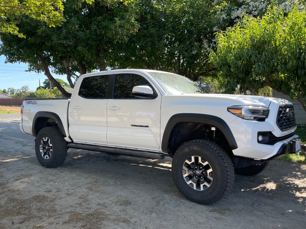

  12. Jun 14, 2022 at 11:16 AM
    #5832
    Octane209
    Octane209 Active Member
    May 24, 2022
    #397889
    28
    Octavio
    2020 White Toyota Tacoma TRD Off Road

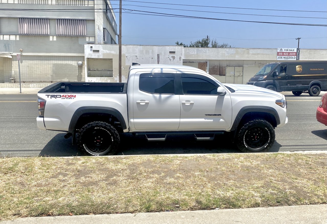

    So this is how it looks now what do you guys think? the front is a bit higher but to much work to take it all apart plus its my daily driver.
    DarthPow, CPS-65, Bikinaz and 3 others like this.
  13. Jun 14, 2022 at 11:52 AM
    #5833
    33yrsoftoys
    33yrsoftoys Over 40yrs now
    Dec 31, 2013
    #119566
    856
    joel
    mid Michigan
    2021 dcsb off road 6 speed manual
    Bilstein 6112's 5th clip 1/4" spacer driver's side. Icon tubular UCA's with Delta joint, wheelers superbumps, ECGS bushing. Allpro standard leaf packs, 5160's, U bolt flip kit with wheelers super bump's, extended stainless steel brake lines, carrier bearing drop. Icon rebounds 17" with Nitto terra grappler G2's 285/70/17's.
    Looks good. Check your CV boots to make sure the rubber fins aren't rubbing against each other. If they are you'll see a shiny line on the fins. Especially the driver's side inner boot. Mine did and I don't think I was quite that high.

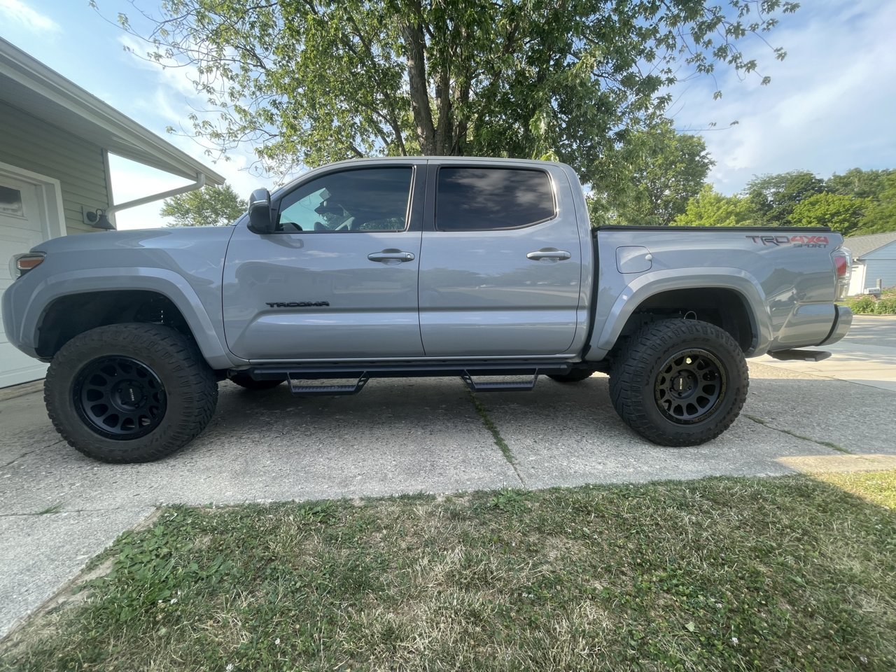

    4A4C1C81-E2B2-4D01-BC40-E093134B0ECA.jpg 9A9F6E4B-81DE-4A33-A445-09A91C659C76.jpg 3938F3FD-87E6-4DB2-826B-89B715994DC5.jpg AC70AF2A-DA6A-4A16-912B-53839BC822DA.jpg
    Here’s some better pics
    I’m loving the new look :D

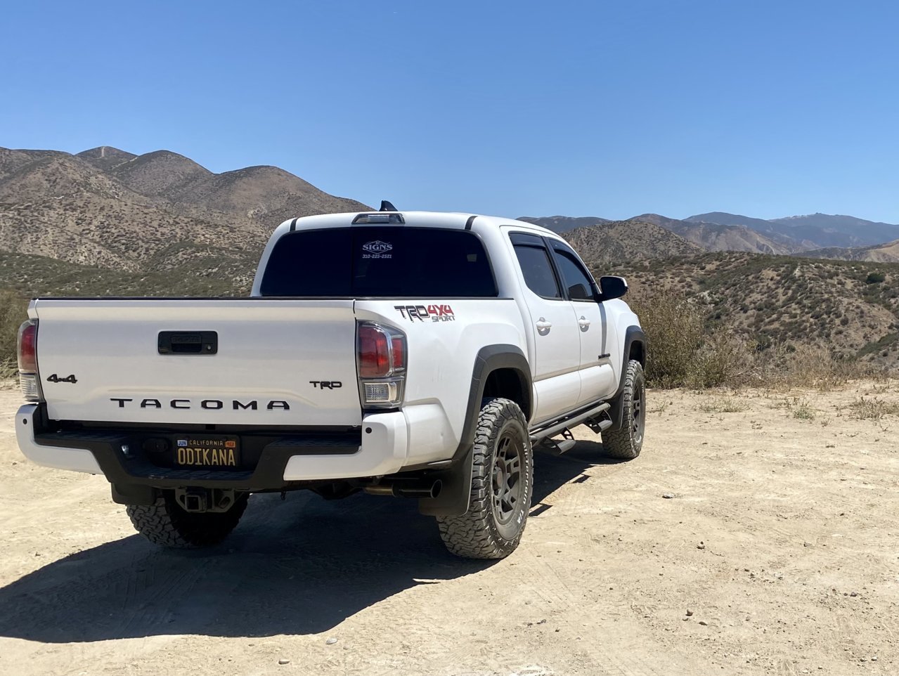

    Finally did the 6112s on 5/6, JBA UCAs, and 5160s with RXTs on option 2. Don't know why I waited 10 months.
