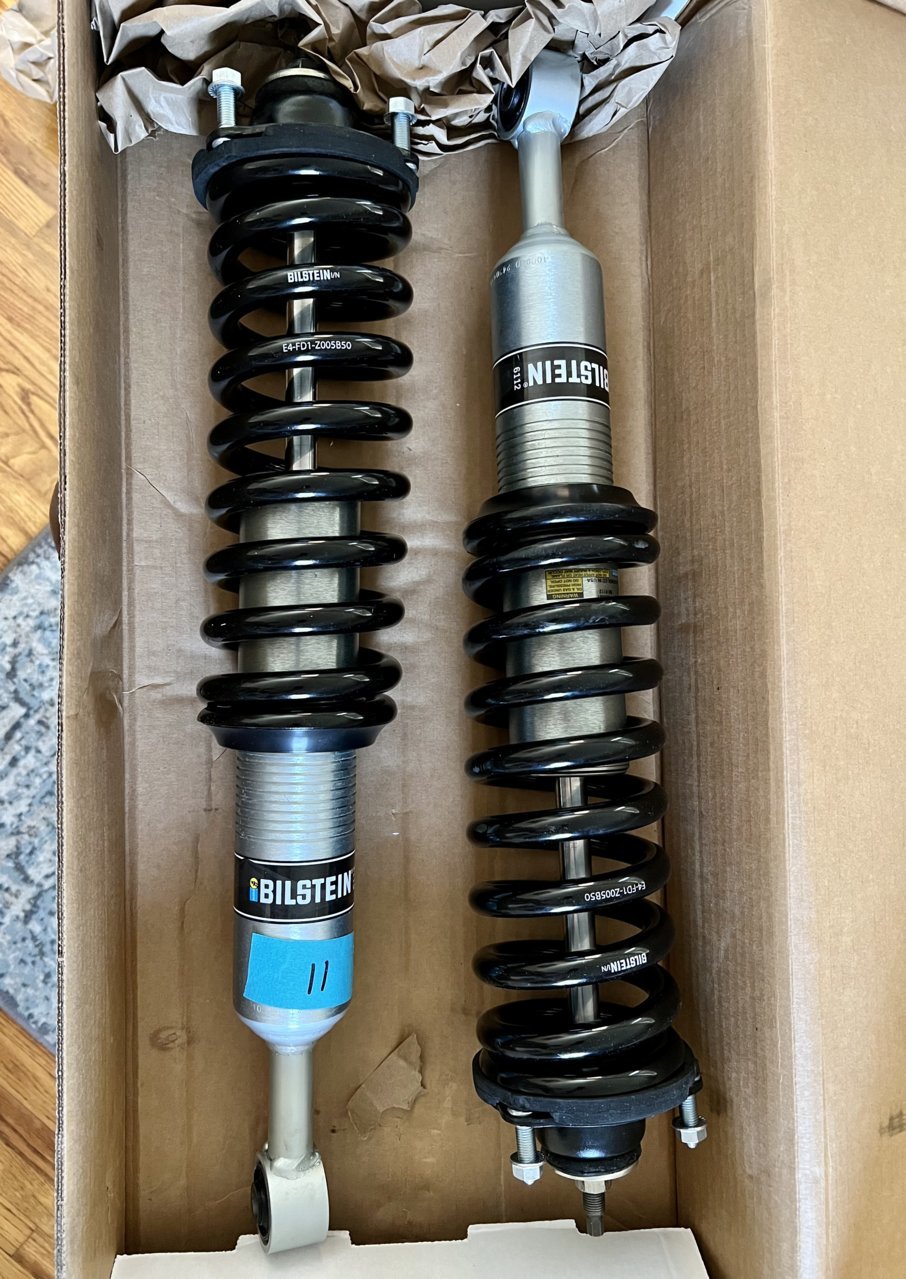

    just checked the site, and couldn't find the ones that had 11 positions... maybe I just missed it... anyone have a link?

    I need to fix our listings, but if you were to order these you would get the 11-position boys that we have in stock!
    https://hotshotoffroad.com/collecti...s/bilstein-6112-coil-strut-combo-16-22-tacoma
    The thing that's annoying is that Bilstein hasn't formally stated that they will stop making the 6-position ones so it's hard to "remove" the listing.

    Thanks for the link. I assume they're compatible with 05-15 as well? or no?
    any input as to why the 11 position is better? is literally a "this one goes to 11!!" thing, or is there some other benefit to those extra rings? Seems like if they lifted it more than the #6 on the previous models, it would cause issues?

    It's not better. It's just essentially a re-imagining of the same product. Notch 11 on the new shocks is no higher than notch 6 on the old ones. Think of it this way... There is now a notch in between every notch on the 6 version. I'll assume they did this to open up more granular adjustability and to additionally allow them to produce/sell/use the same shock for more applications.

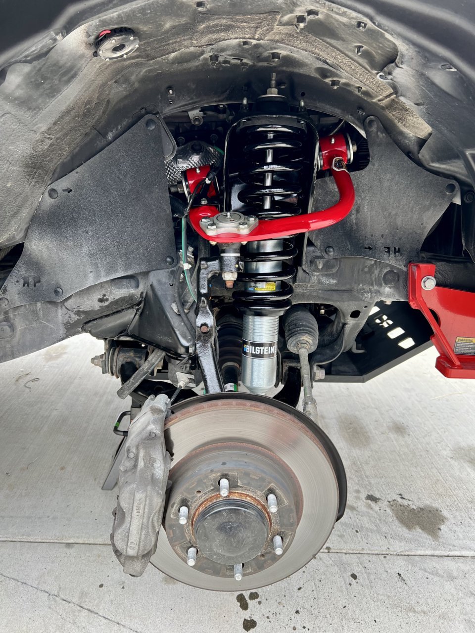

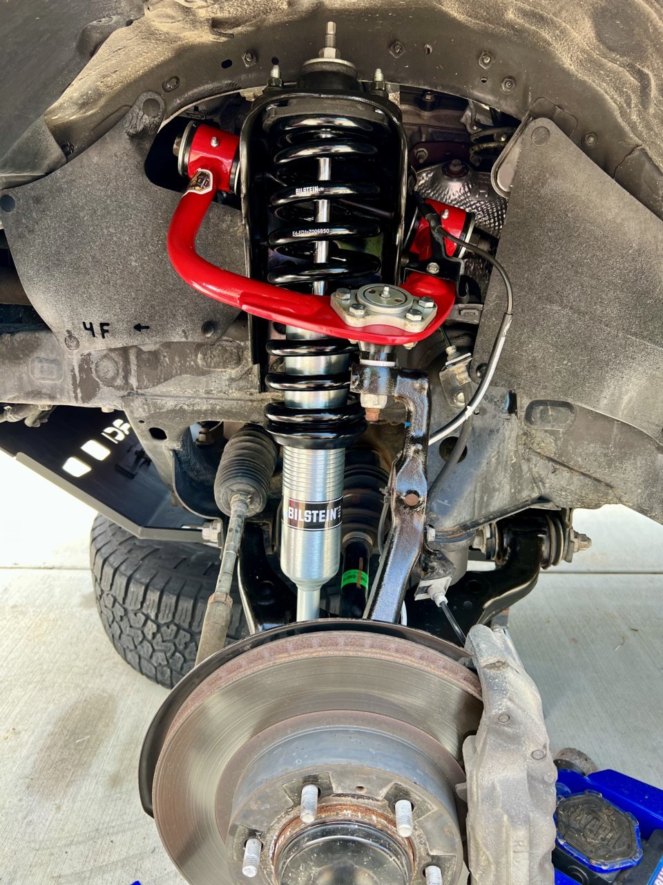

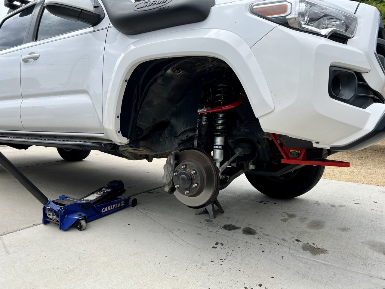

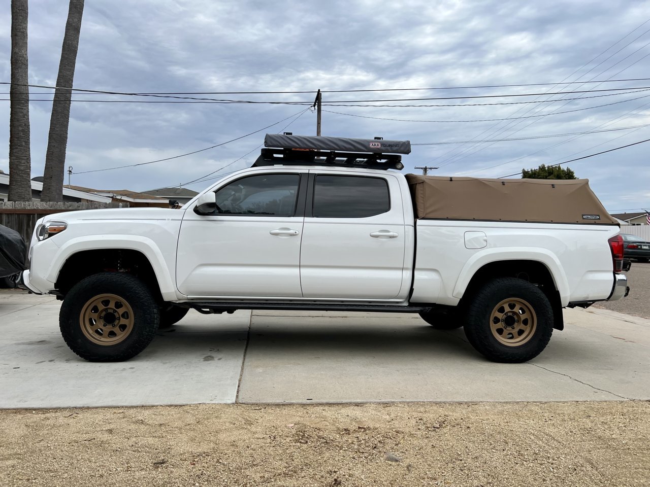

    Well, tequila and tacos won last night so knocked out the front today. Took about an hour and a half with cleaning and “hydrating” along the way. Almost shit myself when I got it on the ground but after doin some local side street rallying she calmed down, thankfully!
    E4FD48BC-B983-4A22-808F-AB0792960807.jpg FC0EB7CB-D13F-4BB0-B6F1-0C052BC673E2.jpg B5FC08F3-7332-45E8-95D9-675D3B42604B.jpg 375B0CE6-A13B-4756-9B33-32A8418835FA.jpg CA5D681D-32BB-4C2F-90AA-245186715E34.jpg 45F66BD7-BC99-4497-8DEF-C8D0954B11D9.jpg
  18. Jul 20, 2022 at 5:32 PM
    #5898
    71tattooguy
    71tattooguy Well-Known Member
    Dec 19, 2018
    #276275
    5,905
    Dino
    Petaluma , Ca (707)
    2019 DCLB TRD OFF- ROAD
    Kings 2.5” front and rears from Accutune / ICON RXT LEAF PACK black badges doors and tailgate / method 315 / 255/85/16 Yokohama G003 / magnaflow exhaust , axle dump / meso int delete kit / meso led map lights / dome lights / wheelers front super bumps / accutune Flip kit with spacer and new bumps / Cali raised fog light pods / Cali raised ditch lights / RCI FULL SKIDS / SLIDERS / RCI rear bumper / rigid backup lights / tuned on 4.88’s
    Looks great settled nice :thumbsup:
