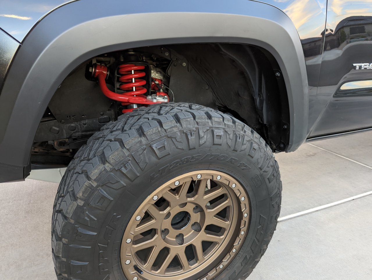

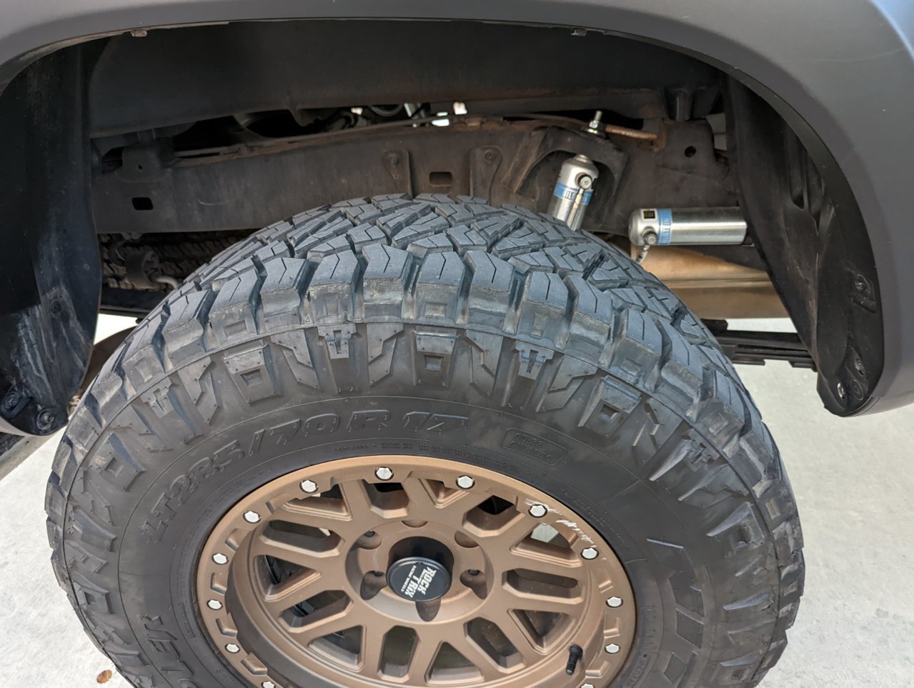

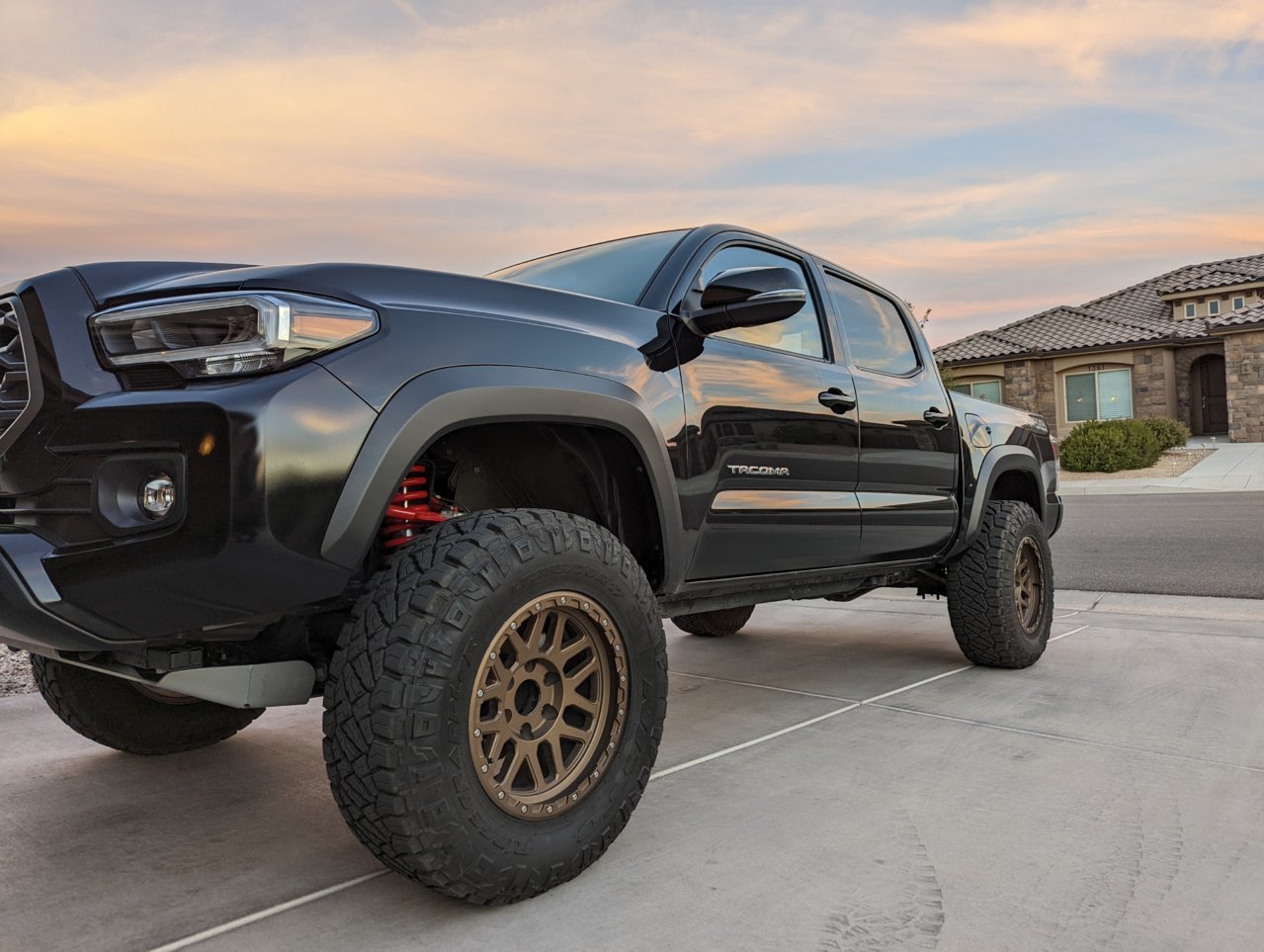

    After totalling my 2nd gen with enough parts that I about had to sit down and cry lol. I haven't known where to start on the 3rd gen build. Thanks to everyone posting so much valuable info here, I finally got a start. I just bought brand new wheels and 285 70 17 before the total... So I yanked those and lifted to accommodate: 6112 set to 6/6 and 650 heavy load coils (welding new armor at shop ) refinished red , added JBA UCA, diff drop, extended brake line; in the rear 5160, icon AAL, left heavy load leaf in. The ride is moderate firm, but exactly how I love it. Just wanted to pay the info forward and save someone weeks of going down the lift rabbit hole.

    hows it ride on the street on option 2? did you do anything else to it to accommodate the lift? Ive also got a long bed and plan on adding a hitop shell within the next year and also have some Schmell sliders on order... looking to dial in 2" front and back... Great looking truck!

    Thank you! The ride is phenomenal. It is noticeably stiffer, but in a good way. There is no more front end dive on braking, and I don't hit the bump-stops on the rear anymore. The only things I did for the lift are what I listed there. I should add that I have built out a sleeping platform with drawers in the back with 3/4" plywood, and that's why I chose option two.

    How are your cv axles? I’m on 6/6 with 650 springs and my cvs are angled quite a bit.
