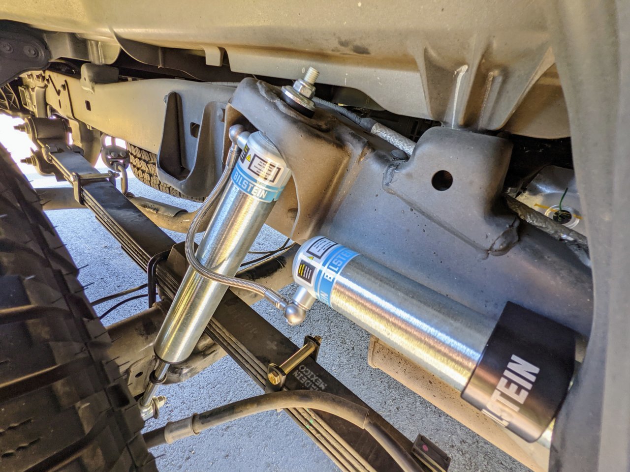

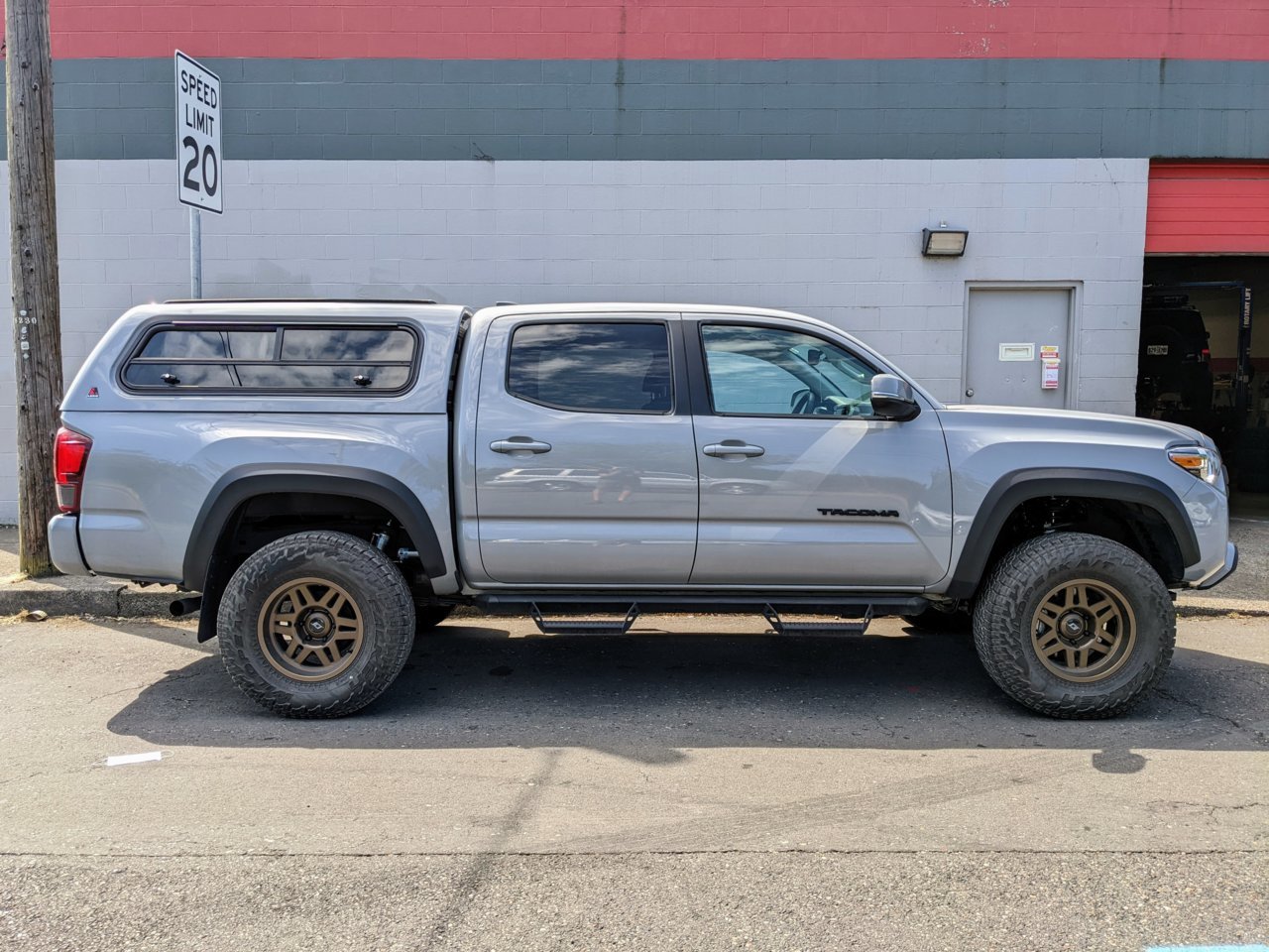

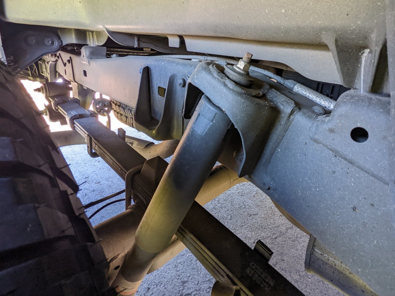

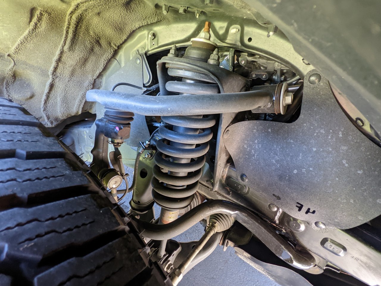

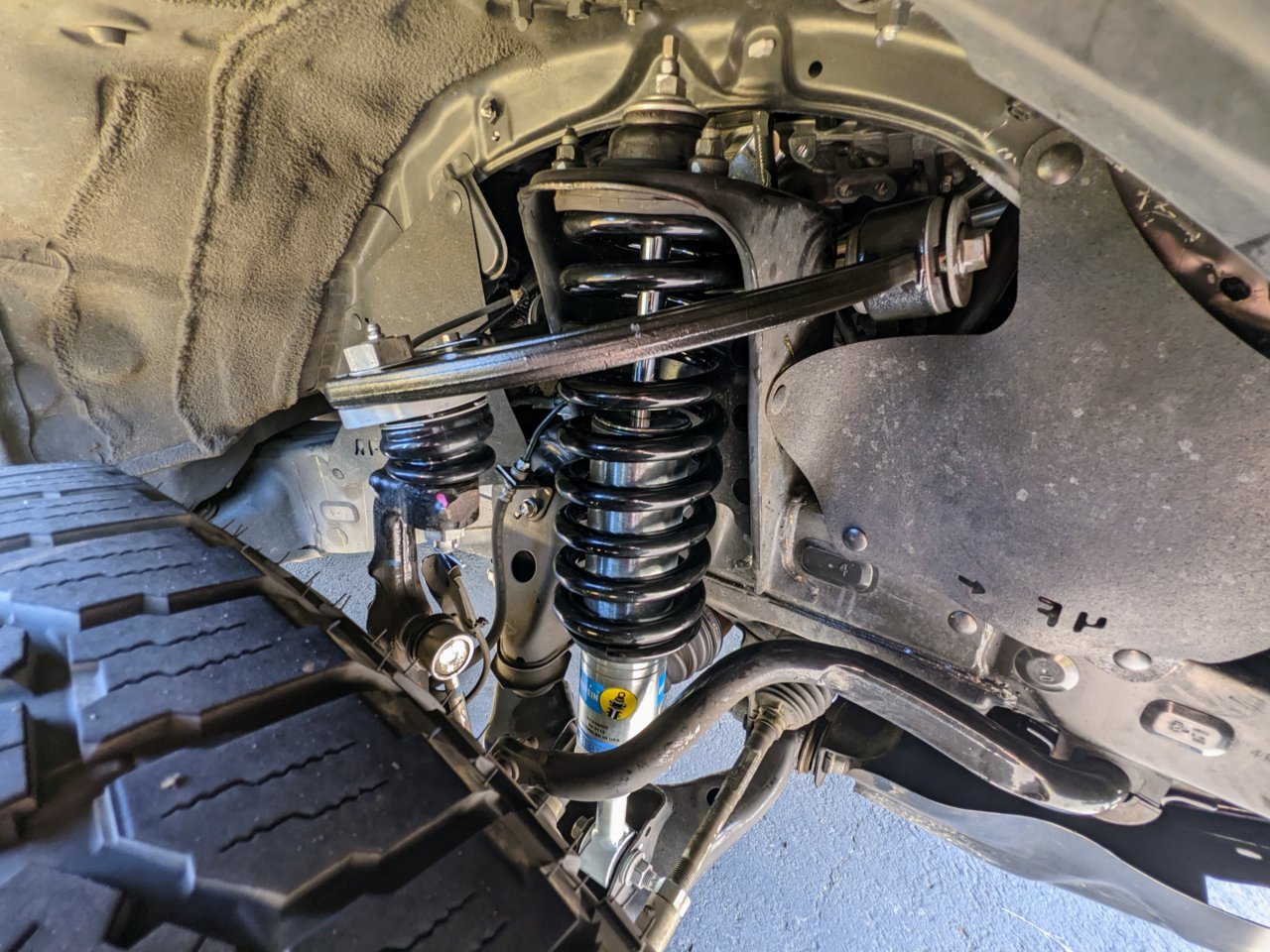

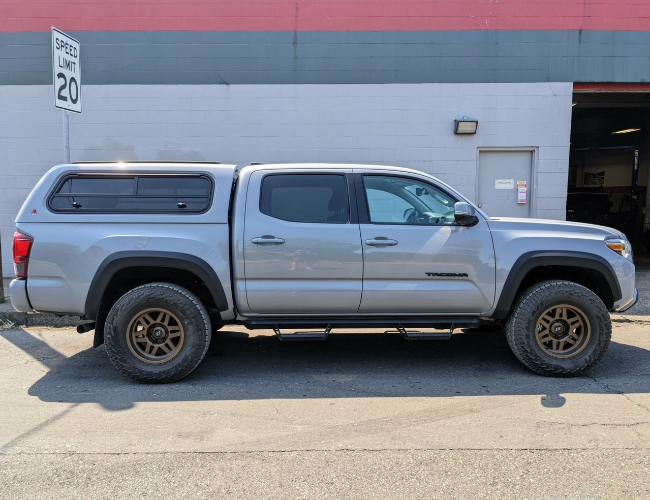

    Just got back from the shop! 6112/5160 plus SPC UCA and Icon AAL. Ended up with just under 2" in front set at 5/4 and just over 1.5" with the AAL in back.
    Some befores and afters:

    Looking great :thumbsup:

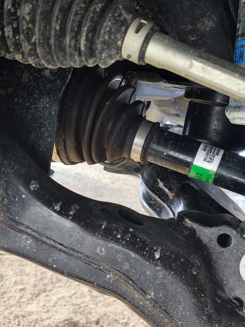

    I’d go 5160’s. Nice to have the reservoir for heat dissipation if you have the truck loaded while wheeling. My driver side reservoir started leaking, and I don’t wheel as much as I used to so I just put extended 5100’s because my current leaf pack gives me a lot of rake.

    I wanted to stay 6/6 so I just replaced my cv axles with the CVJ axles for lifted Tacomas. Claim to be higher strength boots.

    Sounds like you should be good then. As long as the boot isn't rubbing itself when the truck is level. If it is the boot will wear out prematurely.
