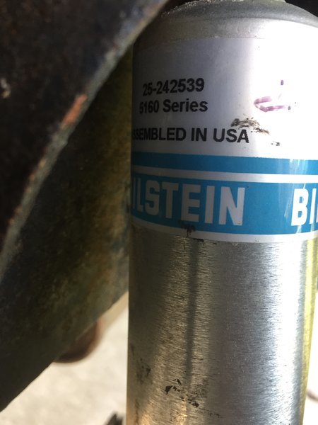

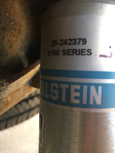

    Didums
    #25-242379 - drivers
    #25-242539 - passengers
    Edit: added sides in case someone comes across this later.

    Left
    Right
    79 goes on drivers side
    39 goes on passenger side
    Per Marie@headstrong so if it wrong blame Marie...lol! Jk Marie.

    Yeah I emailed Headstrong and they confirmed the part #'s. So I went and took a look and I will be damned but I got them on the right sides.
