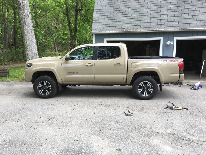

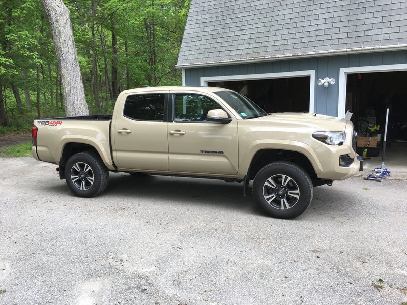

    Jonny
    2017 Tacoma TRD Sport DCSB
    3rd gen 6112 set on 4th notch(1.5")
    1/4" hs driver side spacer
    1/2" toytec rear shims
    5160 rears
    Stock rims and tires. I have 265/75/16 Falken Wildpeaks going on method nv's this week
