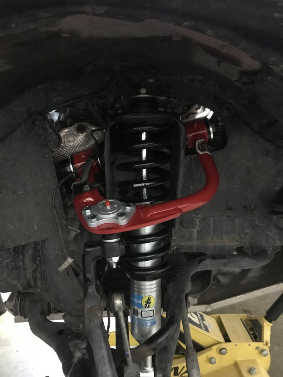

    Thanks for the responses all, much appreciated. Looks like I'm set on the 650# springs and Icon stage 2 leaf pack. @memario1214 I checked out your guys website, do you offer the shocks pre assembled and/or with the 650# spring? I didn't see an option for either.
    A couple final questions, anybody who has run on the top notch hows the ride? Should I bother with UCA's? I kinda want them but in reality they are probably unessesary, however I don't wanna deal with alignment issues either.
    and sorry, I'm sure this has all been covered a million times over, I just wanna make sure I do this right the first time and needed a little nudge to pull the trigger.

  16. Aug 10, 2022 at 4:52 AM
    #6016
    BattleKat
    BattleKat Well-Known Member
    May 19, 2020
    #328589
    1,070
    San Diego
    2021 TRD Offroad 4x4 - Army Green
    6112/5160s Icon RXT Leaf Pack (Option 2) Cali Raised 0-Degree Rock Sliders Cali Raised Bed Stiffeners Talon's Garage Cat Shield TRD Skid Plate ARE MX Interchangeable Yoda Dashboard Buddies
    I got new UCAs (Billstein's with Dirt King caps) and did the ECGS bushings just for peace of mind.

  17. Aug 10, 2022 at 6:06 AM
    #6017
    Scott B.
    Scott B. Well-Known Member
    Nov 11, 2014
    #142118
    4,462
    Scott
    Georgia
    2015 ACLB SR5 4x4 Expo
    If you want to run in the top notch, get some UCAs. Definitely worth it. Saves ball joints and tires.

  18. Aug 10, 2022 at 6:49 AM
    #6018
    RedDeadTaco
    RedDeadTaco The Hipster Woodsman
    Nov 24, 2016
    #203211
    1,315
    Andrew
    Aiken, SC
    '16 Barcelona Red OR
    Mobtown Sliders, Aluminum Skids Bilstein 6112/Extended 5100’s Iron Man constant load leafs JBA High Caster UCA’s Diamond Back Tonneau 285/75/r16 Cooper STT Pros Method 702’s Uptop Overland Alpha Roof Rack
    Buy once cry once. I had 600# springs and set at 5 on both sides. Started sagging a bit so I went 650# on 6. Glad I just bought UCA’s before hand

    IMO get UCA’s you’ll be glad you did. Top notches 650 coils and riding excellent. Full steel skids , sliders. 2” of lift. It’s a daily as well :thumbsup:

    I see limit straps hiding in there... What are you running now in terms of lower arms and shocks? We also have those 6112s on hand should you decide to go down that path :spy:
    https://hotshotoffroad.com/collecti...s/bilstein-6112-coil-strut-combo-16-22-tacoma
    We do offer assembly! I'll shoot you a PM and we can work through details, and I'll work on getting the website cleaned up today to give that option for anyone into the future. We built some 6112s with 650# springs for @ksimms92 just a couple of weeks back!
    Here's my .02 on the UCA discussion (and feel free to put your tin foil hat on since I am a retailer after all) - When folks lift +2" and/or run a really big wheel+tire combo we generally recommend them for clearances. As @Scott B. indicated you're also putting yourself in a position to have some better tire life and on-road manners as you can dial in specs. We offer many different brands, but we tend to recommend SPC as they offer the greatest amount of adjustability and fall on the lower end of maintenance cycles. We have been able to get 33s underneath a Tacoma without having to cut the cab mount.
