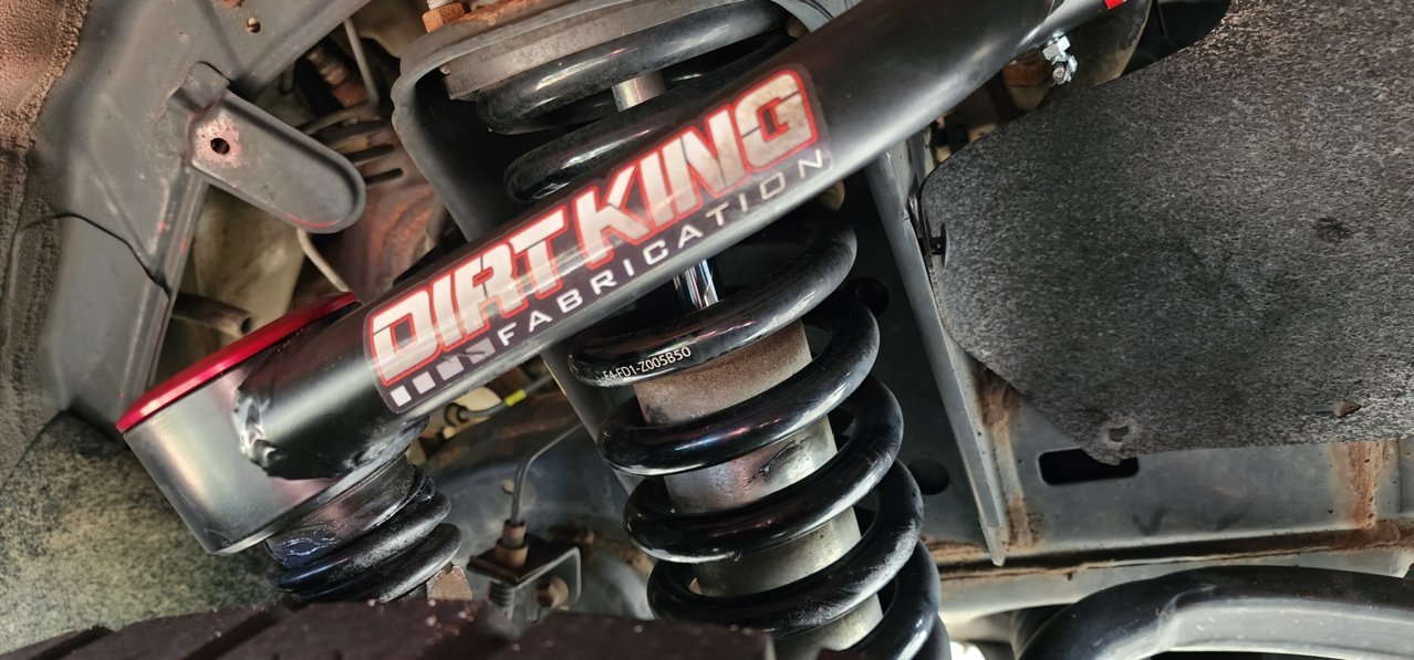

    -Bilstein 6112 front shock. Leveling lift -Bilstein 5100 rear shock w/TSB leaf pack. -Cooper Rugged Trek 265/70/17 -EBC front ultimax rotors w/yellow pads -Stoptech sport rear drums -Steel braided brake lines -Wet Okele seat covers front/rear with heaters -Custom built exhaust with Black Widow venom 250 muffler -Afe Stage 2 Dry CAI -Diode dynamics SS3 fog lights yellow. -OPT7 Projector Headlight Assembly w/Black backing -Undercover Flex Tonneau cover -Weather Tech floormats front and back
    Some nice shiny new UCAs to go with the 6112s. Amazing driving experience now. Huge difference.

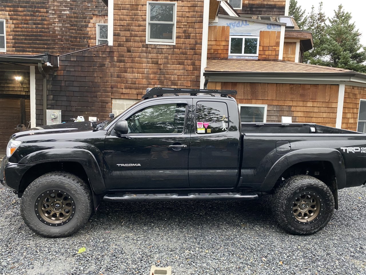

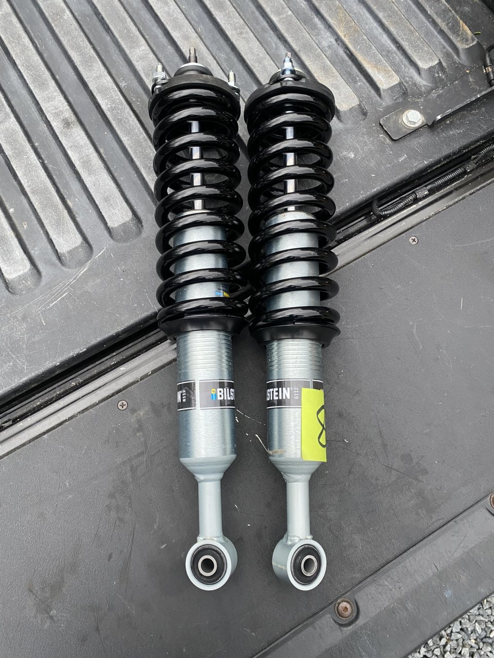

    Another happy customer here for @memario1214 !! Super easy and knowledgeable to deal with, great price, shipped quick. Got them pre assembled on #10 notch driver side and #8 notch passenger. Rides like a dream, nose dive when braking is GONE, truck feels firm and planted. Huge upgrade from 5100’s and stock coils

    What size tires are those? They look BEEFY. Might just be the access cab effect.

    Hell yeah 285 70 17, it has a 1” body lift too
