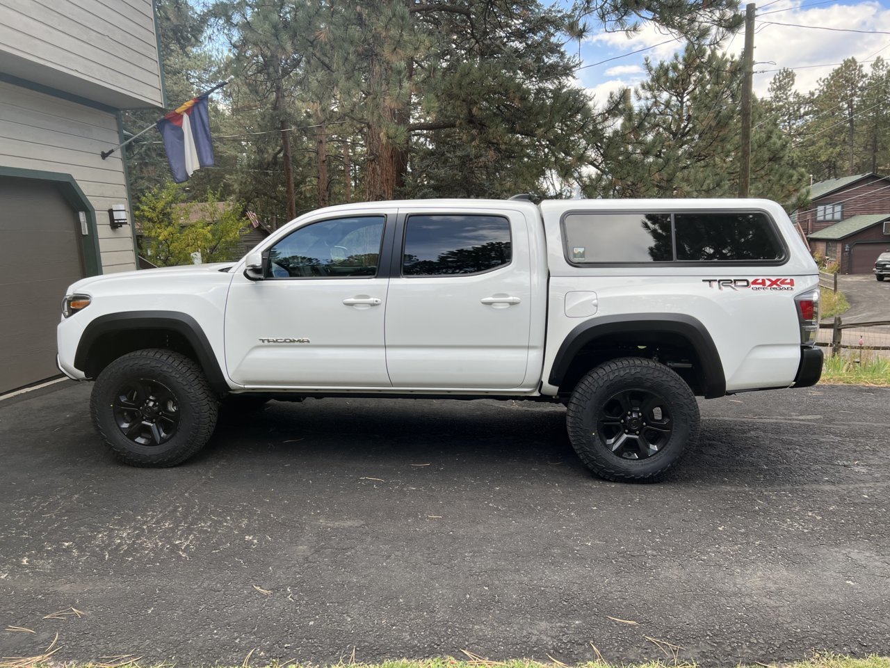

    Just installed 6112s at 10/8 setting (600lb spring) and have 2” of lift after a week and an alignment, with just the TRd front aluminum skid plate.
    Measurements with a full tank of gas are 22.75” drivers and just under 23” passenger side.
    Rear is the Icon RXT stage 3 leaf pack and 5160 shocks. With 275 pounds worth of topper and bed platform I’m at 24.5 driver side and 24.75 passenger with a full tank of gas.
    1.75” of rake is perfect so I can add weight without brolean. The 250 pounds of stock wheels and tires only sagged the rear by 1/4”. The truck drives nice and smooth with a more planted feel than 5100s, stock front springs and 3 pack add a leaf. 9790438D-831E-46A8-AC12-C3BDD26BB8BB.jpgloving the derped 4Runner wheels with 255/80r17 Falken at tires. Looking forward to checking for rubbing once I can hit some trails this weekend!
