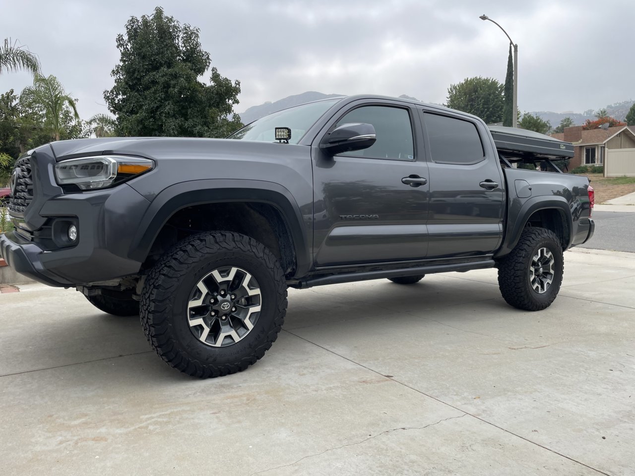

    Finally got my parts done. This is 6112 on 10/8 with 5160 and Icon RXT (1) in back. I ordered the ECGS bushing for when I replace the needle bearing in the future, so far it hasn’t had an issue.
    I went through Hotshot Off-road which was a good buying experience but unfortunately the driver 6112 shock eye was not aligned and I simply couldn’t turn it under my own power, nor did any spring compressors I found fit to help relieve the load to spin it. So I wasn’t able to install the front myself (the reason I ordered them assembled) and had to have a shop do them, which was a bummer.
    But now it’s all on and happy with the inroad performance so far. Haven’t taken off-road yet.
    In my excitement I didn’t measure the before. It now it’s measuring 22” (P) 22.5” (D) up front and 22.75” (P) and 23” (D) in back.

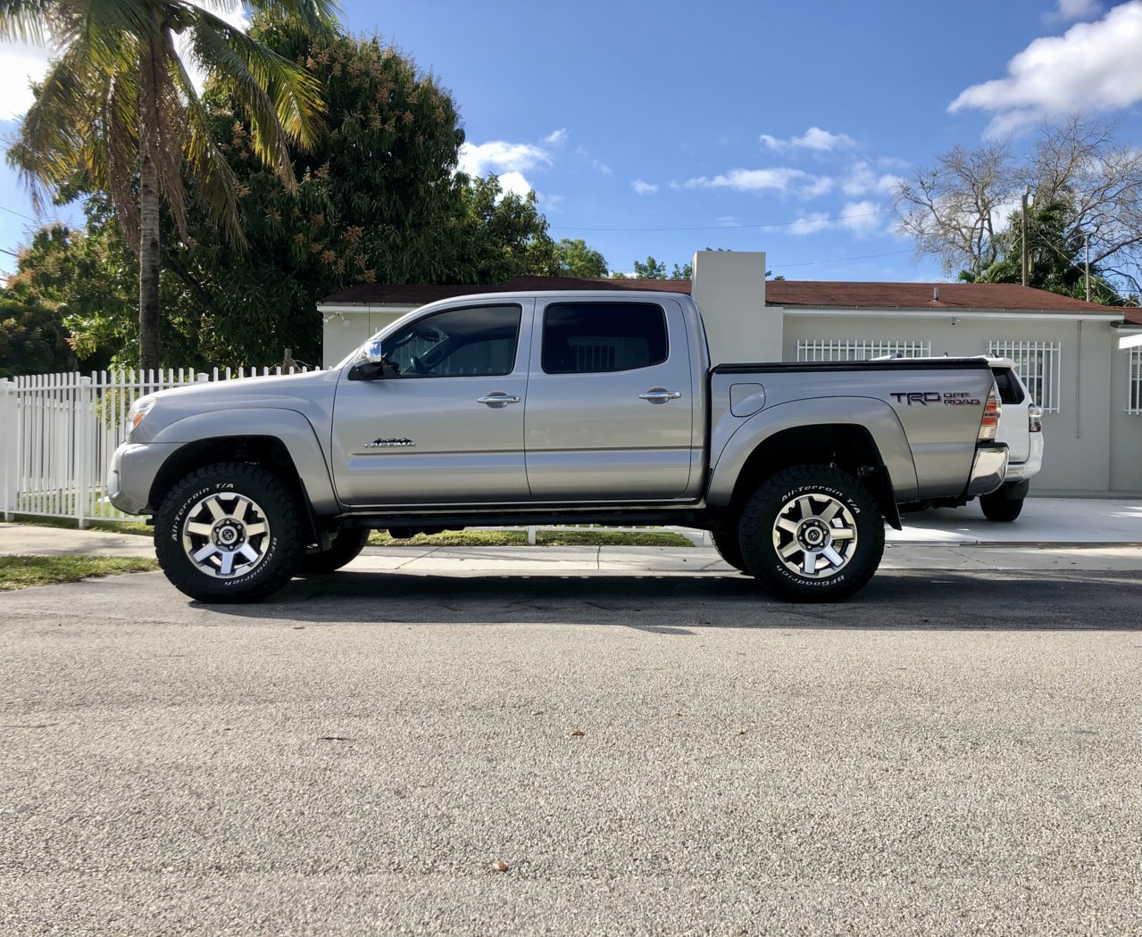

    240C0F72-DDA1-4C91-AE61-67FBAD4F4732.jpg 8F718070-1521-4279-9B25-5617548077DE.jpg Hello,
    I have a lifted 2015 DCSB TRD O/R 4WD.
    FRONT:
    5100s, 885 coils and 3/8” taco lean spacer. JBA UCA’s. Wheelers SuperBumps, ECGS bushing, diff drop (diff drop along with spacer lift installed 4 years ago by original owner. I bought this truck in 2018).
    REAR:
    ATS medium duty leaf springs, 5160 shocks, brake line spacer bracket, GM bump stops.
    All suspension done less than a year ago except for the 5100s/885 coils which are older.
    Current height hub to fender with full tank of gas:
    LF. 22 1/8, RF. 22 1/4
    LR. 24 3/4, RR. 24 7/8
    I’m looking to buy 6112’s completely assembled. I will not be adding any weight up front. I’m hoping for a little more front height to lessen but not eliminate the rake.
    For those running the 6112’s what are your measurements?
    What coils?
    What are your ride heights?
    Different clip settings to compensate for taco lean or taco lean spacer?
    Are there 2 versions of the 6112’s?
    I’ve read some people say 6 is top clip and others say 11
    Thank you.
