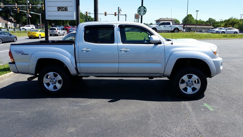

    yes top notch is the 5th. They ride very well...no comparison to the OE. at this point my front is 3/8's higher than the rear. While I'm not crazy about that because I prefer level or front slightly lower than rear, for the time being I'm going to ride it. In the near future I plan on bringing the rear up at least 1/2 an inch but wheels and tires first. I'll post a pic shortly

    parking lot is not level so the rake appears to be more than it really is

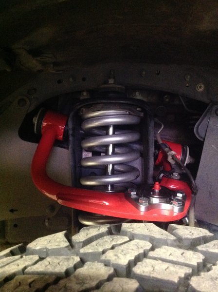

    Had my suspension installed today. 6112s w/ Eibach 650# springs, JBA UCAs, OME Dakar full leaf pack w/d29xl aal and Bilsten 5100 B110 shocks.
    Where to start....With the rear set up above the ass end of the truck is quite high (almost too high). I have a SnugTop Rebel cap and a sleeping platform in the bed all the time but I did the aal because I will have a rear bumper, tire swing out and fuel swing out in a month and then next year the cap goes for a bed rack, RTT, fridge and gear. I will measure and take pictures later this week.
    Installed the 6112s and 650# Springs on the 4th notch- HOLY MOTHER OF it is high (not almost as above, but actually too high). I did not get solid before measurements but I'm looking at just under 4" of lift in the front. I know the 650# springs are stiffer than the 600# ones that come with the 6112 kit but DAMN it's almost like they're installed incorrectly. I put the 650# springs in because I'm doing a CBI aluminum bumper, winch, aluminum skids and slider right away and wanted to compensate for the extra weight. I should have gone with my gut and put them on the 3rd not but because it's so high I may need to drop it to the 2nd notch. I have no idea why it's so high and I'll be addressing that this week.

    So mine on the 4th notch with the provided spring sat high initially took some bouncing on it and a quick ride to get it to settle down. The 3rd notch would have probably been ok with your current setup. But when are you planning to add the bumper and skids? If like within a month or so I would say leave it at the current setting install the additional armor/weight and then see where it sits. Since that will be your final setup and it will also give the suspension time to settle it might end up where you want it. If not then you only have to screw with the suspension once to set it

    I know it'll settle but it's super high right now (almost 4" of lift) and I don't want to wreck anything in the front end. Bumper and winch will be this time next month.

    Any clunking or weird noises while driving? I floated around 3-1/4" of lift, but I also think my stock stuff was starting to sag a bit. If you can grab a center hub to fender measurement and I'll get an updated one of mine see how they compare. I was about 23-1/2" hub to fender after the install
