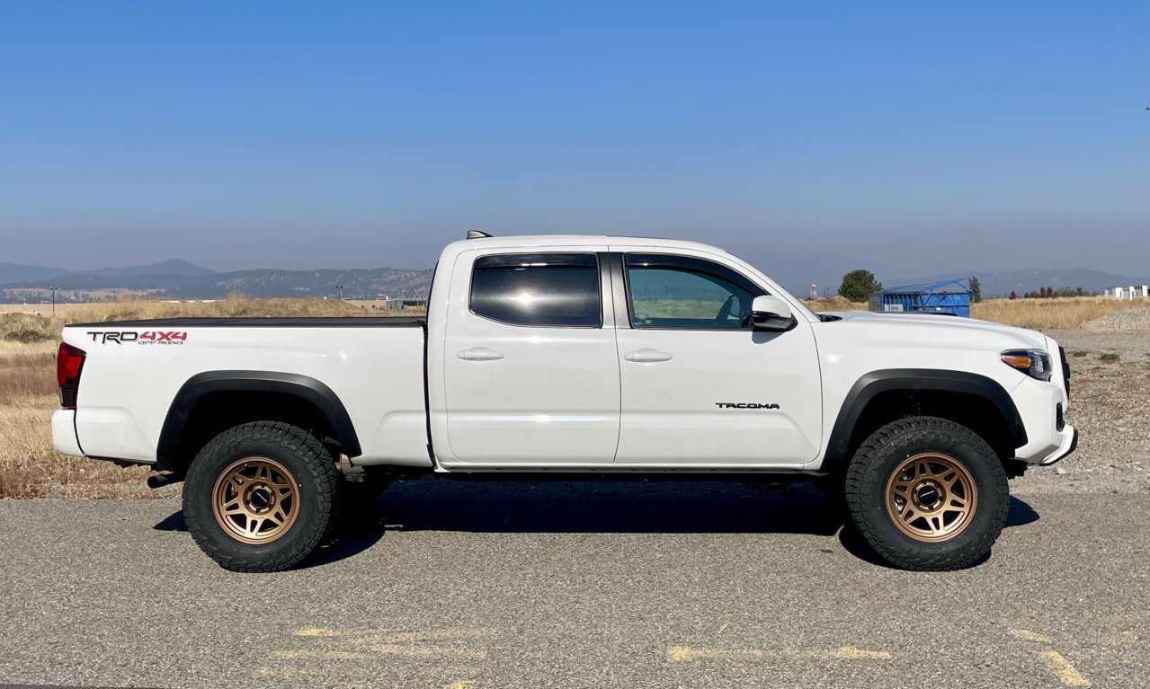

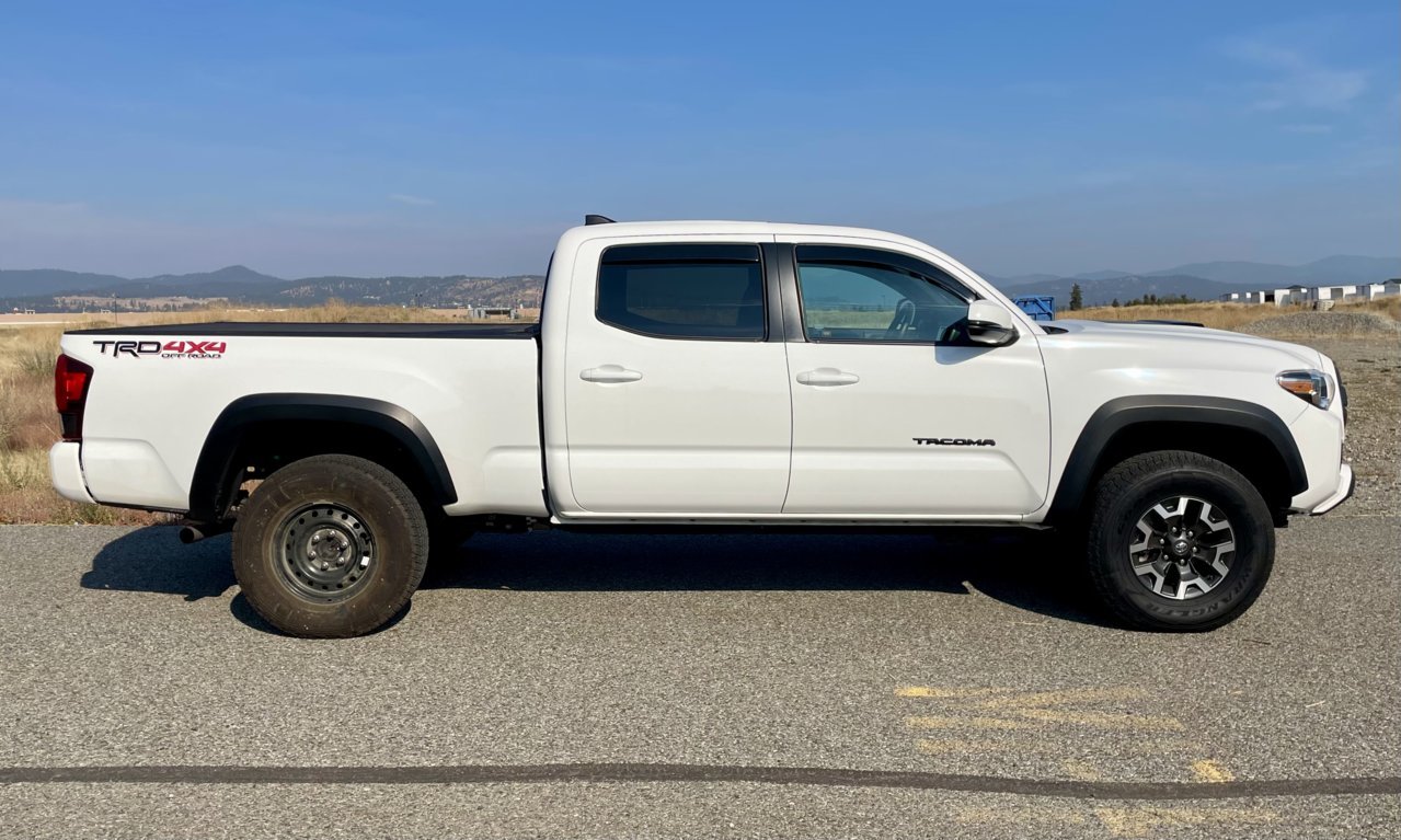

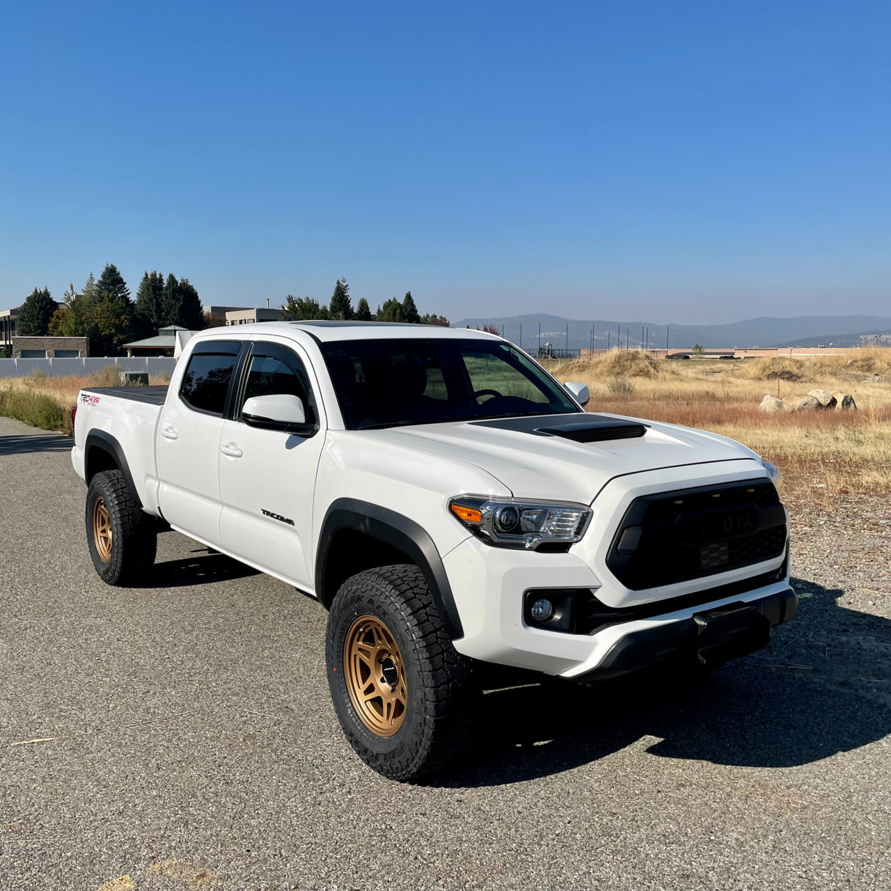

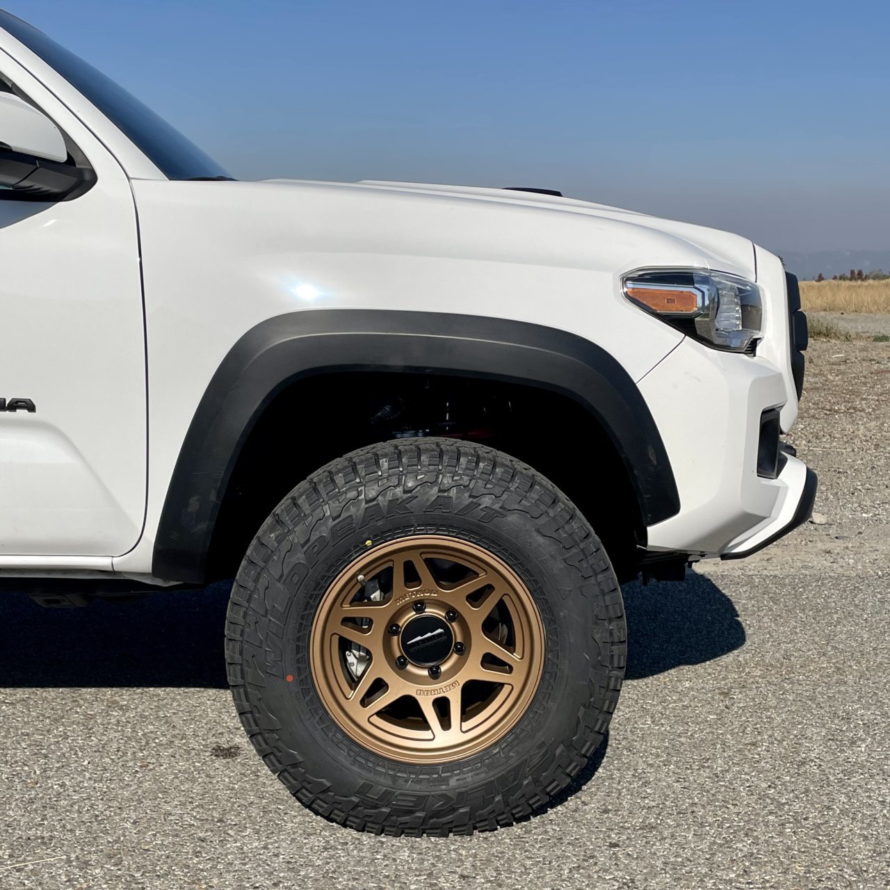

    Finally got my 6112’s installed last weekend a new wheels & tires installed today. Overall I’m REALLY happy with how it turned out and this thread was a huge help in figuring out what I wanted to do. I ended up going with the 10/8 c-clip setting, JBA’s, Icon AAL, and 5100’s. Had a minor rub on the driver’s side rear fenderwell, but the heat gun has taken care of it.
    Before:
    After:

    What tire size?
  15. Oct 18, 2022 at 7:28 PM
    #6195
    PhishinTaco
    PhishinTaco Member
    Sep 1, 2022
    #404935
    12
    Craig
    Eastern WA
    2019 TRD OR DCLB
    275/70/17

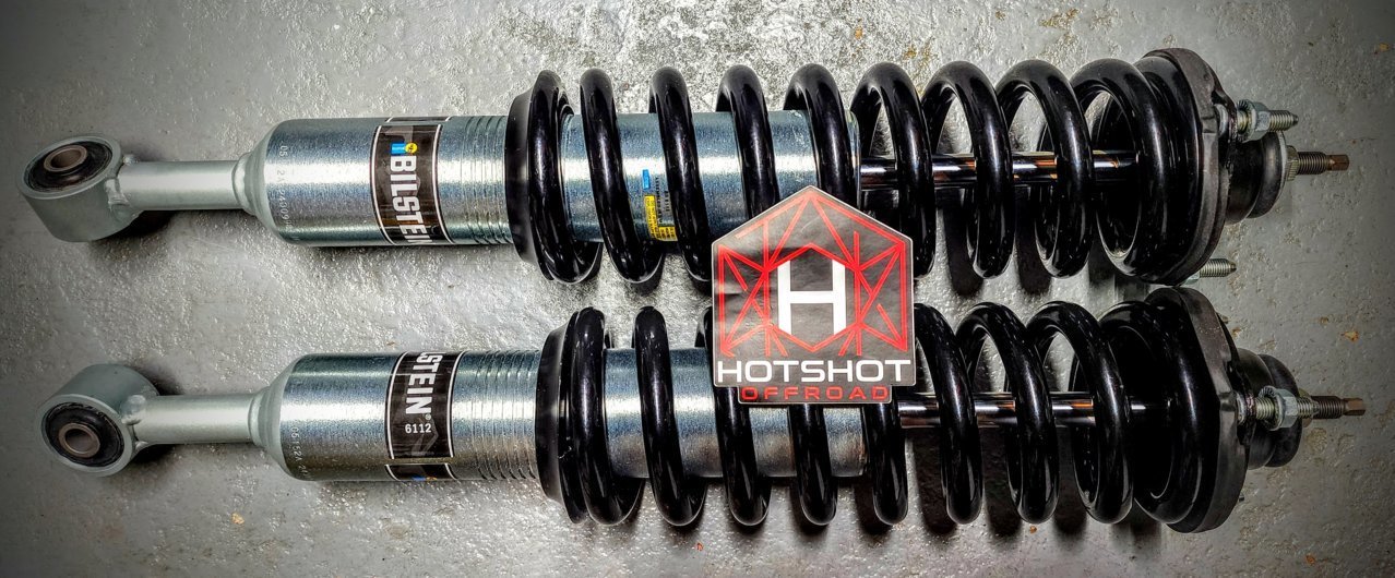

    If anyone in here is shopping 6112s for the Tacoma we've got them in stock at Hotshot Offroad, and are offering assembly at 50% off through the end of the month (so $60 for Tacoma assembly)! Also, through the end of the month if you purchase at the current price ($770) you'll get the new 11-notch 6112s! The normal price on these new ones is $826 and our pricing will reflect that on Nov 1.
    The discount will apply automatically to cart as well.
    Tacoma 6112s can be found HERE
    Photo courtesy of @Larry Dangerfield :hattip:

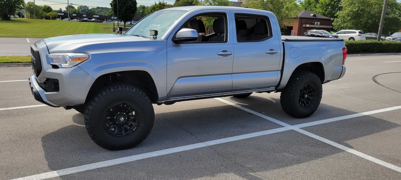

    I put my 6112/5100's on back in April of this year along with a Torch Offroad AAL (6/6 circlip old style), still on stock uppers and lowers but have a 0 Offset Fuel Blitz (16x8) with a Nitto Ridgegrappler LT285/75r16 E Load, ya ya I know heavy tire, ride quality blah blah blah, but honestly, it still drives amazing, I do get a bit of bumpsteer on the big bumps from I40 (ones a lowered car would bottom out on) but its manageable, but fuel economy could be a lot worse, i do have OTT on it and in the hills of TN im still getting 16mpg measuring from ground to fender it's about a 3-inch lift now.
    Stock 33's
    35 1/8 | 35 7/8 38 5/8 | 38 3\4
    37 3/8 | 36 39 1/4 | 39
