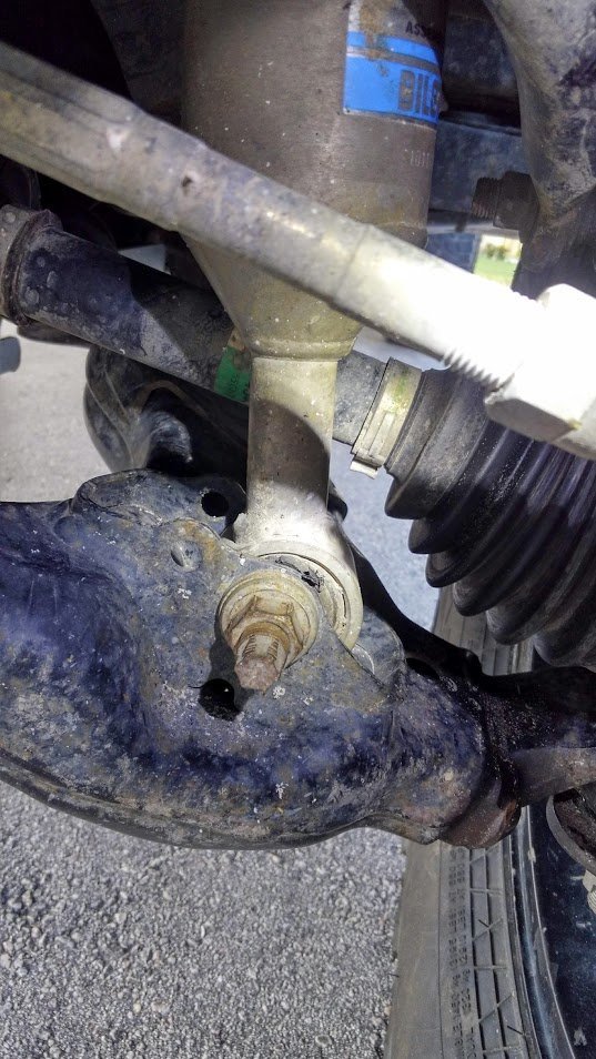

    So, I guess I’ll contribute to this thread.
    I have about 40-45k miles on my 6112s. Getting some noise up front. Turns out my bushing on the bottom is shot. The bottom one that secures the shock to the lower control arm. Anyone change just the bushing? I know they sell they bushing separately. Just curious if anyone on this forum did it themself, and have any tricks?
    not my picture, but I have a similar issue.
    MGMDesertTaco likes this.

    The bushing is a Toyota part.
    I was going to change mine, but ended up getting a new set of shocks.
    EDIT: the did have 100K miles on them...

    I know a couple guys who just rented a ball joint press from autozone. Looking to do this myself soon, doesn't look to be too difficult

    I did mine about a year ago and used a ball joint press. Bushings were for a 2015 TRD Pro IIRC. I expect mine will go bad again soon as they just don’t hold up.

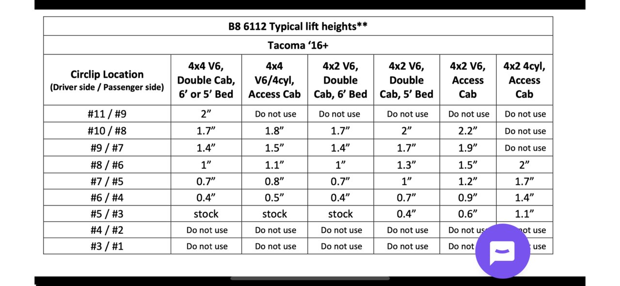

    I’m considering getting the 6112/5160 + 1.5” Icon AAL lift from suspensionlifts.com and I’m confused by the clip setting graph on their website vs what I’ve read in this thread. I’m not running any extra front end weight and probably won’t be for some time. I’d prefer to have a slight rake to level setup. If the AAL lifts the rear 1.5”, it looks like (based on their graph) that I would need a 9/7 or 10/8 clip setting, but I’ve seen conflicting info here and elsewhere. Could someone point me in the right direction? I appreciate the help. D5B4CB20-8D0F-4E7E-94D2-AA2AA7300BB2.jpg
