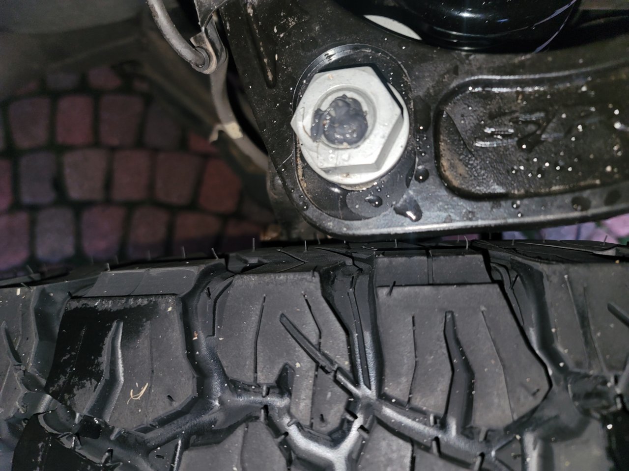

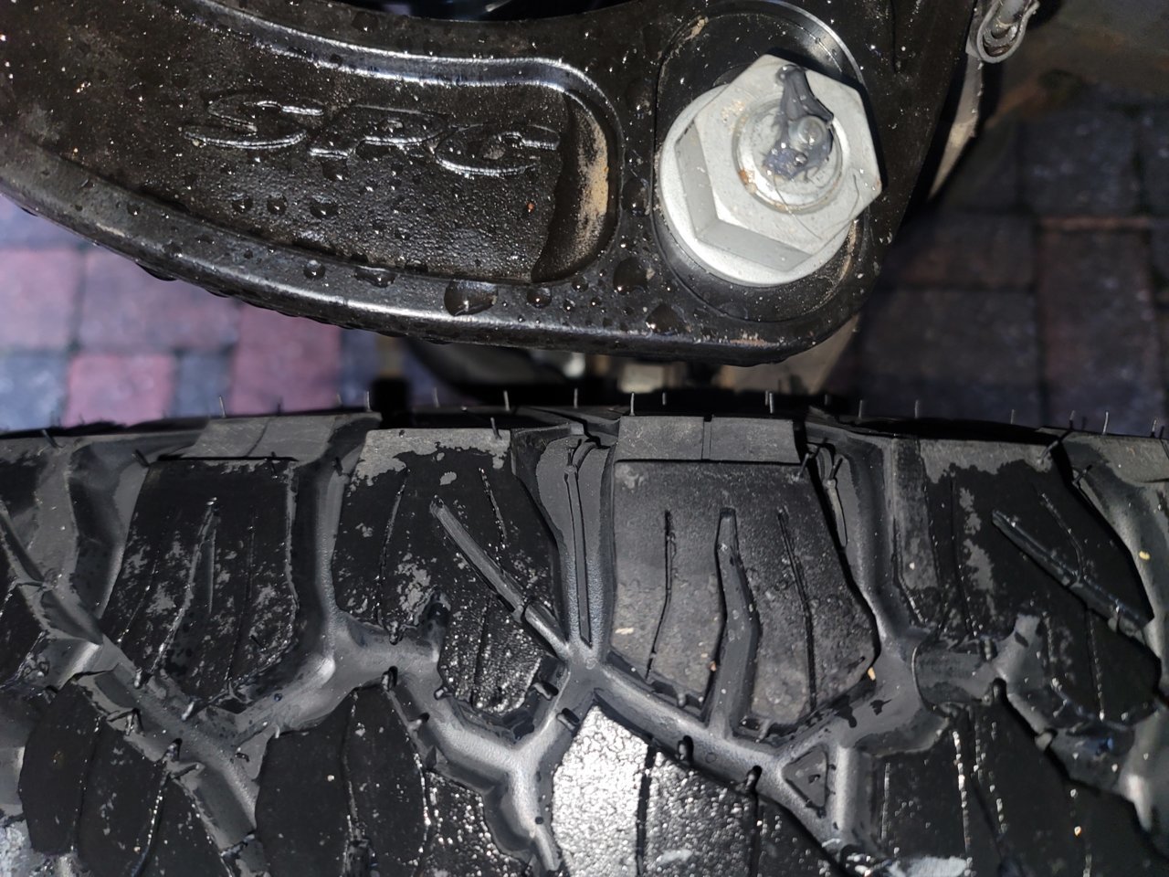

    Need some outside input. Had 6112s on 6/5 setting installed by a local shop w spc ucas. Just got 285/75/16 ko2s put on. Noticed that the tires and ucas barley have any space in between. I'm on stock off-road wheels, would I need new wheels with a - offset or spacers to help prevent them from rubbing or should I take it to an alignment shop and see if they can adjust lowers to gain max + caster. Included pics to give an idea. 20221203_160324.jpg 20221203_160309.jpg

    lower offset or wheel spacers. I think stock is +30. Around 0 would be a lot further pushed out.

    Yeah thanks, got some - 12 scs on the way so hopefully that'll do it lol
