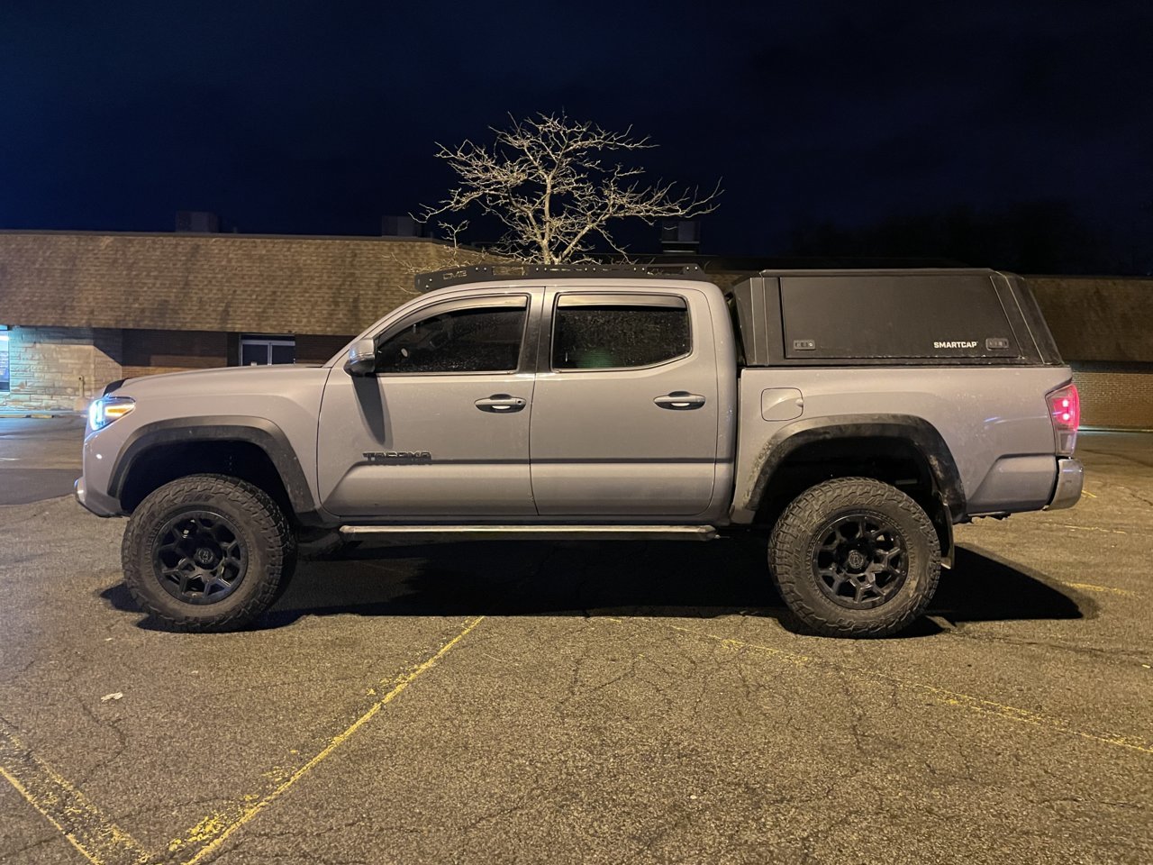

    Is anyone running notch 6/6 with 1/2” lean spacer on the drivers side? I’ve got 1/4” spacer in there and it’s still leanin to the drivers side

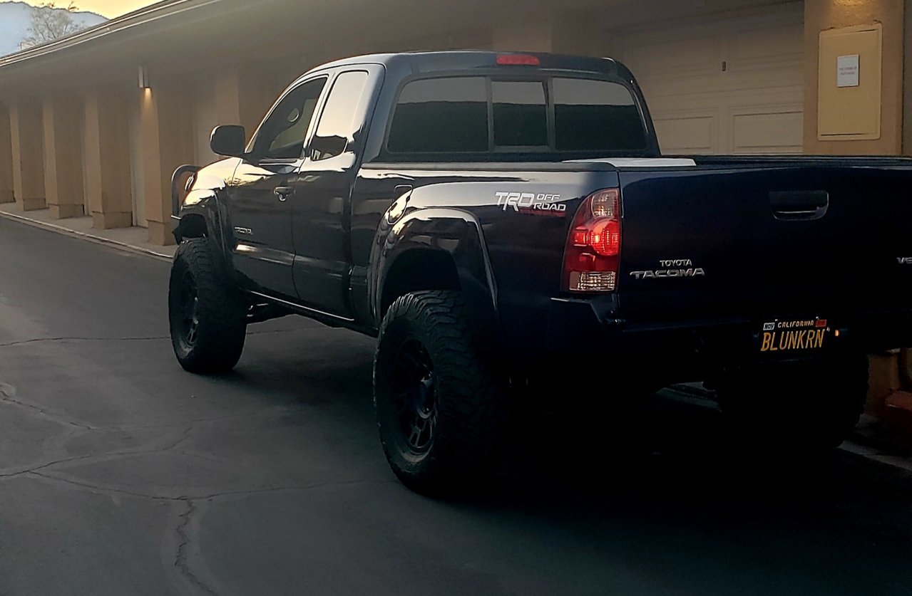

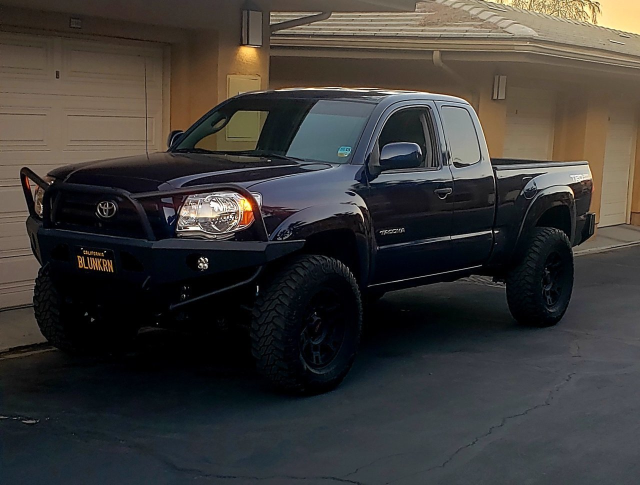

    just finished installing. Notch 4 gave me about 2" with the 600lb springs, 1.5" in the rear with tsb leafs & 5160's. Rides so nice and plush compared to the leveling kit I had on before. I will update if it settles more.

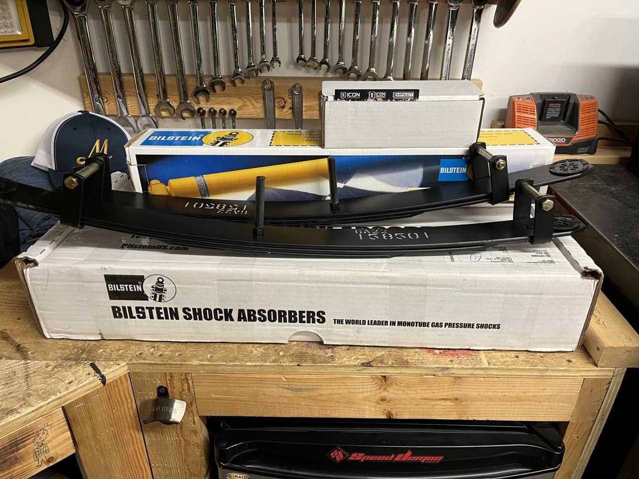

    Finished installing my lift last night.
    Front 6112’s on 650# springs from Bilstein. Clip setting 9/7
    Rear 5160’s with Icon Rxt on setting #3
    Waiting for it to settle but super happy with the stance and ride quality so far.
