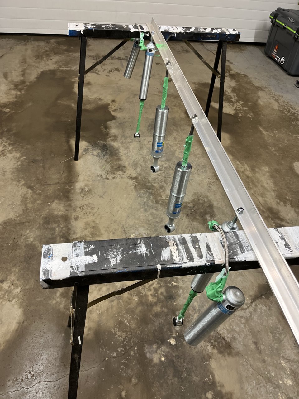

  18. Jan 16, 2023 at 10:39 AM
    #6318

  19. Jan 16, 2023 at 10:43 AM
    #6319
    Scott B.
    Scott B. Well-Known Member
    Nov 11, 2014
    #142118
    4,476
    Scott
    Georgia
    2015 ACLB SR5 4x4 Expo
    What are you clearcoating with?
  20. Jan 16, 2023 at 10:49 AM
    #6320
    tacotrdyota
    tacotrdyota Well-Known Member
    Nov 13, 2016
    #202318
    216
    Kevin
    Lloydminster Alberta
    2018 Tacoma trd sport
    Same stuff I used when I did the tundy 6112/5160’s
    still looked newish when I traded truck off 3 years later.
