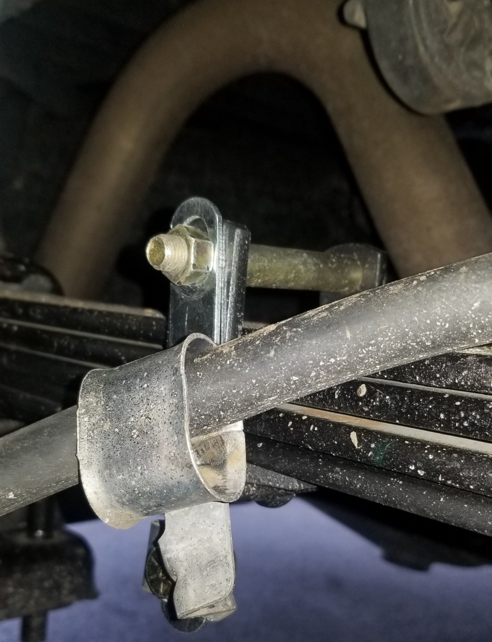

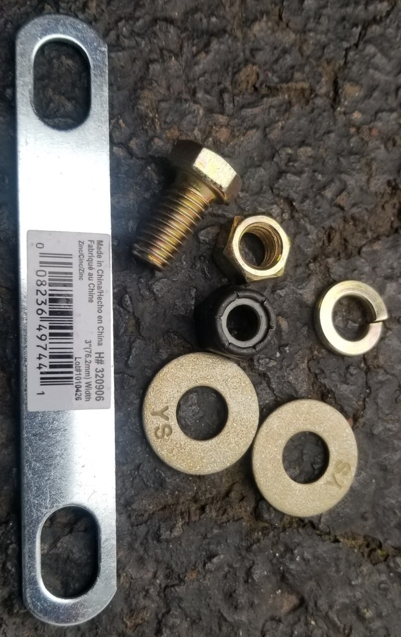

    #384638
    54
    Eric
    22TRDORDCLB BLACK
    I finished the job this weekend, after hearing the loose brackets from the emergency brake cables rattle around for hours on the back roads. I wasn't in the mood for custom fabrication, and I found all the hardware and "universal bracket" at tractor supply to fasten the e-brake cable bracket back to the Icon add-a-leaf. Using a 3/4" long 3/8" bolt, washer, and nut, all I had to do was slightly open the holes in the factory brackets with a 3/8 drill bit to allow for assembly. No more loose e-brake cable bracket and the rattling noise on the back roads. You can choose nylon locking bolt, or regular bolt with lock washer, depending on your needs. I wasn't sure what exactly I would use,
    so I bought extra hardware. If the bracket would have been a bit shorter, it would help with ground clearance when off-road, but I don't think it will be be an issue. I wasn't looking for perfection, just something good enough for now.

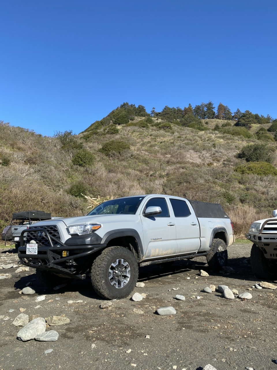

    I picked up a set of slightly used 6112s and installed them with the 650lb springs set on the 6/5 for driver/passenger. These are the older ones that only have 6 settings. I may pull them out and drop them down to a 5/4 setup. It's a little tall for the front end with my 1.5" AAL and bed rack plus camping gear. I may upgrade to heavy duty leaf springs and see how it sits.

    I saw an ad on FB Marketplace 2 weeks ago with them, and I immediately wanted the blue springs. They also came with black 600lb springs, so I have those as a backup if these are too stiff. I'm going with blue accents on this Cement Taco so it'll all work out well.
    Here's a good side shot of the suspension, the measurements from ground to fender, centered on the wheel are 39 1/8th Drivers Front, 39 1/8 Drivers Rear, 39 exactly Pass Front and 39 1/8 Pass Rear.
    New UCA's are on order, I'll install them and then have a proper alignment done. I've got it very close, but I'd like to have it right. I don't drive much, maybe 10 miles a week right now, unless I'm going on a big trip.
