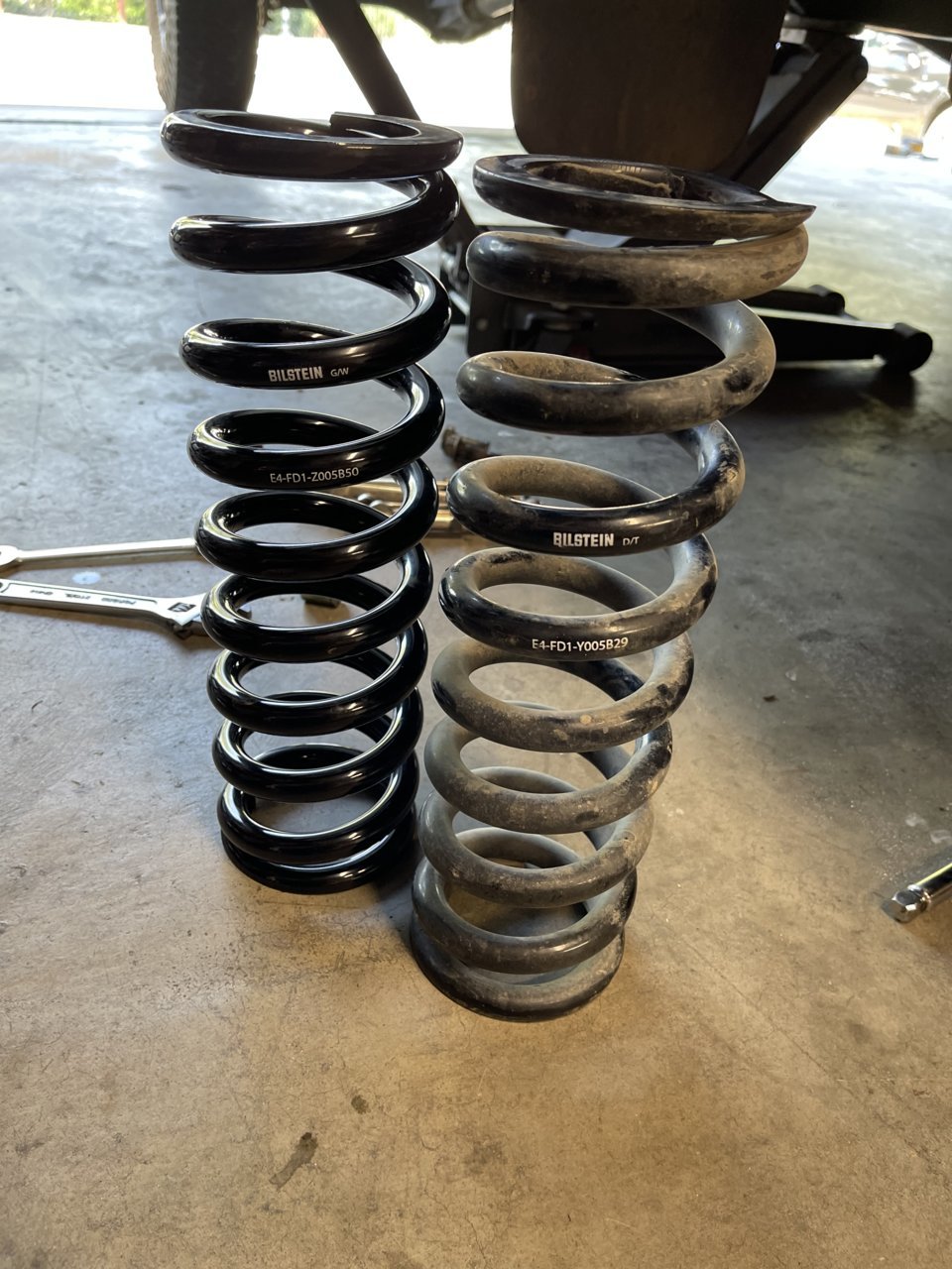

    Thanks for looking into it! Now to decide if I want to go eibach or bilstein on new coils. I am liking the silver.
