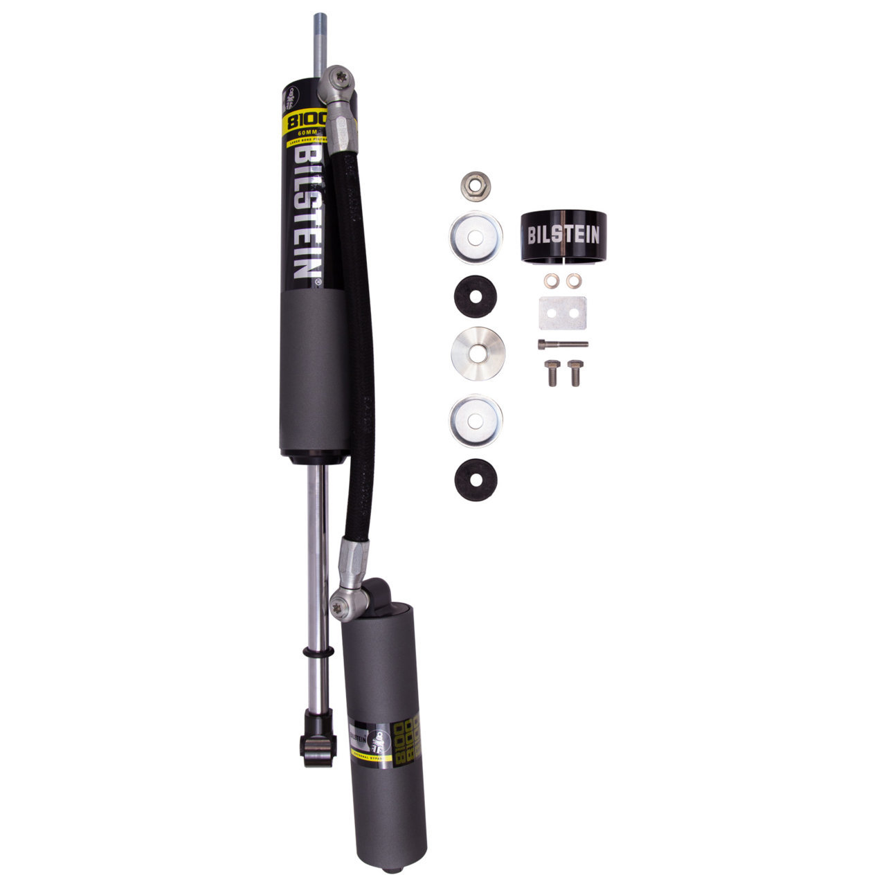

    Looking into leveling out my truck and replacing my factory off-road shocks with some 6112’s set at 1” and 8100’s (smooth bodies). That being said does anyone have any experience going from 5160’s to 8100’s? Had the 6112/5160’s on my previous 2nd gen and weren’t too impressed with the 5160’s. Figured the bigger diameter 8100’s would be a better improvement. The 8100 rear shocks I am referencing are these. Part Number 25-294064

    What didn't you like about the 5160s? The major improvement that you would find by going up to these is that they are going to be more resistant to fade. In terms of day-to-day driving though they won't be "too" much of a change. They're valved similarly.

    The 5160’s were by no means horrible, but I would’ve wanted a little more dampening that would soak up bumps similar to how the 6112’s up front did. I later swapped the 5160’s for some adjustable King 2.5’s and those rode great on and off-road. So much so I ended up going adjustable King coilovers in front as well. That full King setup was very nice. I know comparing the Bilstein to Kings are apples to oranges as they are valved differently, but thought maybe the bigger diameter 8100’s would provide me that extra dampening over the 5160’s.

    Yeah they'll be an improvement for sure, but I wouldn't expect some world-changing feel per se. They will handle the hard and continuous hits better for sure, but the basic valving will feel similar to how a 6112 feels up front in terms of when they are firm vs when they are compliant.
