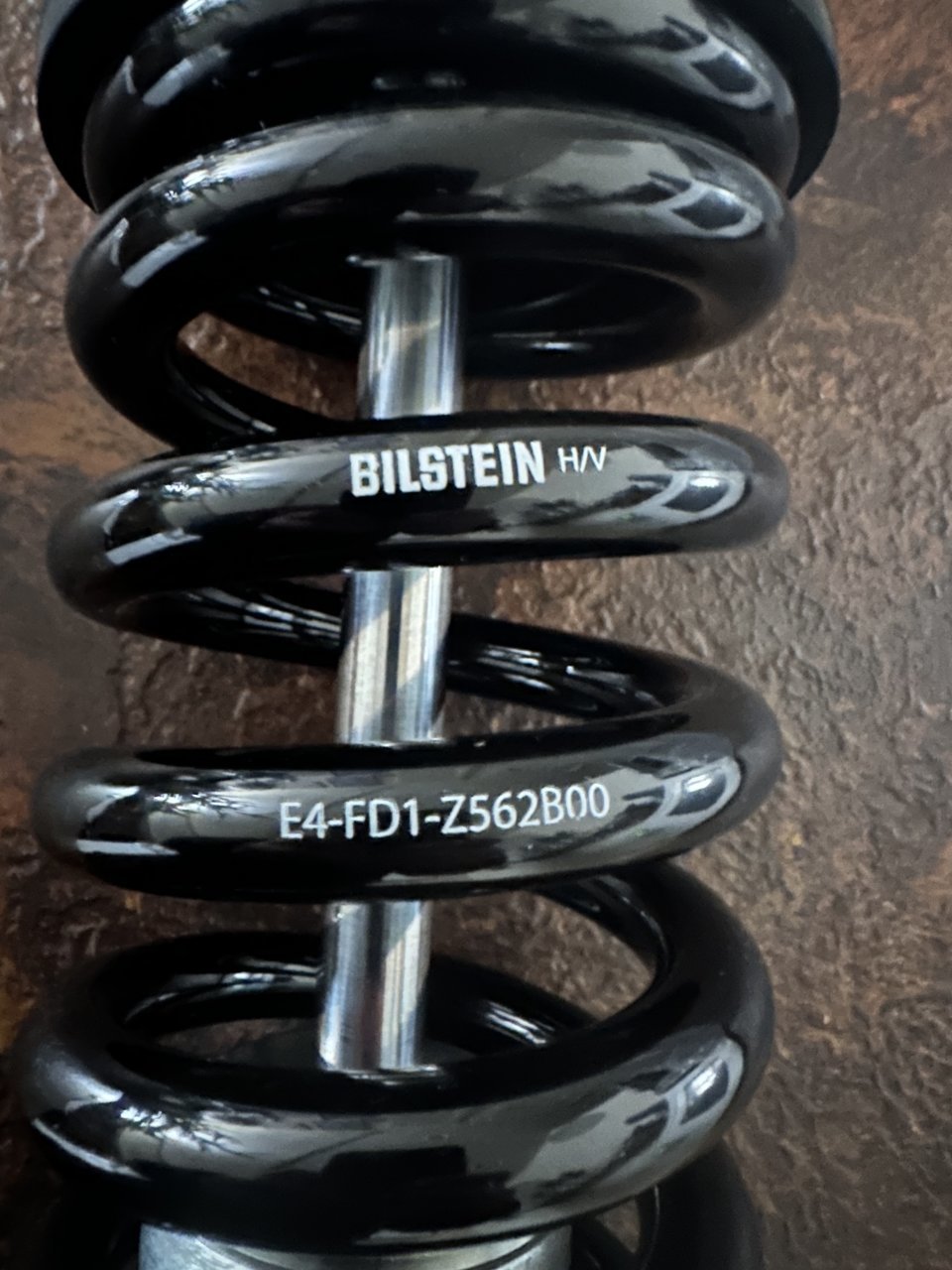

    I ordered my 6112 pre assembled with 650# springs. Just wanted to double check that they came with the proper springs before I install them. Anyone know if this is the proper part number? I couldn’t seem to find a definitive answer. Thanks

    Bilstein 6112 Coil Part Numbers
    Bilstein E4-FD1-Z005B50 – 600 Pound (Standard Spring that Comes with).
    Bilstein E4-FD1-Z562B00 – 650 Pound (Black) (80-140 Pounds Extra) Part# 53-291387
    Bilstein E4-FD1-Y005B46 - 700 Pound (Black) (150-200 Pounds Extra)
    Eibach WOR3X14Xx650 – 650 Pound (Black)
    Eibach 1400-300-0650s-X2 – 650 Pound (Silver)
    Eibach 1400-300-0700s-X2 – 700 Pound (Silver)
    These are my notes from my research and installs that I have done.

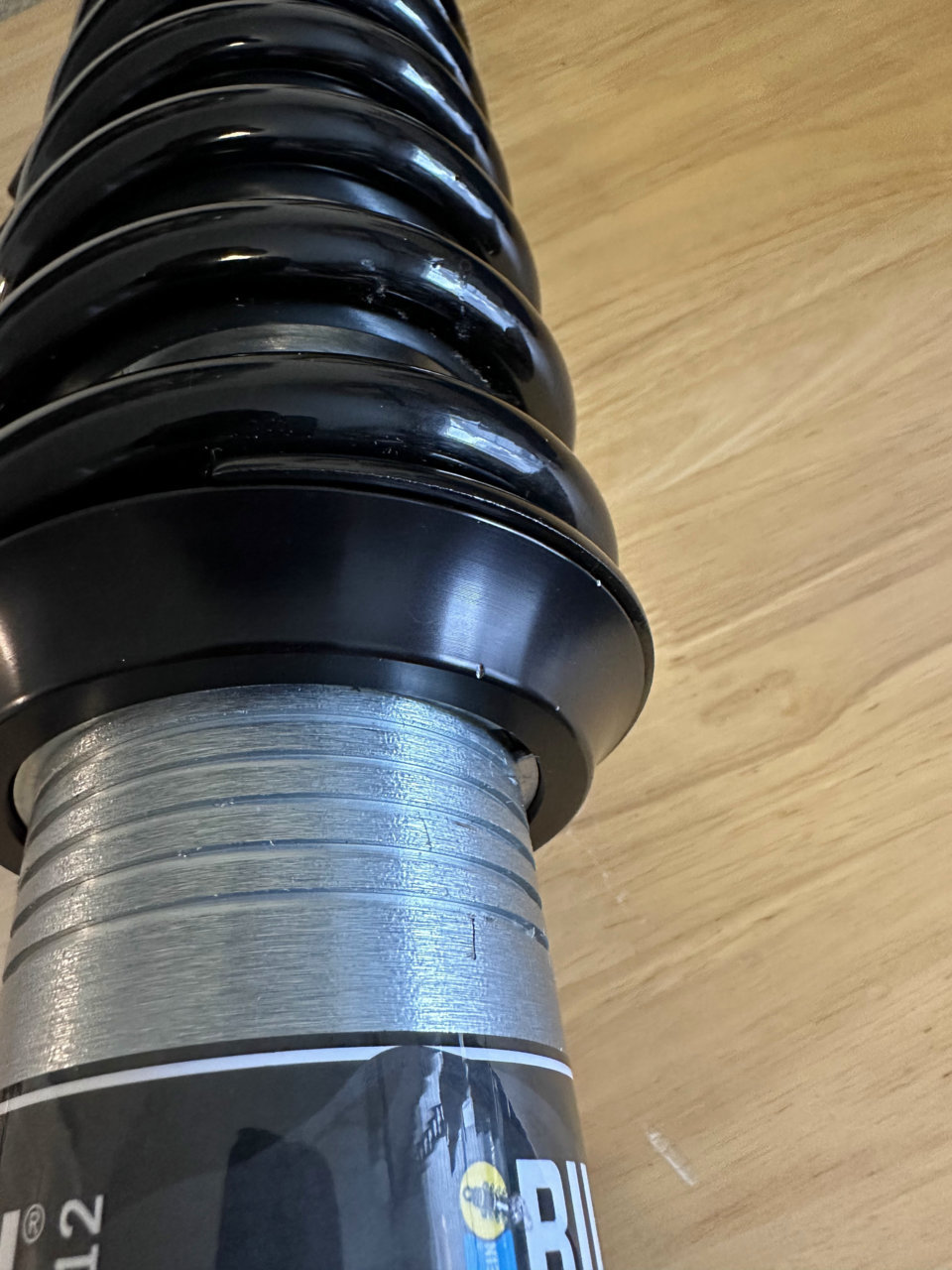

    When we build them they have a slight bump, but not nearly as much as what it looks like in that photo.
    If you're not asking for load carrying capacity out of your rear end, and you just need a little bit of lift I am perfectly comfortable recommending a small block to you. A 1"er isn't going to hurt a thing, and isn't doing your overall suspension a disservice.
