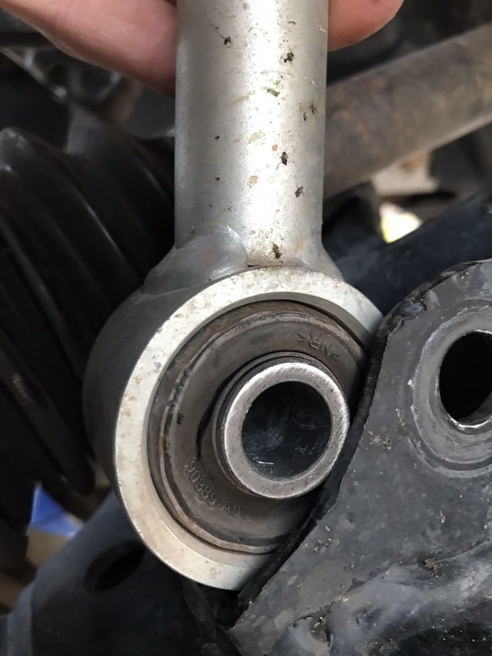

    Has anyone pushed the bushing out of the bottom eyelet? PITA or easy peasy? Had them installed about 2.5yrs and its time to replace.. Number on the side 90389-A0001 for a replacement, I'll chime back in when the new ones show up and I get it figured out.

    It's easy. They'll provide a bit of tension, but crack the seal and they fly right outta there.

    I did mine about 1.5 years ago and it was easy. Just need to use a big ball joint press tool.

    It is not bad at all. I did mine last year. I followed this youtube video and it was easy peasy.... Even though it is on a 2004, it is the same principal. https://youtu.be/oAVdOhvpBbg

    Thanks for the share. Pretty much how I figured it would go, even have the same HF press to use. Also say the same about longevity, as the daily driver and the weekly wheeling they take a good toll. Cheap replacement to keep your shocks happy.

    Agreed. Make sure that you find and use an 1 1/8 socket....it really is the perfect size, and when you go to press the new one in, put the new bushing in the freezer for a couple of hours to shrink up the metal going around it so it goes in a lot easier.

    Bilstien finally got back to an email and provided a part number for the bushing in the bottom eyelet. E4-GV2-Z024A02 is what they recommend.. Found some comparable ones from other vendors under $12 a bushing
