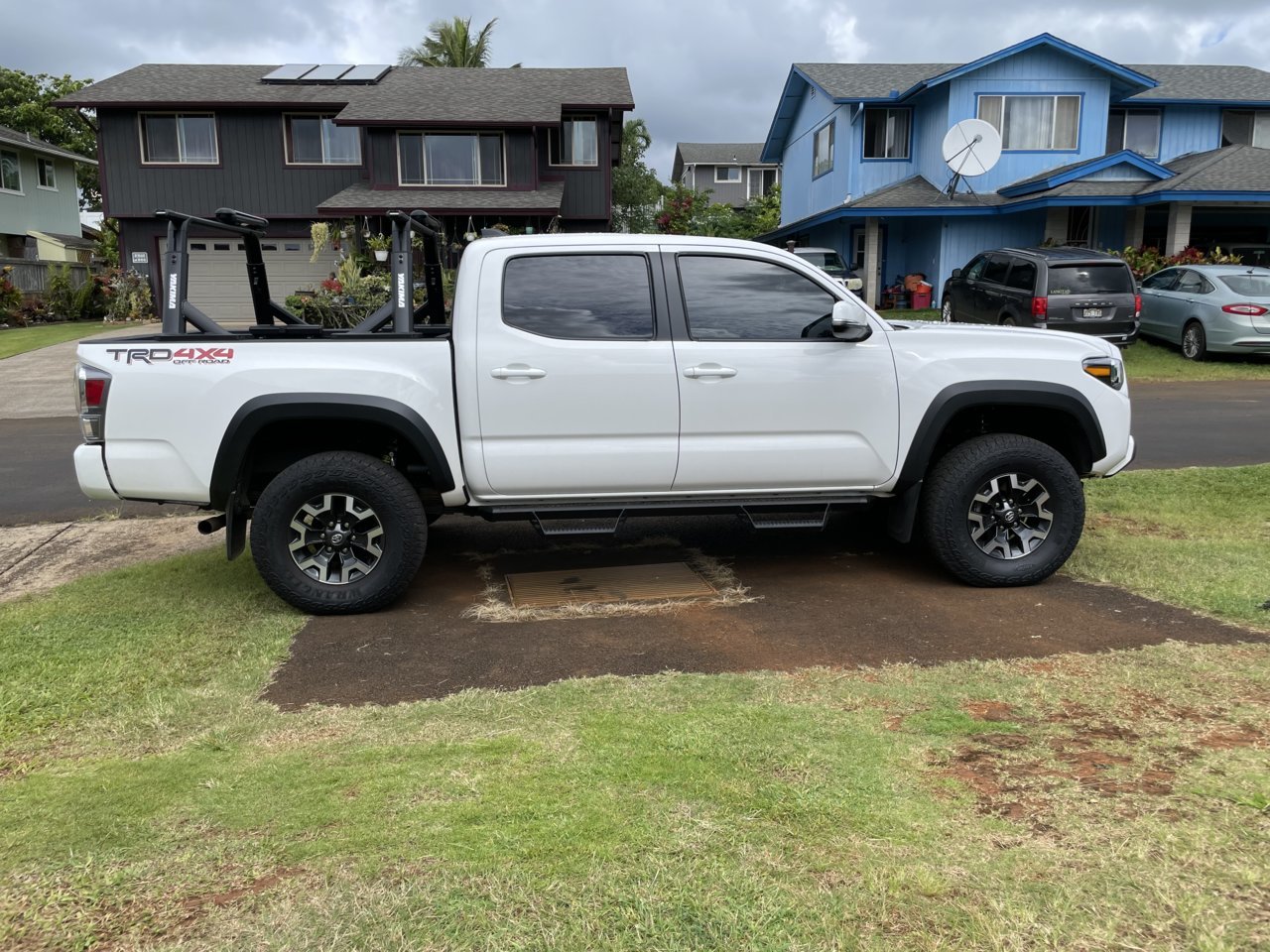

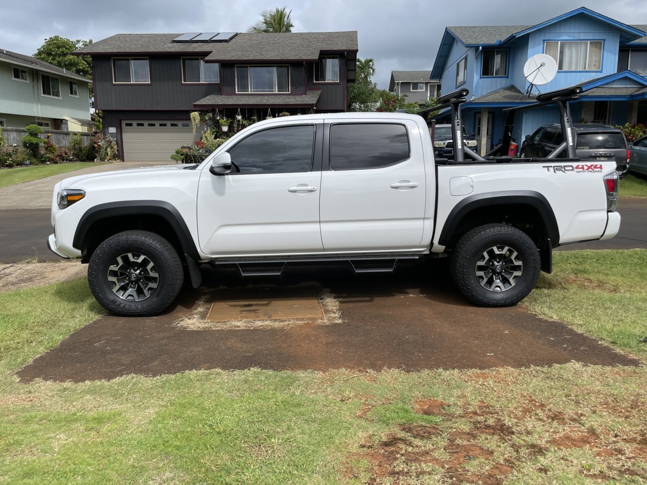

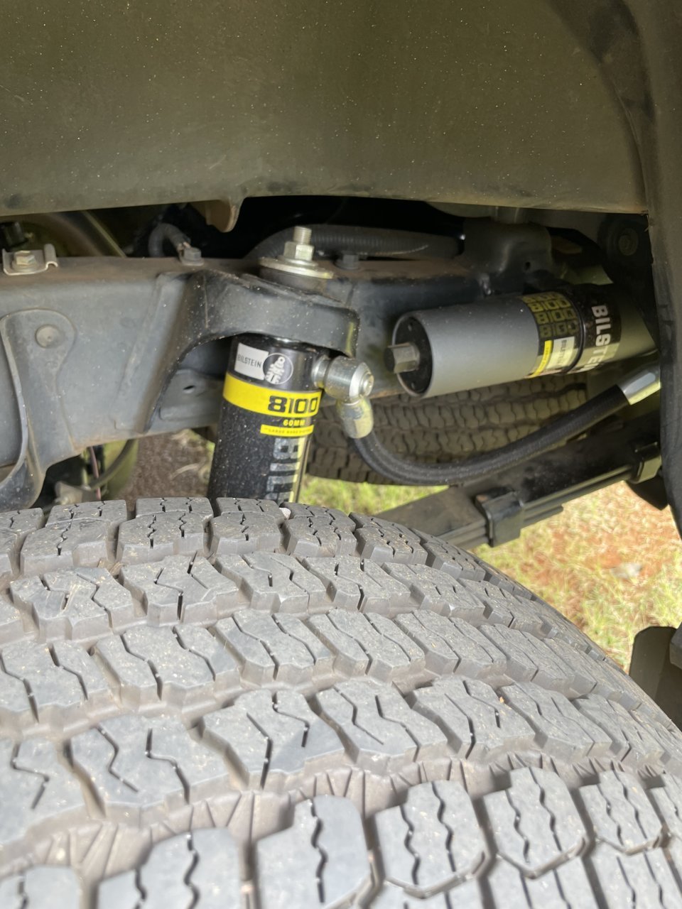

    6112’s @ 8/6 and 8100’s installed for about 500 miles now. Big thank you to Hotshot Off-road for the help and sell.

    Dang I just saw this! Looks awesome, and even I'm jelly of those 8100s out back! Appreciate the support for sure!

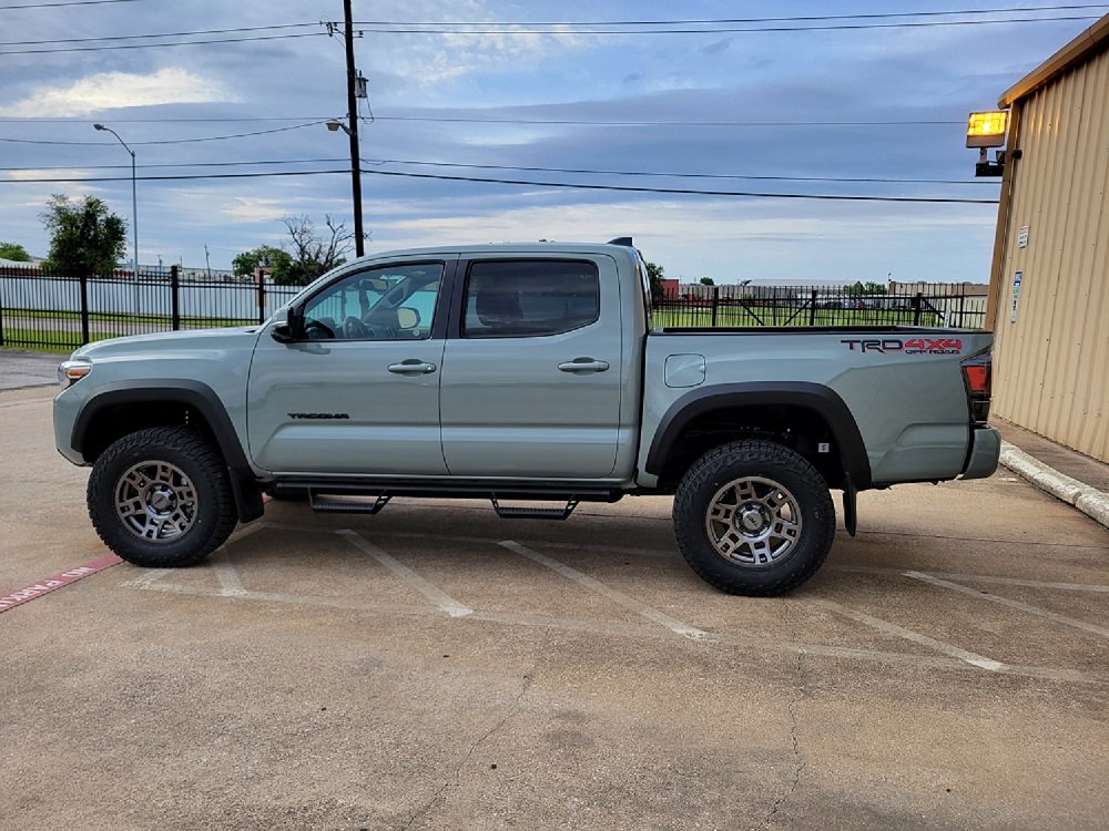

    Looks good! I have blocks and u-bolt flip kit ready to go in this weekend (fingers crossed).
