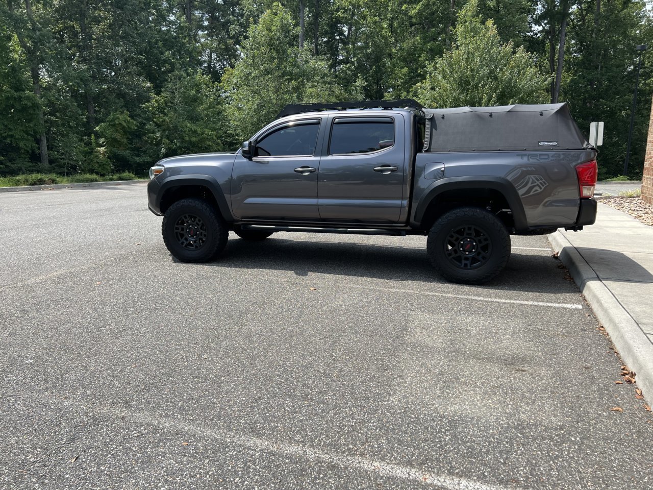

    Figured i'd finally throw a picture up as another data point for anyone looking in the future. 6112-clips 9/7-650# springs, 5160-icon rxt option 2. Can't recommend the folks at Hotshot enough!taco.jpg

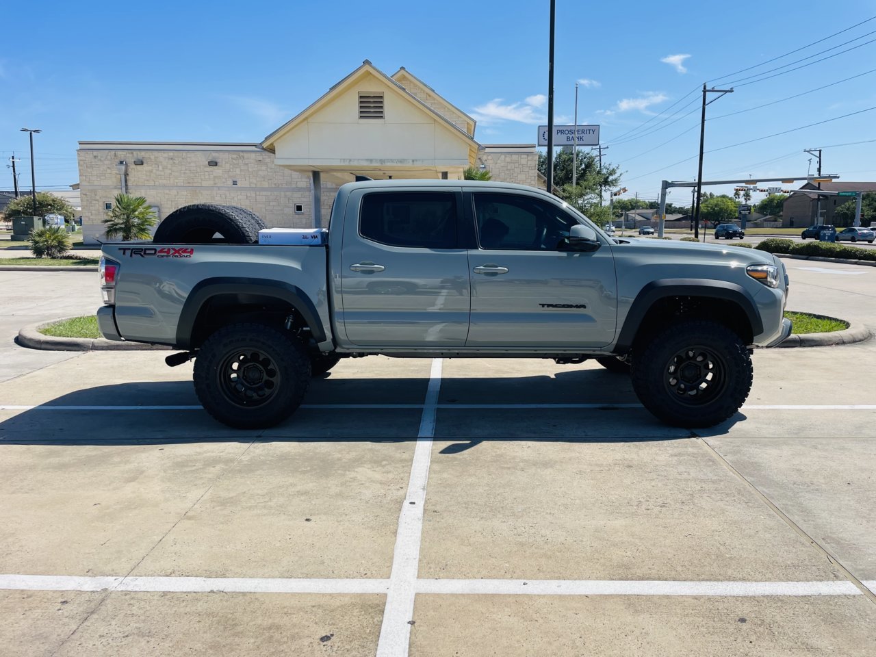

    This looks great! What setting are you on? AAl in the rear? Tire size? Thanks!

    Thanks! 11 and 10 clip
    (To help w/ the taco lean) on the 6112’s and icon RXT on the stage 2.

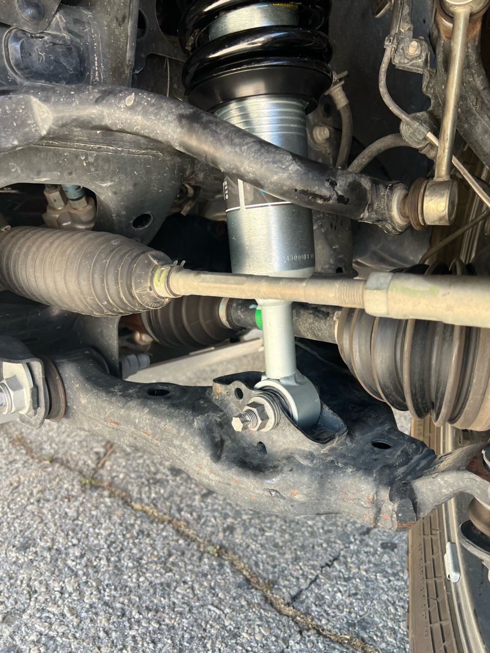

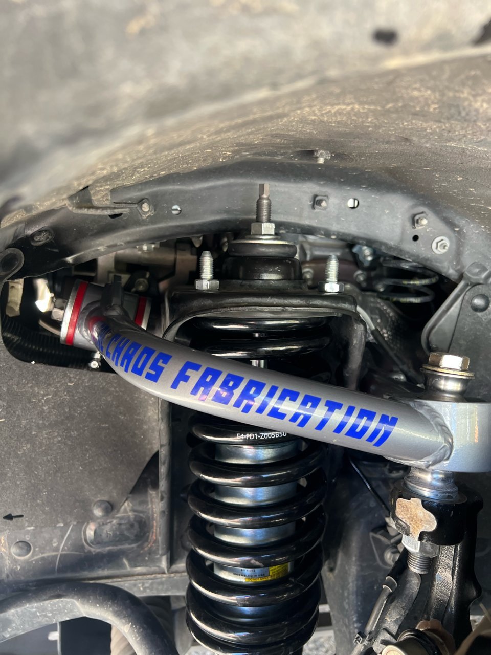

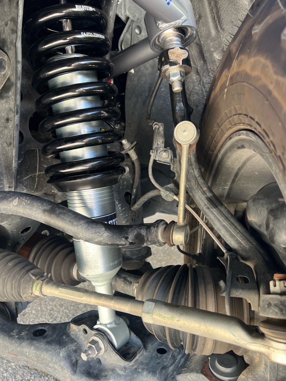

    Hello all, I'm a lurker/suspension install noob and I've come across an issue and I'm dumbfounded.
    I followed this video by total chaos and did not mess with the LCAs.
    https://www.youtube.com/watch?v=bbsTJgb6S_c&t=37s
    ISSUE:
    Installed the front shocks and UCAs. Tightened not torqued all the bolts from the swaybar, spindle, lower shock, top hat bolts, UCA uni-ball and UCA through bolt. I put the tires back on, lowered the frame, and saw that I was still getting the stock height I started at. Any ideas as to what the issue is? I tried disassembling and reassembling and everything looks o.k.
    DRIVER SIDE VIEW, Wheel cocked to the left
    Front
    -total chaos UCA
    -Bilstein 6112
    -Circlips set 6 driver / 5 passenger
    -600 spring rate
    REAR
    -Bilstein 5160
    -Deaver stage 1 u402
    I did not do the needle bearing swap, no diff drop, no carrier bearing drop, no shims in the rear, it is all stock except the front shocks, upper control arms, rear leaf springs, and rear shocks.
    Rear is fine, deavers installed and 5160's are a-o.k!
    Should the sway bar be removed? relocated?
    TIA!

    Looks like you have the new version 6112’s They have more clip settings. To get 2” of lift you need to set those at 11/9 I believe.
    See picture below

    this is unfortunate. Ordered them preassembled too:annoyed:
    little sticker says 24-309981 = 11 circlip version
    Thanks man, back to the drawing board.

    Google how to use the LCA compression to disassemble/reassemble the coilover. If you can install it preassembled you can use this method to change the circlip setting. It’s easy.
