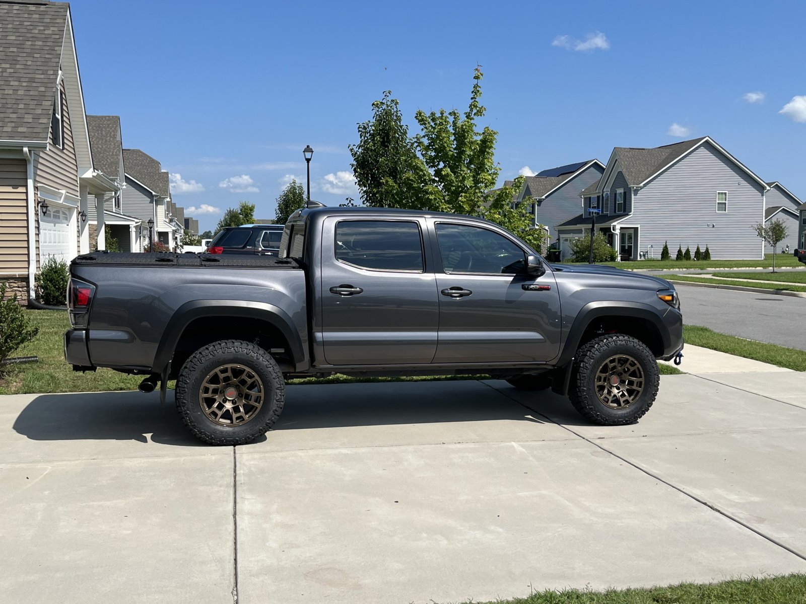

    Mikro
    Mikro Well-Known Member
    Oct 11, 2019
    #307708
    170
    2020 MGM TRD Pro
    I’m on 10/8 with a 1/4” spacer on top. No issues.
    71tattooguy likes this.
  14. Nov 14, 2023 at 7:40 AM
    #6594
    Foster1
    Foster1 Well-Known Member
    Oct 1, 2019
    #306837
    669
    California
    2023 SR V6 4x4
    Have any pictures of your truck?

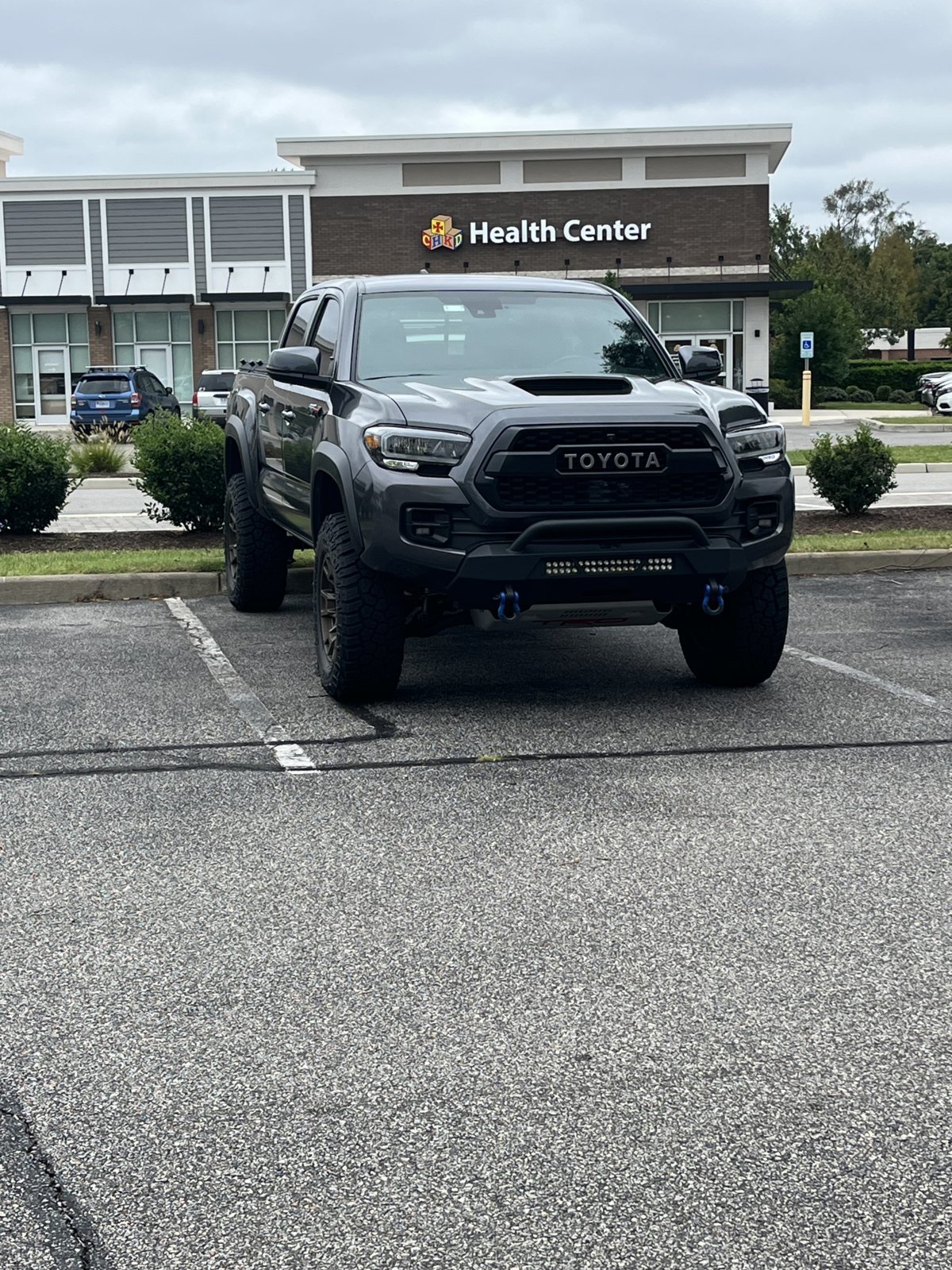

  15. Nov 14, 2023 at 8:24 AM
    #6595
    Mikro
    Oct 11, 2019
    #307708
    170
    2020 MGM TRD Pro
    Here you go. Not the best but it’s the only pics I have right now.
  16. Nov 14, 2023 at 9:08 AM
    #6596
    71tattooguy
    71tattooguy Well-Known Member
    Dec 19, 2018
    #276275
    5,905
    Dino
    Petaluma , Ca (707)
    2019 DCLB TRD OFF- ROAD
    Kings 2.5” front and rears from Accutune / ICON RXT LEAF PACK black badges doors and tailgate / method 315 / 255/85/16 Yokohama G003 / magnaflow exhaust , axle dump / meso int delete kit / meso led map lights / dome lights / wheelers front super bumps / accutune Flip kit with spacer and new bumps / Cali raised fog light pods / Cali raised ditch lights / RCI FULL SKIDS / SLIDERS / RCI rear bumper / rigid backup lights / tuned on 4.88’s
    top settings 1/4” spacer no issues
