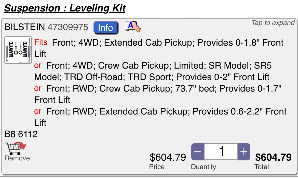

    This the part number I’d use for a 2021? Was looking at 6112/5160 kit from Shock Surplus for $1119. Anyone know where I can get the best deal for just the rears to combine with this deal? Only looking to do .5-1” lift in rear, would 5100 be good enough or worth the upgrade to do 5160?
    Rockauto has 6112/5100 has the set for just under $800 vs lowest cost set I found for 6112/5160 set I can find is $1120. Worth the upgrade for +$320??? Rareee light offroading, mainly daily highway commuter. Looking around 1.5” front & .5” ish rear lift.

    You’re probably looking at Gen 2 6112s and Gen 1 5160s for that price on SS. I’d be happy to match anything they can offer. Shoot me a message here or give me a call at Hotshot Offroad 406-936-0206 and we’d be happy to walk through all of the options with you at a good OTD price.
    You’d be amazed at how often I’m trying to convince folks with a bunch of weight over the rear axle to use available budget on the rear vs the front. They admittedly don’t look as good most of the time though!

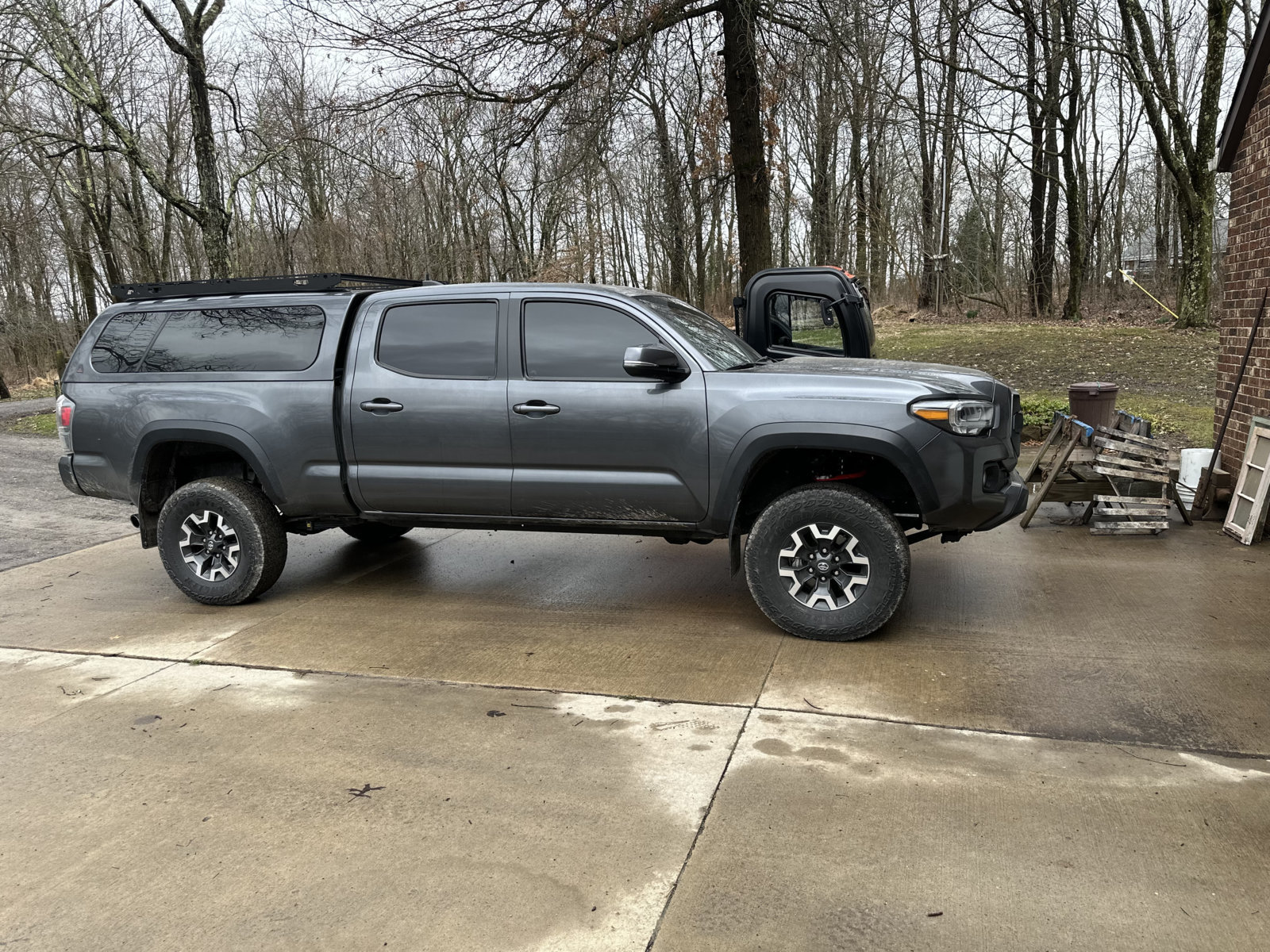

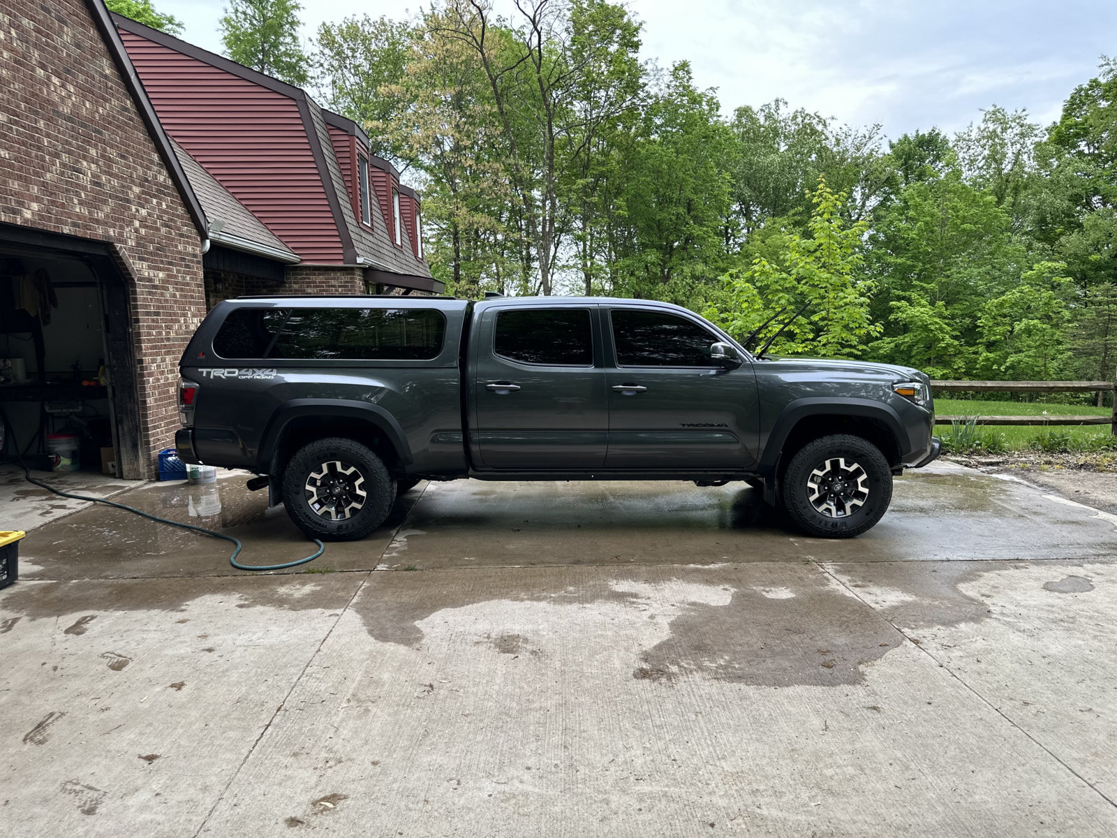

    Alright, I got the lift installed last Friday into Saturday. Everything went fairly well, the ECGS bushing was a little bit of a pain but ended up going well. I got everything on the truck that I intended except the drive shaft spacer kit, no vibs so I don't think I'll need it. The before measurements are what follows. This is after driving it around for most of the week and getting things settled in. I'll have pictures below, along with alignment specs in the pdf.
    Passenger Front - 20 3/4
    Passenger Rear - 21
    Driver Front - 20 1/2
    Driver Rear - 20 3/4
    - After
    Passenger Front - 23 5/8
    Passenger Rear - 24 3/8
    Driver Front - 23 1/2
    Driver Rear - 24 1/2
    - Overall
    Difference Front - Roughly 3 inches
    Difference Rear - Roughly 4 inches
    opihiman and -Rorschach- like this.
