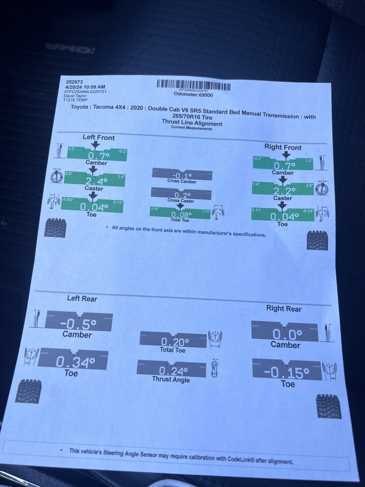

    The Caster is too low. You should increase caster to +3 to get better tracking and reduce wander.
