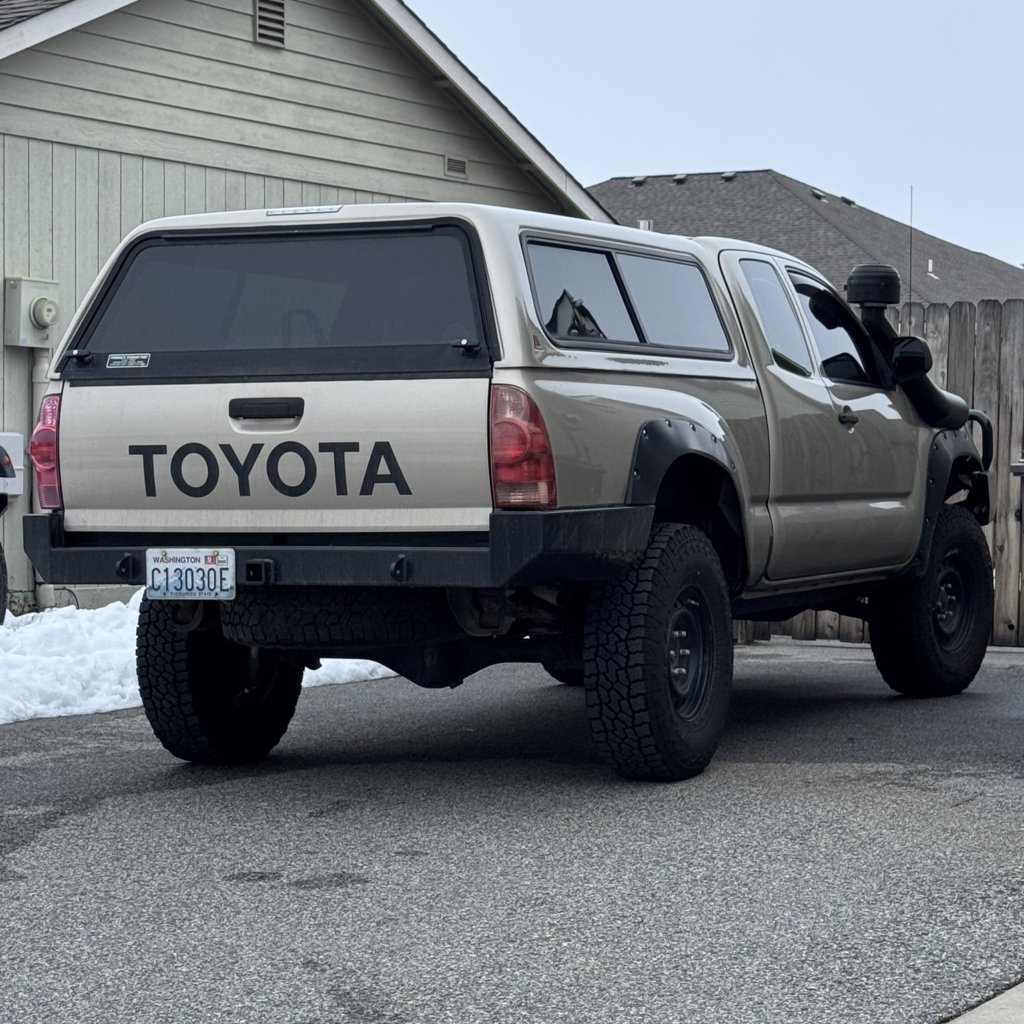

    Alrighty fellas, I need guidance and wisdom in the way of 6112’s.
    I’ve got a 2008 access cab with the 4.0, 4x4, ARB Deluxe front, Badlands 12,000lb winch in front, and 4xInnovations high clearance rear bumper without a tire swing out on the rear. My current suspension is a home brew of 5100’s all around, OME 885’s (I think, can’t quite remember which ones I got), Deaver AAL and TSB leaf pack, and SPC UCA’s.
    The 5100’s up front seem to not enjoy the extra weight of the bumper and winch, which I put on after the suspension and I am getting some pretty concerning noises up front.
    Going to order a 6112/5160 combo with the 650lb coils, and will utilize the current leaf spring setup I have now. My question is… with all the weight I’ve got up front, what “circlip” assembly should I select when I’m ordering?
    Thanks in advance!

    Not sure I can 100% answer this definitively, but I'll give my opinion. Note I have no experience with the 5100's or the OME 885 springs. I assume you have the 5100's that DO NOT have similar circlip settings like the 6112s? That is my assumption and all of your lift is from the OME 885 springs.
    From what I read doing a search, most people get between a 2" and 2.5" lift with those springs. So I would ask is that what you got? Your truck looks pretty level in that pic so I assume you want to replicate it?
    I am not sure you will able to, to be honest. Reading the 6112 circlip specs, the most you can get is 1.8" using settings 10/8 (the specs say not to use 11/9 on an access cab - at least the doc I have says that). In theory, the 650# springs give you another 0.5" if my memory is correct at STOCK weight. You have extra weight as noted so the intent of the 650# springs for you is to get the original advertise lift with the 10/8 settings. They aren't going to give you more.
    For full disclosure and what I am basing my input on, I have a 2021 DCLB TRD Offroad. I got 1.5" up front with the setup below with not much added weight up-front. Per Billsteing specs I should have gotten nearly 2" but I didn't. My mechanic and I question if something was wrong with where the circlip notches were cut as I got them when they first went to that from the previous 5 (I think) settings.
    • 6112s at 9/7
    • 650# springs
    • Very little weight added up front - Aluminum skid plate and cat shield, Rock sliders that should be pretty evenly distributed front and back
    • 1.5" lift up front was my experience
    You could also call Bilstein and get their input. Originally with the 600# springs I only got 1". I called them, they were stupified as well and said I should have gotten closer to 1.4". Rather than trying to explain it I just got the 650# springs.
    And I know you arent't asking, but the Icon RXT leaf pack is an awesome upgrade. I did option 2 and got 2.5" in the back and it has not sagged at all in nearly 2.5 years with a shell on the back. Loaded up for camping I still have a small amount of rake so I'd say it sags maybe 0.5" down to 2".
