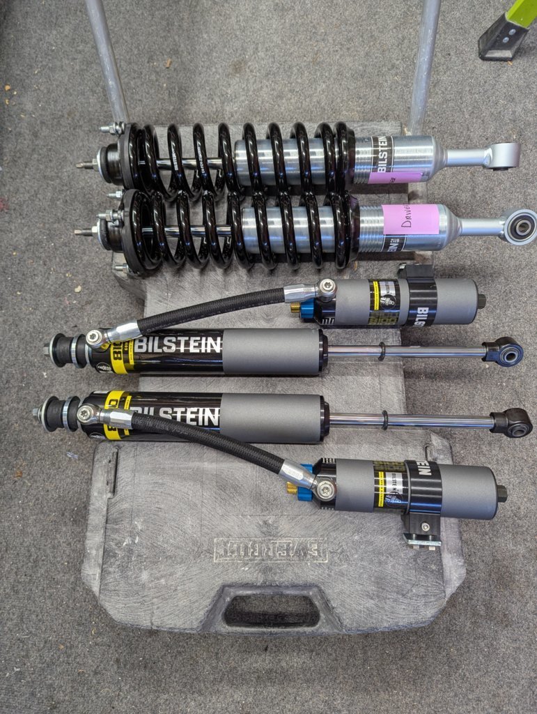

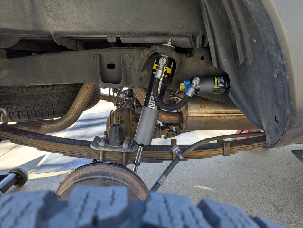

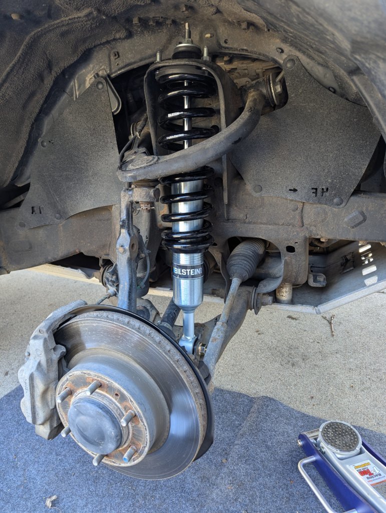

    I just (9 days ago) installed 6112/8100 dsa on my truck because my Dobinson twin tube shocks just weren't cutting it, they were nice but not nice enough to go fast.
    So I figured this time I'll do what I should have done the first time and go 2.5 but $4000 for the full 8000 setup was a bit much so I went with the much cheaper 6112/8100 dsa.
    Initial impressions on local low maintenance roads and washboard gravel are they are so damn good.
    This summer I can't wait for my 2 trips where I will get to test them on logging roads in the north shore area and on the beach at Padre Island.
