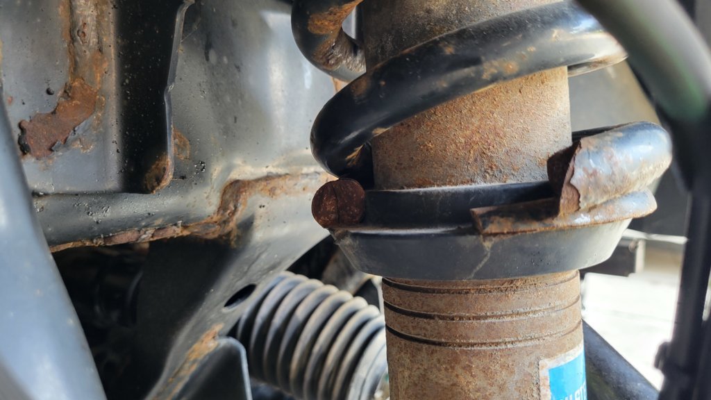

    Is there anything that can be done with old 6112s, other than toss them?
    It looks like by the time Bilstein rebuilds them, you have spent almost as much as buying a new set.
  3. May 19, 2025 at 8:58 AM
    #6743
    memario1214
    memario1214 Hotshot Offroad Moderator Vendor
    Oct 1, 2009
    #23628
    20,164
    Colton
    Missoula, MT
    SOLD - 05 Dub Cab TRD Sport 4x4, CURRENT - '21 Tundra MGM Limited
    Bin 'em. I dabbled in trying to rebuild them as well. It's not worth it!

    Thank you, but I am 99% sure I need to replace the shock as well. They have been on since around new, almost 9 years ago.

    I meant to say that too. You have the last Gen 6112s so depending on how much you drive there’s a solid chance they’re smoked.

    I have 100k, bought at around 2016, maybe 17. Truck had 69 miles when I bought it.. Can't remember exactly when... they are smocked, for sure

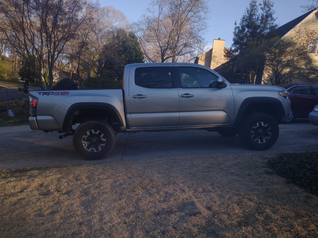

    Hate to say I didn't measure the before and after. I did measure the after eventually. I'll go take a measurement so I don't make an ass of myself again. I got a deaver leaf pack (expedition? And first option) and it's settled to where I still have a slight rake. Not as much as I first had but I'm still happy as I wanted to keep a rake as well and the bed doesn't sag with any of the loads or trailers I put on it.

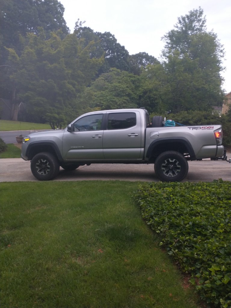

    FD center of wheel straight vertical to fender guard 22 and 3/4". RD 23 1/4" to bottom most of fender guard.
    Both some what accurate but also rough approximations.
    It settled a bit more in the rear, but without looking at ride hight specifics I can still tell it's raked. Though not as much as right after install, which I thought was super happy with as it was exactly what I envisioned. First pic where it's at now. Second after install.
    JDKred likes this.
