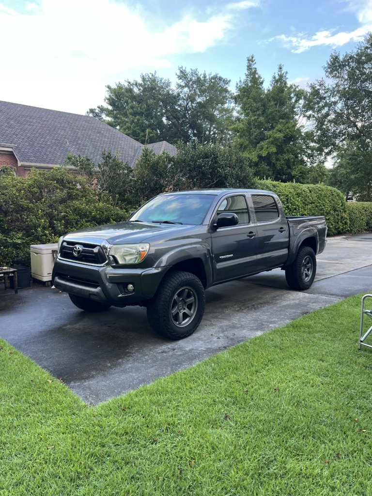

    Just an update. Ended up setting the 6112s at 7/5 on my 2nd gen 4x4 double cab with no extra weight and ended up at around 22-22.25in hub to fender after a few days of settling. This is about .75in higher than I was sitting with a 3rd gen TRD OR takeoff suspension and right around what I was expecting. Super happy with how it rides!IMG_0258.jpg
