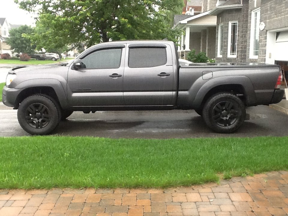

    6112's (set on 5th notch) with 5160's on her rear
    Upgraded to Toyo Open Country 275/65/18
    1"block in rear
    This had to be done as my freakin front mudflaps would scrap going over a speed bump, couldn't take people turning every time to see what the hell that sound was. Ended up removing mudflaps and sidestep bar. Then plastidipped all Chrome.image.jpg
    Lovin the setup!

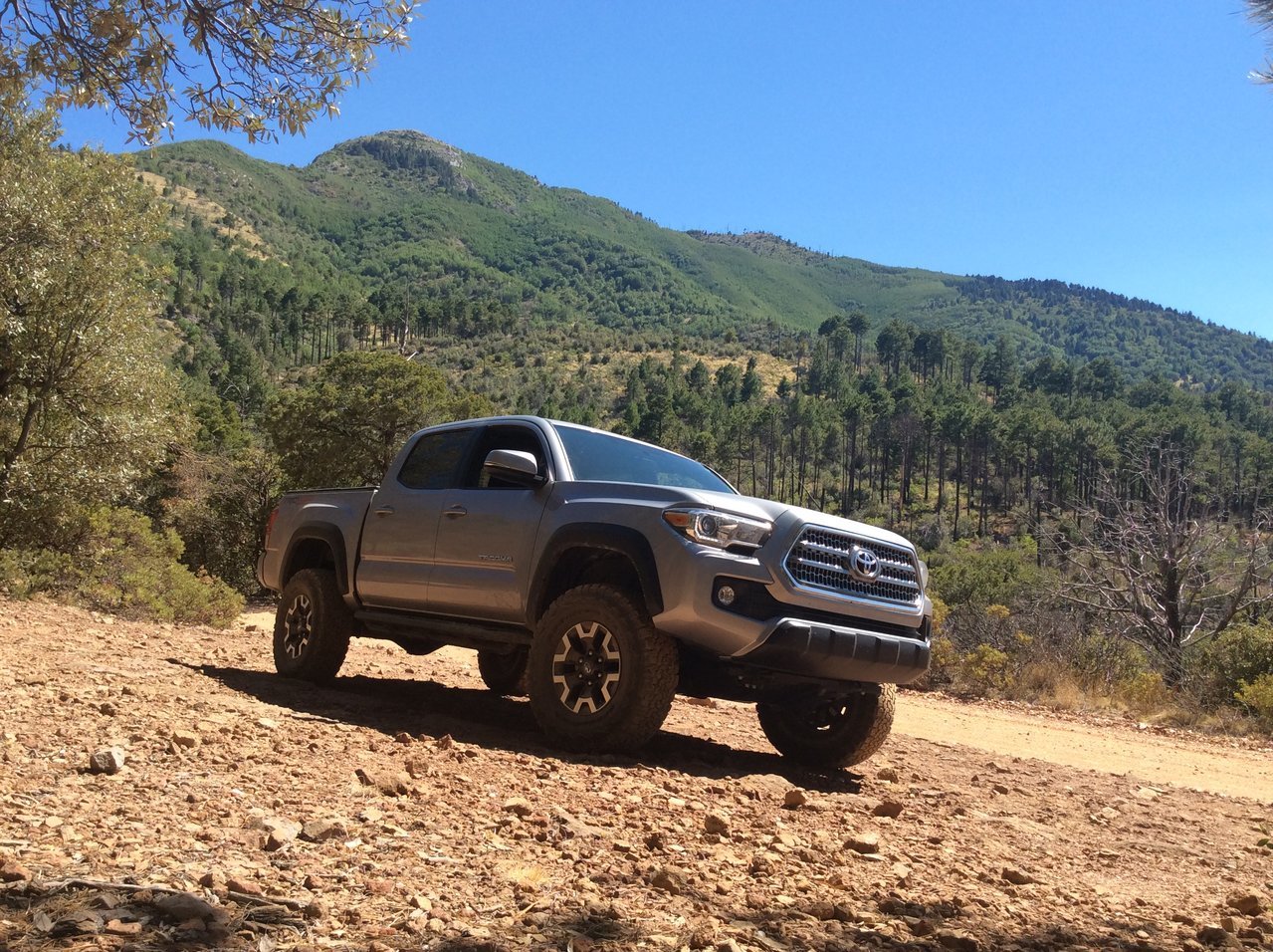

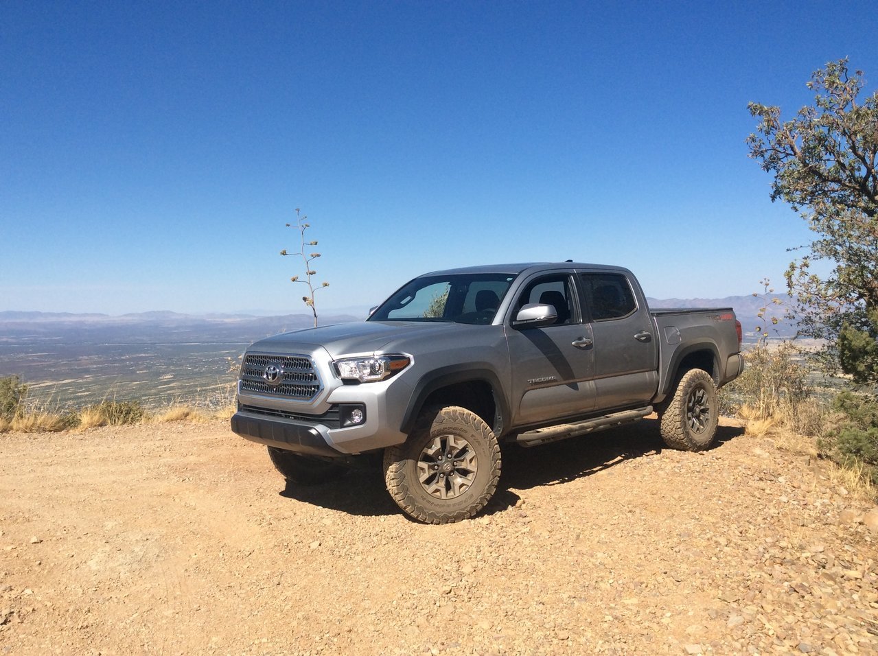

    Bilstein 6112 and 5160 BFG 265/75/16 KO2 ECGS
    This was my first real test on the trail with my 6112/5160 setup. Could not be more pleased!!! Got it up to 60mph on some strait aways and felt in total control The Whole time. The faster I went the better the ride!!
