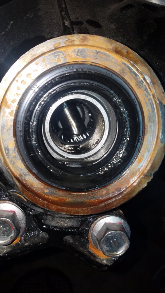

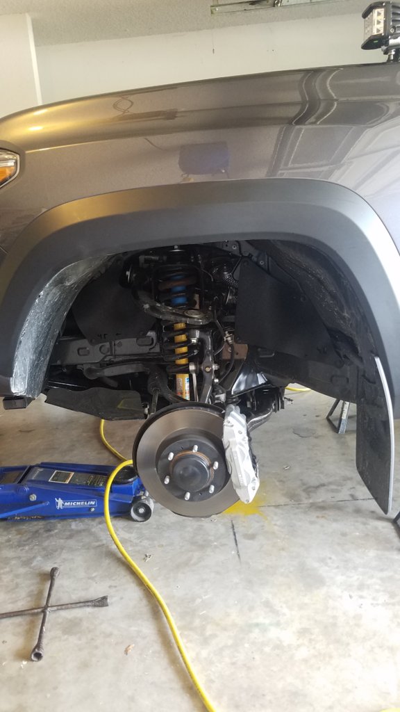

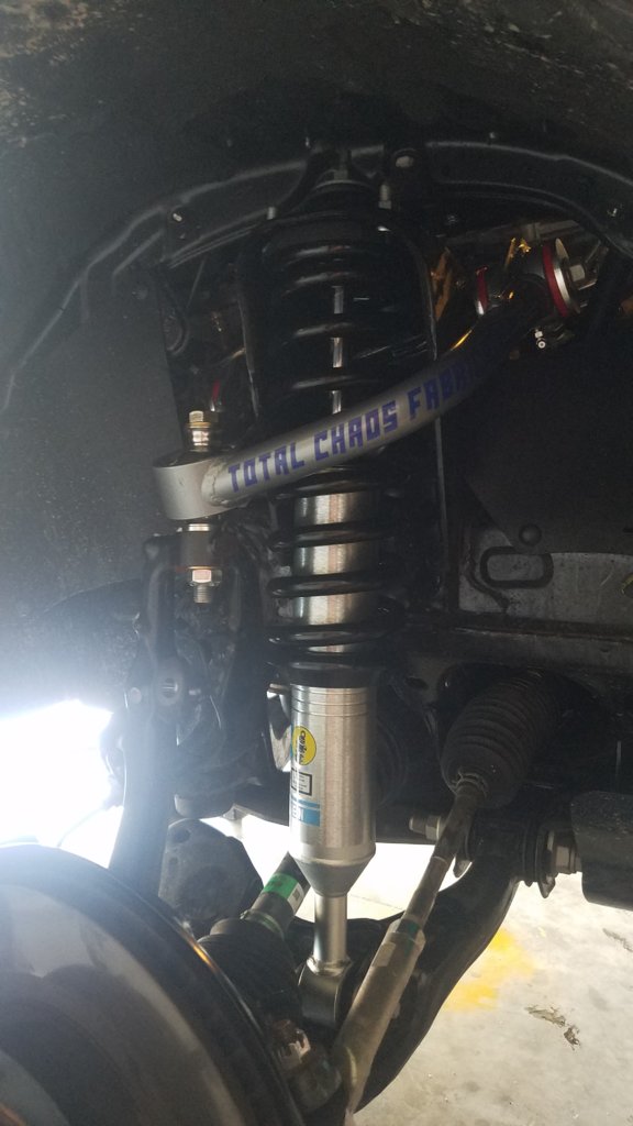

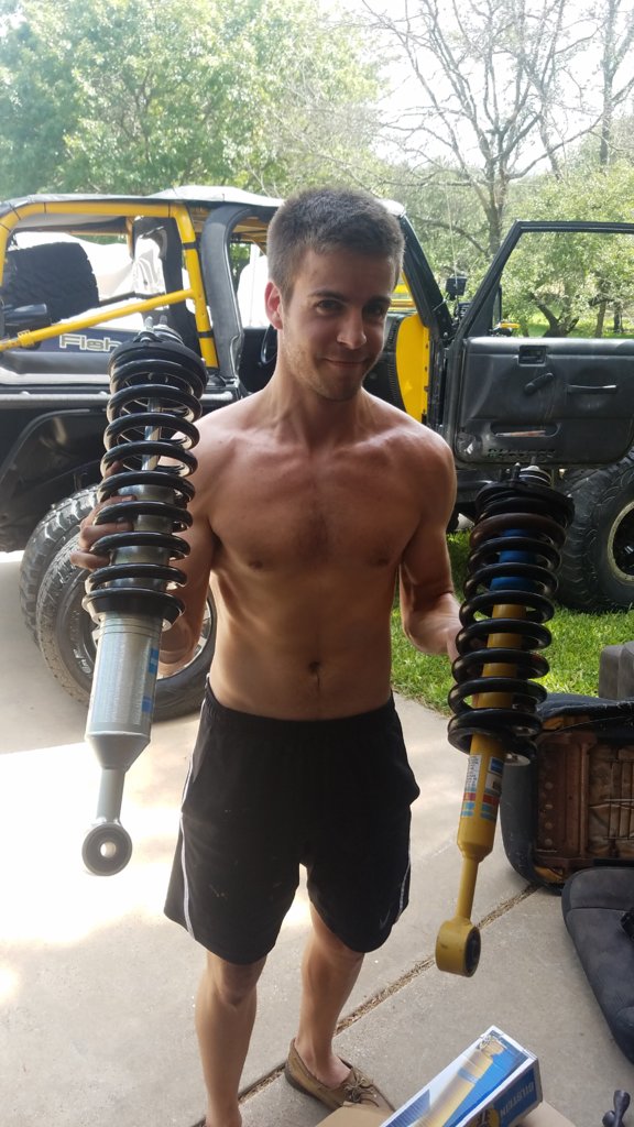

    Before/after: Gained 2.00" lift in the front and 1.875" lift in the back.
    6112's are at the 4/5 setting, 5160's and dakars in the back. This setup soaks up large bumps like a pro. Smaller bumps that would compress the shocks quickly are a bit more pronounced in the feel, but potholes, speed bumps, and large rocks are absorbed very well by the suspension. This setup is super smooth on dirt in 4WD, I would recommend it. Not valved for desert running, but still smoother than the stock TRD OR suspension on the highway and on 4WD roads. Overall an awesome mod without completely breaking the bank.

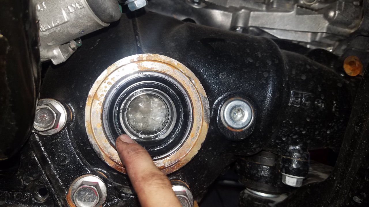

    Sorry I don't have many pics of the rear suspension installed, it was after dark. Overall it took us about 5 hours for the install, but we were taking our sweet time and trying not to die in the heat :bananadead:
    Right Before the install:
    Right before ripping out the OEM suspension
    Size comparison between new and old
    Removing driver's side needle bearing
    ECGS bearing installed
    Passenger side front installed
    Post lift

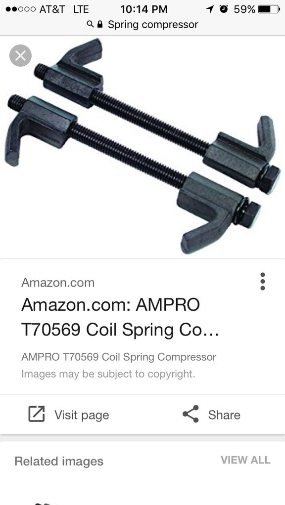

    What did everyone use to decompress/compress their spring on the B6112s? I want to adjust mine up a notch or two. Went to Advance Auto and rented a "strut spring compressor" and it wouldn't fit to clamp down the springs. Tried every which way but couldn't make it work.
    What's everyone using???

    I have never worked on the 6112, but the way the lower springs see sits on top of the circlip used to adjust the height, the only feasible way would be to remove the coilover and use a regular automotive spring compressor. The only way to do it on the truck is maybe find one that is very thin but I still do not know if you have enough room in the wheel well to compress the spring enough

    Those did not work for me....I had to bring them to a shop where they had a wall mounted spring compressor. I have Eibach 650# springs FWIW.
