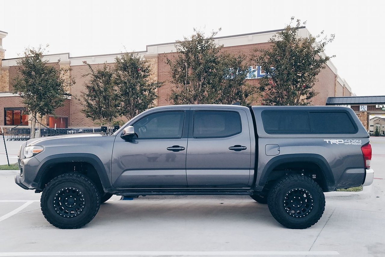

    I have my 6112 (2nd gen) on 5th (top) notch on my 3rd gen. Also with a camper shell constant with an Icon AAL on stock pack. Even without the shell, it felt like the rake was too much and I got a good 2.5" front lift out of them. The camper shell dropped it about 3/8th of an inch and the rake is much nicer to me now.
    20616924_10156979268022925_4227731135800_e38cc970a4198bc6ff7ab657b805d34d0bcc5698.jpg

  4. Aug 9, 2017 at 12:06 PM
    #744
    PreTaco170
    PreTaco170 Well-Known Member
    Nov 2, 2016
    #201379
    193
    Russ
    San Diego County
    2009 PreRunner DCSB TRD OR
    Bilstein 6112/5160, Dakars, JBA UCAs, FN f(x) Pro 17x8, 285/70R17(C) BFG KO2, Wheeler's Off-Road Bumpstops/U-bolt flip kit, CMC, Marlin Crawler HD LCA Frame Brace Kit, TRD CAI, Flowmaster exhaust, Alpine iLX-407 CarPlay receiver
    Tire size?
  5. Aug 9, 2017 at 12:07 PM
    #745
    c4lvinnn
    c4lvinnn Well-Known Member
    Sep 30, 2016
    #198603
    2,128
    '17 TRD Off Road DCSB
    Too small lol.
    265/75/16
    PreTaco170[QUOTED] likes this.
