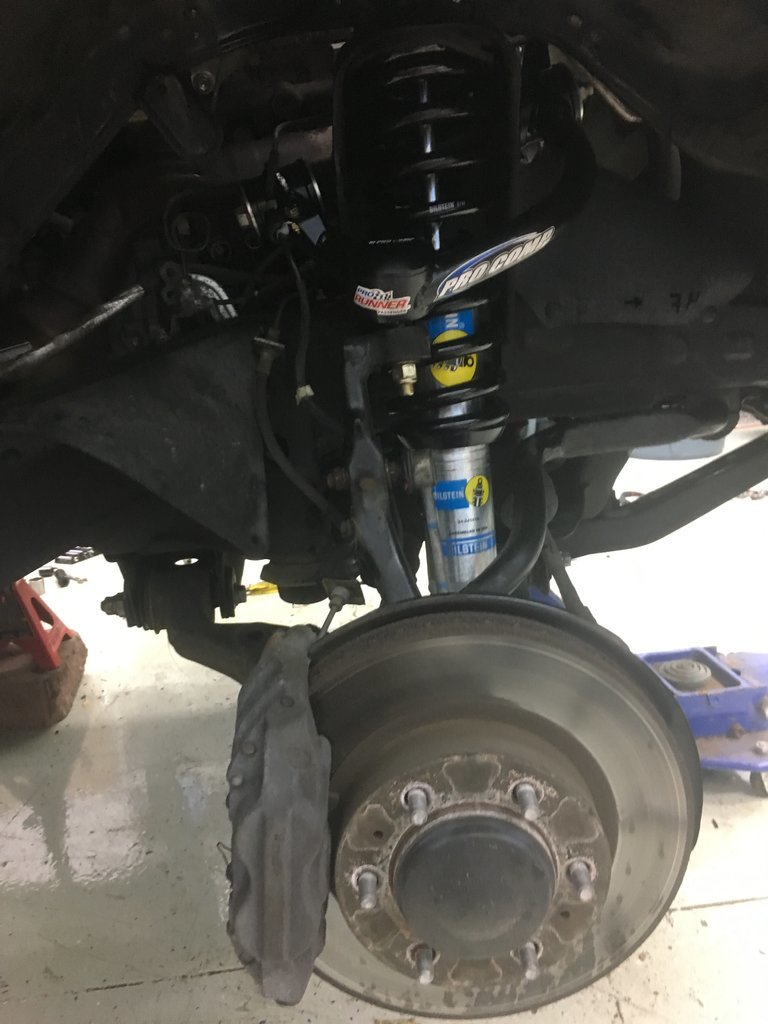

    another successful 6112/5160 install. +2.5" front, +2" rear.
    • 6112 4th clip (0.25" spacer on drivers)
    • pro comp UCA (uniball)
    • wheelers 3 leaf + OL
    • 5160 rear shocks
    • 265/70/17 BFGs

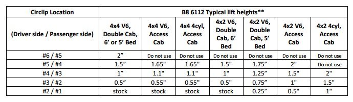

    Ya exactly...#5 on the drivers side and #4 on passenger. These are on the 3rd gen 6112s so I'm not sure if that will equate to the same as on the 2nd gen 6112s.
    As for the lean it's pretty much bang on, 22" on the drivers side and 22 1/8" passenger side. As measured from center of hub to bottom of the fender. These were taken after only 75km so I assume there will be some settling after a while

    You bet. No spacer just the different clip positions

    4/5 in the front, this will lift a 2nd gen higher than a 3rd gen though

    i have driver side on the top position and passenger 1 less for the lean. 285 75 16 with VTX VIPERS and a 1" block in the rear until i order new leaf kit.
